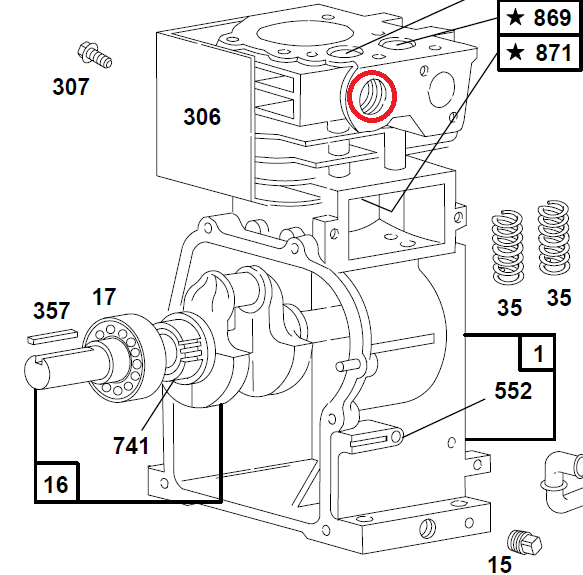

Look (once again) at this picture of the cylinder and crankcase:
The red circle shows that one port - the one closer to the crankcase cover - has thread in it, the other one does not. Briggs taps a thread in the exhaust port of most of their small engines, and screws the muffler directly into the port, because this is a cheap, reliable way to mount the muffler. In other words, the exhaust valve tappet is the one closer to the open side of the crankcase, where the timing gears are, and where the crankcase cover mounts.
Note that neither tappet is closer to the piston than the other, they are both equidistant from it, because they are lined up along the camshaft, which runs parallel to the crankshaft. The piston is almost exactly above the center of the crankcase, when measured along the crankshaft.

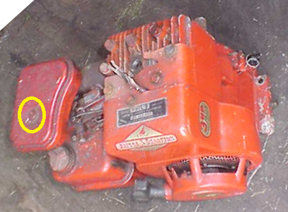

The picture shows an 80202 about the same vintage as yours, but they are not all the same, so first, post a picture of your air filter, then remove it from the engine. For the one in the picture, you just unscrew the large screw in the center of the top of the air filter (circled in yellow), then you can lift off the entire air filter from the carburetor. If the filter is substantially different (e.g. a later one with a paper filter) you may have to remove the top cover to access the mounting screws. Post a picture of the carburetor (immediately beneath the air filter housing) when you have done this, so we can discuss the following steps.

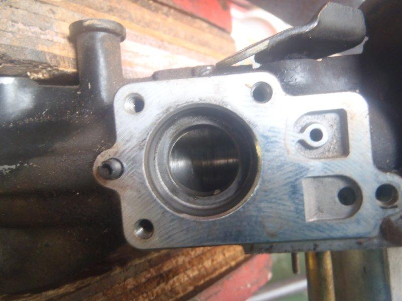

OK, Mounting bolts are secure so we proceed to problems 2 or 4. [Linked Image]

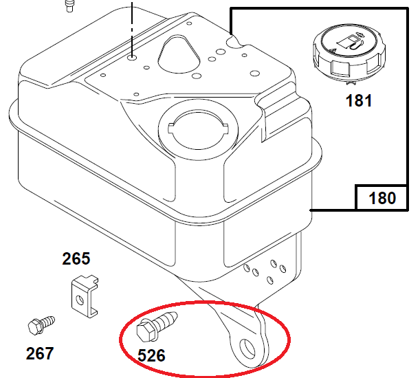

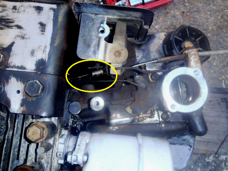

Thanks DJ, looks like you have a paper air filter. Now, the next step is to remove the carburetor and fuel tank from the engine. On many B&S engines the fuel tank is just suspended from the underside of the carburetor and supported by the carburetor's two mounting bolts, but deep tanks like yours will probably have an additional support screw. I identified what seems like the right screw previously in this thread:
You need to remove that screw and the two carburetor mounting bolts, so you can simply take the carburetor and fuel tank off the engine. Be very careful of the governor spring, circled in yellow below:
That spring is delicate, and if it is damaged it will have to be replaced with exactly the right spring.
The speed control Bowden cable will still be attached, but that should not be a problem at present. Please remove the carburetor and tank, put them on a suitable support that holds them steady while you work on them, and post a picture or two. When you have that done, we get to the important parts of the job.

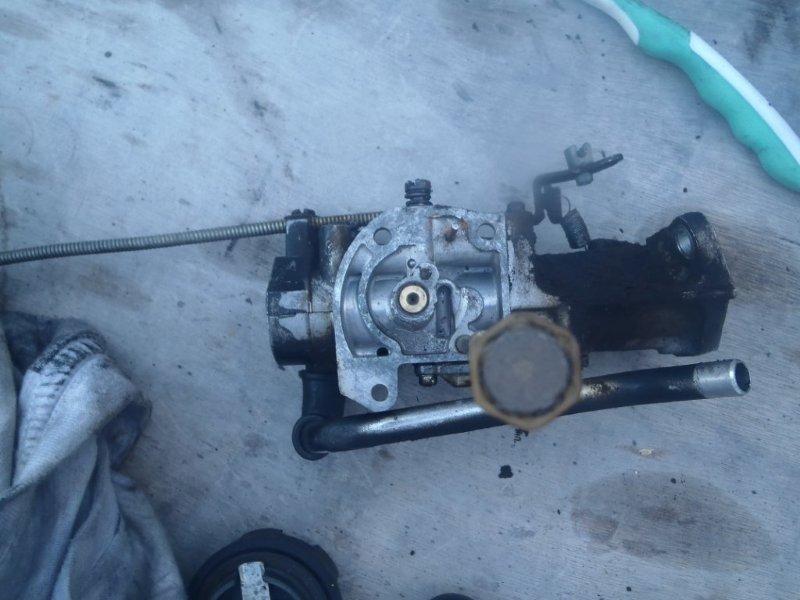

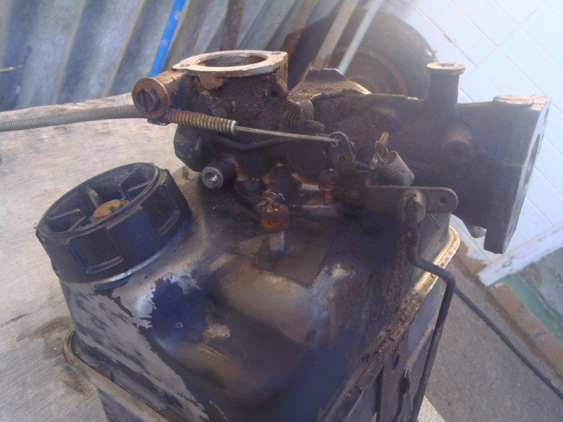

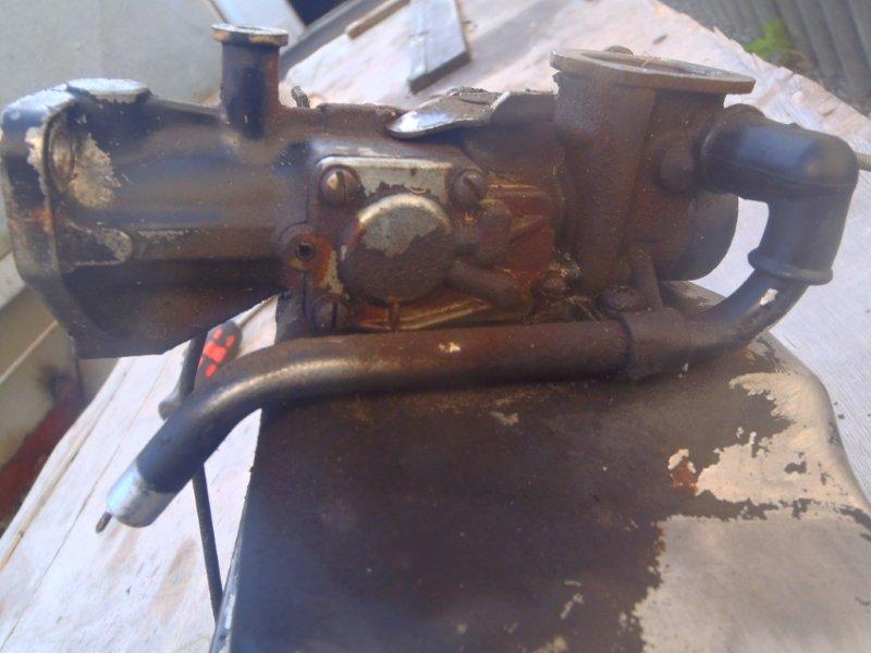

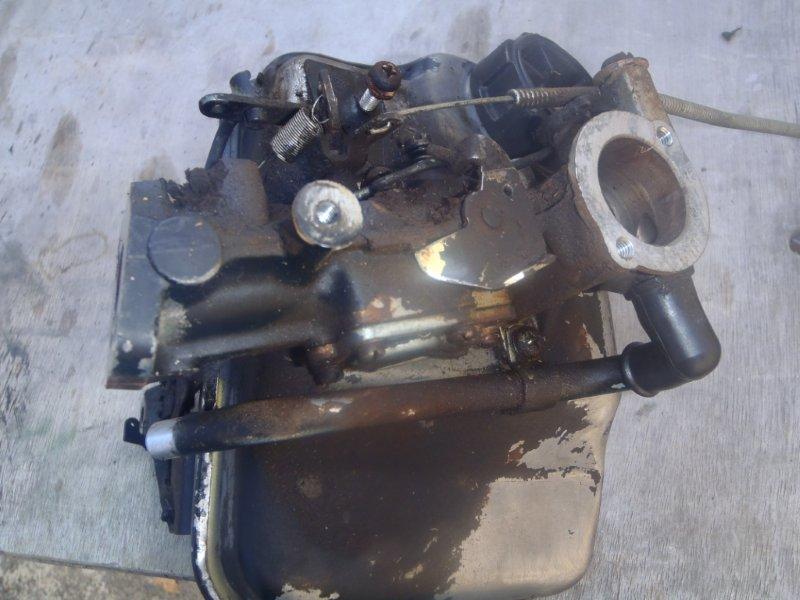

Some more pics [Linked Image]
Thanks Stuart, we have to remember now to plug that aluminium breather tube back in at the lower end (I usually disconnect them at the top, so that is where I usually look when I'm putting them back together).
All is good so far. I see you've removed the control panel - I'll still post the Briggs instructions for doing that, so this will be a complete archive:
The next job is to separate the carburetor from the fuel tank. It isn't nearly as tricky with horizontal crankshaft Pulsa-Jets as it is with vertical crankshaft ones, but you still have to be careful of the fuel pick-up tube, circled in red in the disassembly instructions:
On the bottom of that tube is a flared-out section, which you have to thread through the hole in the top of the fuel tank without damaging it. Do not try to remove the tube from the carburetor. Note you have already taken care of item 2 of the instructions. Don't discard the gasket unless it is damaged.

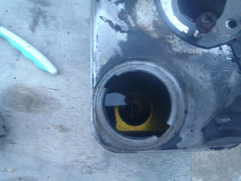

Now we get to the serious part. We need a picture of the flared-out section of the fuel pick-up tube, showing the fine mesh on the bottom of it. This will tell us whether Problem 2 (see earlier post) applies. We also need a picture down into the fuel tank, showing whether it is full of grunge or sparkling clean. Let's discuss the results of all that before taking anything else to pieces, especially the fuel pick-up tube.

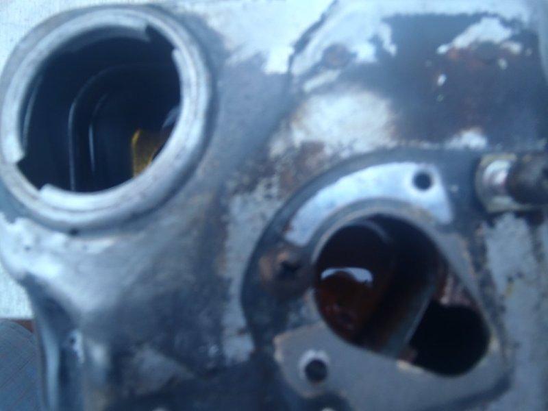

The bottom of the mesh was coated in a lot of 'lint' like material which I have now cleaned off. The other small metal tube/pipe [Linked Image]
with the brass end had a lot of rusty colored grunge on it which I have also removed. Looking into the fuel tank I can clearly see the bottom and it looks free of material. The well where the brass ended tube sits in, has the rusty colored gunge in that was on the end if the tube
The burning question is whether either the lint-covered mesh screen at the bottom of the long tube (the fuel intake screen), or the small brass item at the bottom of the shorter tube (the main jet) was actually blocked rather than obstructed. If so, that will have been the cause of the problem. If they were merely obstructed, it will be necessary to clean them both properly then go on to Problem 4. Both because we don't know the answer to that, and for practice and thoroughness now that we've gone this far, I suggest we should go the rest of the way anyway. Of course the first thing you need to do is to clean out the little well in the top of the fuel tank below the main jet, if you haven't already done so. Then, turning to the carburetor itself, step 1 is to clean both the mesh screen and the main jet with carburetor cleaner, which comes from your local auto shop in a spray can and may be called carb cleaner, throttle body cleaner, or some similar name - the counter jockey can point you to the right stuff. Wear safety glasses when you use it. In the case of the mesh screen, you might try squirting it across the screen first in the hope of blasting some of the remaining crud off and out rather than through and in. You will later need to squirt some directly through the screen, but it's best to do that during our pursuit of Problem 4, because of where the displaced crud has to go. In the case of the main jet, just squirt cleaner through the tiny hole in the center. After doing that, push a small strand of copper wire through the hole to verify that it is clear, then give it a short second squirt with the carb cleaner. I recommend that you do not dismantle the carburetor further except in pursuit of Problem 4, which I will now get into.

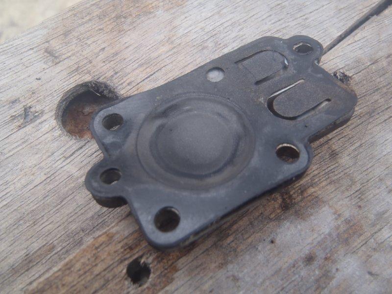

The objective when you open the pump chamber is to take pictures of the components, inspect them, and clean the compartment and the components with carburetor cleaner. You will also need to squirt carb cleaner through the screen on the end of the long tube (see Problem 2 above) in the hope that it will blast straight out into the pump cavity, carrying the crud with it. (Remember about wearing the safety glasses.)
Aside from getting the crud out, we want to know if the pump diaphragm, component 3 in the diagram, will sit flat with its little flaps laying flat on the ports they have to seal (one port is on the carburetor body, the other on the cover). We want to know whether the flaps were sealing before the cleaning operation, and also after it. There are two main issues in whether the pump works or not: whether the flaps seal, and whether the little cup, or piston (Item 2 in the diagram), is stuck in the bore.

Photos of disassembled pump chamber before cleaning. No apparent restriction in piston movement. [Linked Image]
