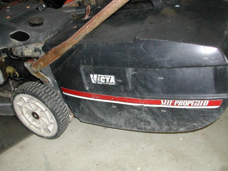

G'day, Do I have something special here? ![[Linked Image]](https://www.outdoorking-forum.com.au/forum/uploads/usergals/2012/11/full-4730-8700-zz_056.jpg) ![[Linked Image]](https://www.outdoorking-forum.com.au/forum/uploads/usergals/2012/11/full-4730-8701-zz_057.jpg) ![[Linked Image]](https://www.outdoorking-forum.com.au/forum/uploads/usergals/2012/11/full-4730-8702-zz_058.jpg)

nice id like one of them looks in great nick as well..Are you going to restore it?
Not fantastically rare, I have have 3 of its sucsessor with the series 80 here, a nice solid machine though, unfortunately the alloy bases dont last very well out here in the west...
Posts: 4,291 Likes: 4
Well from what I've seen there not that common but not that rare either.

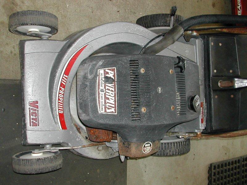

I am giving this some attention today, it has been sitting there waiting patiently. Biggest drama is jeft wheel spins freely, right wheel is hard to turn. Looks like gear box can come apart for servicing. Base is good piston and rings look good. Would like to get self propel working again, if not turn it into a push mower. What do you reckon? ![[Linked Image]](https://www.outdoorking-forum.com.au/forum/uploads/usergals/2012/12/full-4730-9309-zzz_017.jpg) ![[Linked Image]](https://www.outdoorking-forum.com.au/forum/uploads/usergals/2012/12/full-4730-9310-zzz_019.jpg) ![[Linked Image]](https://www.outdoorking-forum.com.au/forum/uploads/usergals/2012/12/full-4730-9311-zzz_016.jpg)

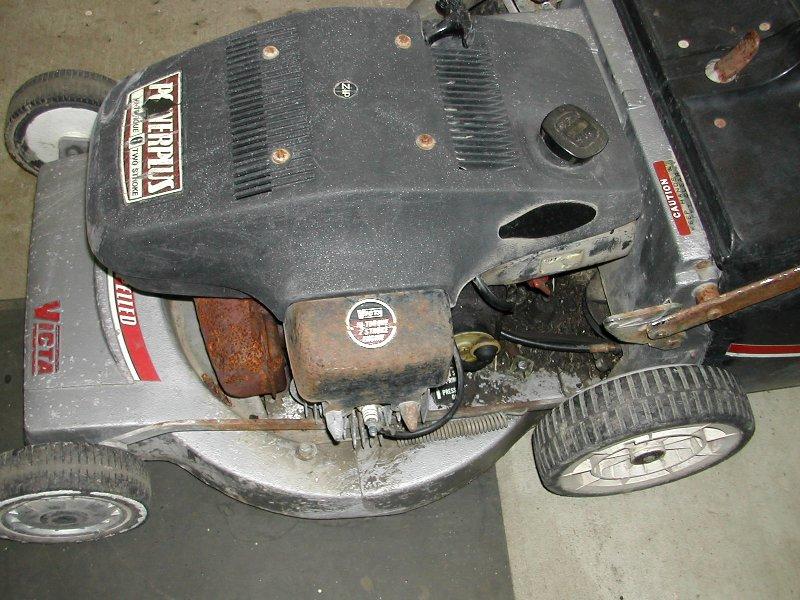

Thanks to Blumbly I have started taking notice of stampings on the engine. From what I can tell engine was made in 1978. I noticed the HC above the spark plug, so assume it is a high compression head. Looks to have some components missing from belt drive area. ![[Linked Image]](https://www.outdoorking-forum.com.au/forum/uploads/usergals/2012/12/full-4730-9312-zzz_020.jpg) ![[Linked Image]](https://www.outdoorking-forum.com.au/forum/uploads/usergals/2012/12/full-4730-9313-zzz_021.jpg) ![[Linked Image]](https://www.outdoorking-forum.com.au/forum/uploads/usergals/2012/12/full-4730-9314-zzz_022.jpg)

Have the gear box out and when I turn the pulley by hand, both wheel cogs are turning as expected, gear box is operating smoothly. Drive wheels look like replacements. Under the grime doesnt look like it has done that much for its age. I will not pull the gearbox apart yet. I will clean it all up & put it back together & see how it goes. ![[Linked Image]](https://www.outdoorking-forum.com.au/forum/uploads/usergals/2012/12/full-4730-9316-zzz.jpg)

hey mark , it would appear that your missing part is the idol pully that puts tension on the belt.
Yes good eyes there tomo4192 your right I didn't notice that.Yes there is some bits missing.It should look a bit like this. ![[Linked Image]](https://www.outdoorking-forum.com.au/forum/uploads/usergals/2012/12/full-5048-9320-102_0218.jpg) ![[Linked Image]](https://www.outdoorking-forum.com.au/forum/uploads/usergals/2012/12/full-5048-9321-102_0217.jpg)
