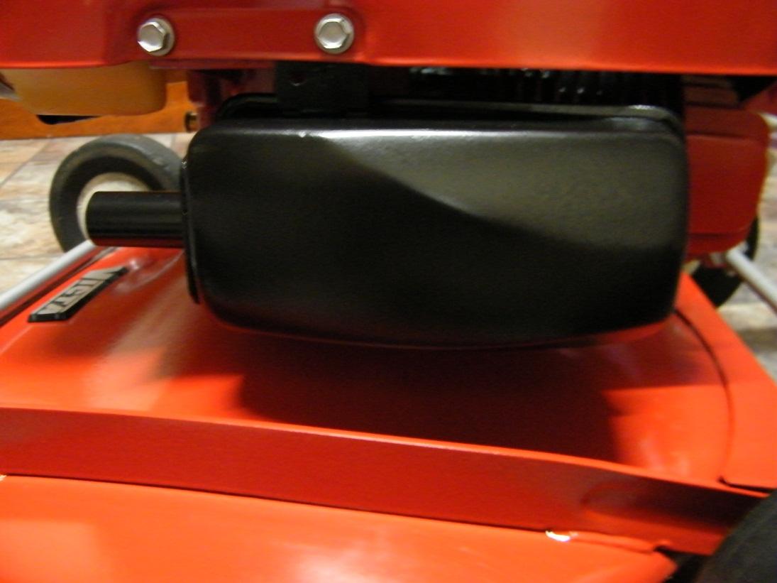

Hi all I'm just about done with the little red hot 125, so much for abit of fun its been alot of work haha....Just working on modifying the muffler and thats about it.Cant wait to fire the beast up. cheers Chris..[Linked Image]
Joined: Sep 2012
Posts: 418
Hi Im done modifying the muffler saved cutting the deck and it will flow better as well,The outlet I made is also a baffle not just a straight thru outlet I dont want to go deaf mowing haha.Im also making a heat shield for the fuel tank, I dont want to risk it getting hot as its a plastic tank..Cheers Chris[Linked Image]
congrats again Chris, your attention to detail is just awesome! grin
Well done nice piece of work there. Far from standard. Is it running yet? I would love to see a YouTube clip of it. Good work.

Here is a pic of the heat shield I made...Now bugger me it fired 1st pull!! lol... I am up loading a vid of 1st fire up..And so far not bad just a little Fine tune.. Go the mighty 2T Victa! haha ...Cheers Chris.. [Linked Image]

I am interested in how you did the baffle in your muffler.

G'day Mark i should have taken a pic of the baffle but they are an easy and cheap thing to make and work really well at keeping noise down[Linked Image]

I will have a go at the muffler baffle one day.
