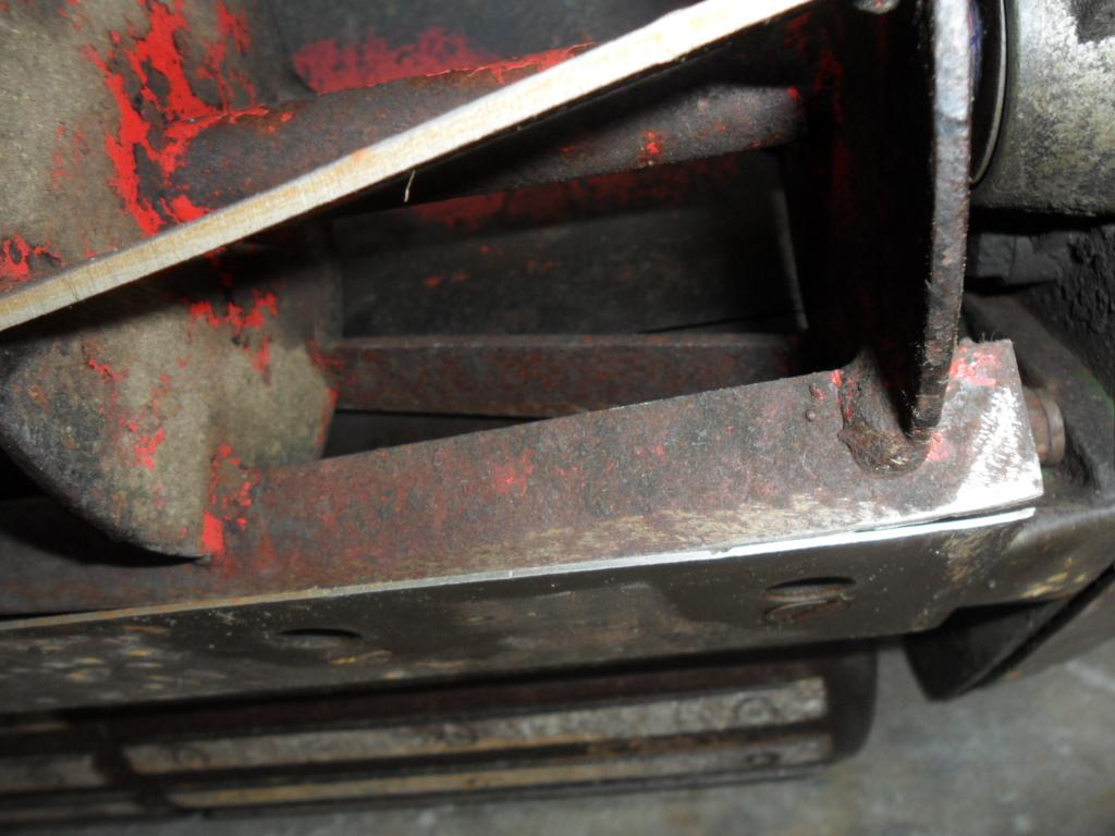

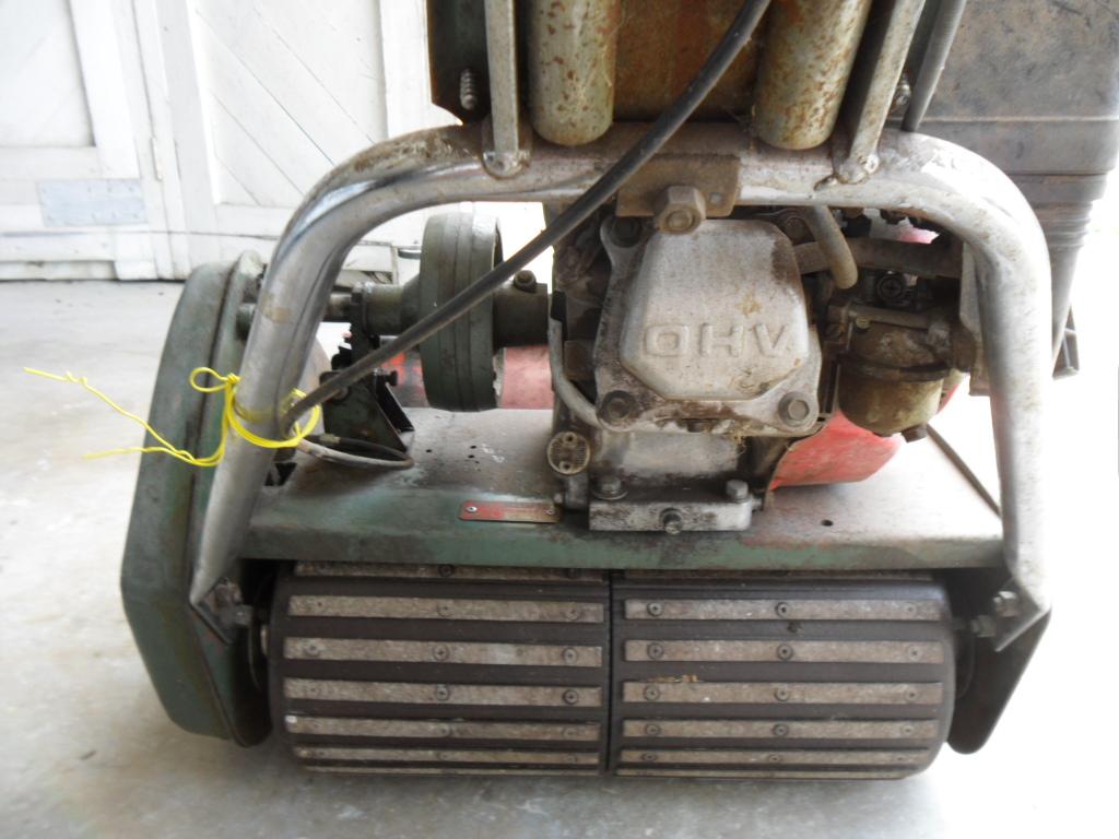

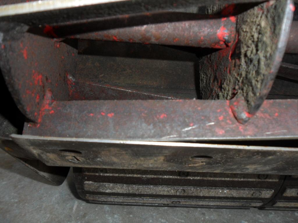

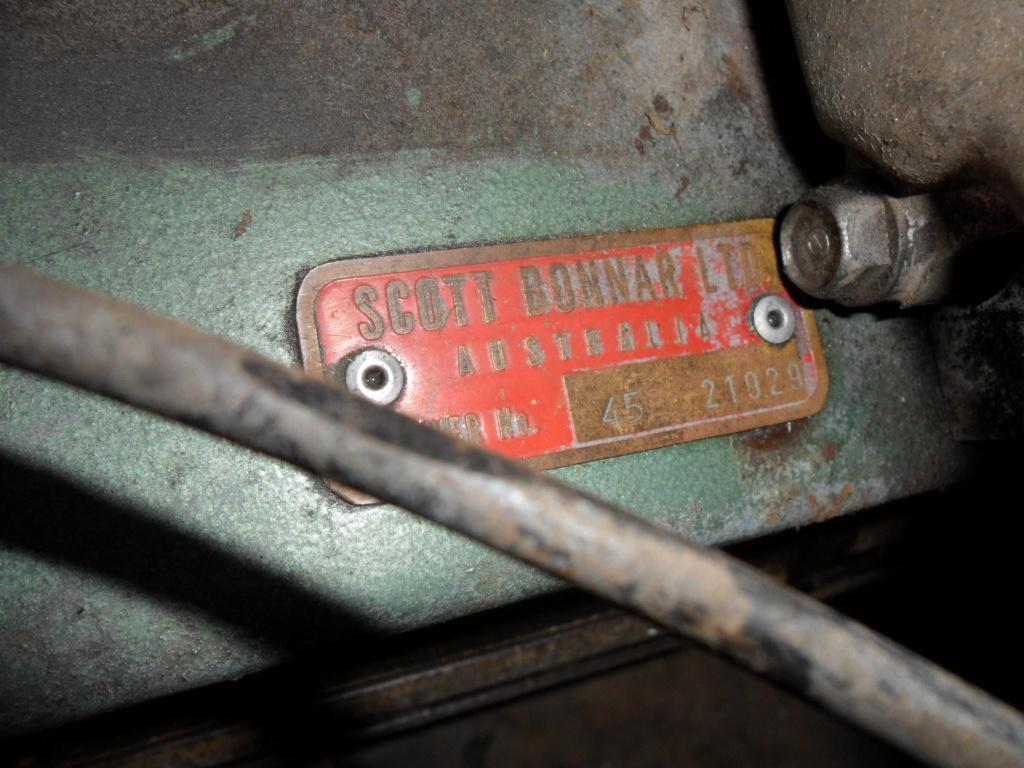

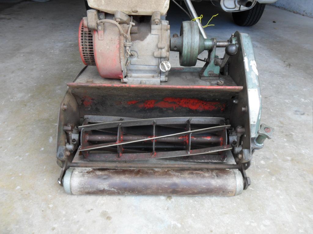

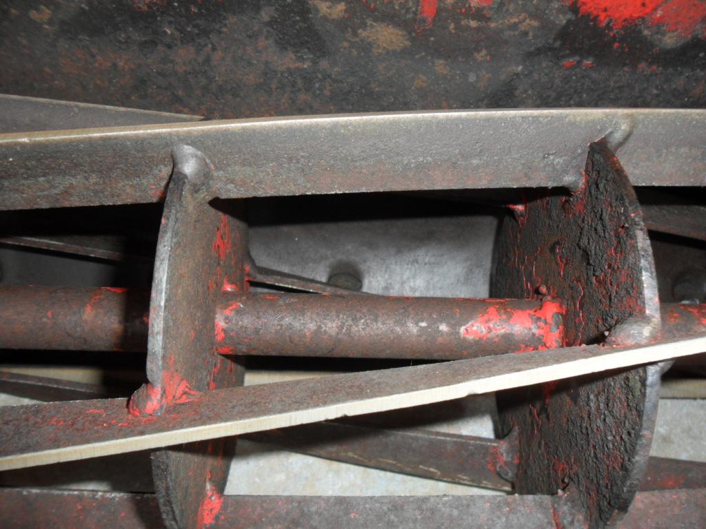

OK, as requested - Here are some "happy snaps" of my SB 45, its ID plate and its reel and bedknife -
Any thoughts / comments on reel / bedknife remaining life
Congratulations on the GX140 engine - I think a GX120 would have been more than adequate to do the job, but they are both nice engines. I don't recall the output shaft sizes - you may have had to get the 140 to get a 3/4" output shaft so you wouldn't need to replace the engine-side half of the clutch (the Kirby has a 3/4" shaft and I think the GX120 is 5/8" unless you get a variant version on special order). As expected for such an early machine, you have a one piece engine deck, which is perhaps just as well since the mower now has double the power Scott Bonnar thought it should have. (The later twin rail version seems prone to cracking the front rail at the inboard engine mounting bolt.)
I'll leave Deejay to talk about interesting features like the strips you've riveted onto the roller, presumably to help get up your hills, and how thick is thick enough for a bedknife. The reel looks to me as if it still has well over half its total life in front of it, but that is Deejay's territory.

Putting the engine on was a bit of a fiddle - had to mark out new engine mount holes and weld some flat bar under the deck to match. Then move the clutch outboard so the engine would sit inboard of the frame (we have elevated garden walls - so the engine had to sit entirely inside the frame). The fiddliest job was cutting the clutch output shaft and milling a new keyway in to accomodate the 2"+ we took off to allow the engine to fit. I have a lathe but NO MILL - so had to mill the shaft on the lathe with a simple milling vyce set on the tool post holder and an end mill mounted in the 3 jaw chuck - must have taken me about an hour to set the shaft up to exact centre height and square with the chuck so I could mill the keyway.
Yes - the ribs on the rear roller were put on to keep traction without skidding up the grades. My old Dad did that many years ago - I still marvel at his patience. He didn't dismantle the rollers and cut, drilled and counted-sunk all those little strips of 3mm x 12mm flat bar - then drilled and tapped all the holes in the roller and screwed the bars on with some Loctite. He was retired at the time - but nonetheless - it must have taken him days.
Hi Blade Butcher, and a warm welcome to the OutdoorKing forum. It's always great to welcome another Scott Bonnar Model 45 owner. grin
Well, now down to business..... You have certainly got the age right for your machine...it is a '68 model, the first of the line, solid engine deck, alloy end caps and grass deflector screws rather than black plastic knobs and will have horizontal screws in the chain case cover rather than the vertical ones of the later model.
There have been some 'tenants improvements'.... I can see...the engine has been moved to the left (viewing from the front) and the output shaft has been shortened and also the cutter clutch actuating assembly has been moved to suit. Why, I do not know....but I can see the original holes in the engine deck for the original placement. I suspect it was to fit the larger Honda engine. (My Scotty has the Honda G100 2.5HP side valve engine and is perfect for my lawns)
To the reel and bed knife...the reel, in my opinion, would benefit from a spin-grind (which only removes minimal amount of metal). This would remove any imperfections and square up the reel; backlapping can't do that.
A new set of reel bearings will not go astray, (they are cheap) as even if they are slightly worn, you will waste the effort spin-grinding and the adjustment (reel to bed-knife) clearance will be out of whack. wink
What concerns me most is the bed-knife; it is not original, and has been re-drilled to suit the soleplate....In fact if you look at your pics closely....you can see the original holes in front of the bed-knife screws. You can see also the the bed-knife has curled up at both ends. It is shot! frown
Here are my recommendations:
(1) Remove the cylinder reel and soleplate, complete with the shot bed-knife still attached using the guide Joe and I made HERE and take both to the engineers workshop.
He will then spin-grind the reel and supply you with a new bed-knife blade and new screws to suit, which will be the same as the original Scotty bedknife.
(2)Pick-up and install the new reel bearings.
(3) Re-install the cylinder reel and soleplate/new bed-knife and adjust the clearance using our guide HERE.
Please let us know how you get on. wink
Once again, :welcome: to the forum.

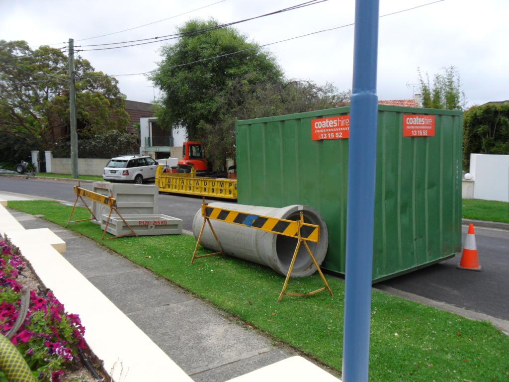

P/S Look what Council has just delivered to my SB45 for Xmas!
Somehow I think that I am going to need more than a couple of 6 packs to get around this lot. [Linked Image]
Anyway - my 1st task on Monday is to see if I can bribe these guys to move the pipe and concrete pits onto the road so I can at least give the nature strip a mow / tidy-up before Santa comes.
Somehow - from the look of the pipes and pits - I don't think there will be much left of my nature strip in the New Year - and damn-it I just recently spread about 1/2 bag of "stinky pellet" lawn food on to that grass.
