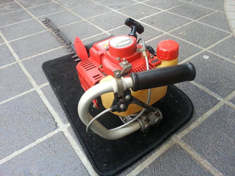

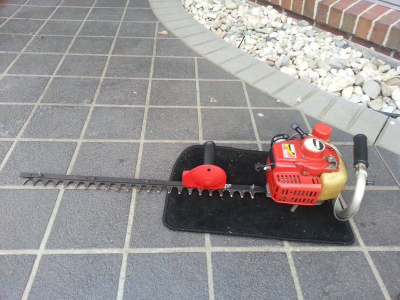

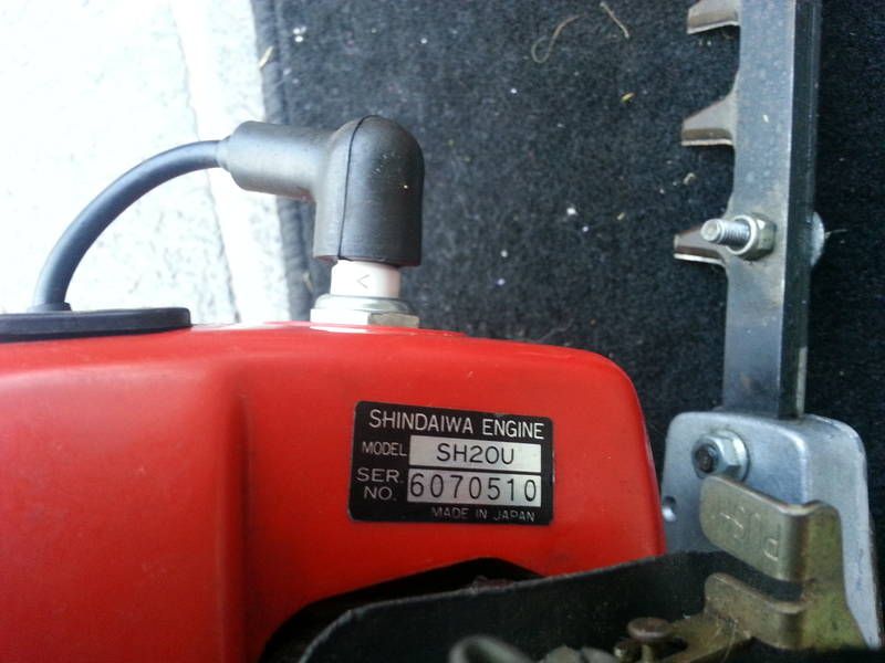

I was hoping somebody could help out with some info on the HT-20 single sided hedge trimmer by Shindaiwa?
I tried asking my local and they are very disinterested in even working out what years the unit was manufactured. I was also after what capacity the engine is? All they could tell me is that parts are discontinued.
I have tried Google and can't seem to find any useful info.
Here are some pictures of the model in question, they are from a sales ad.

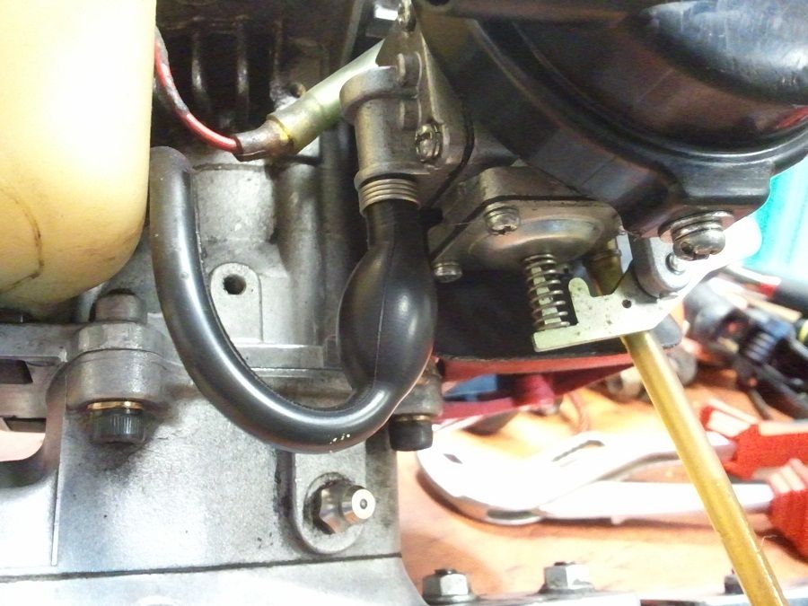

I have had a good look at the machine today and came away with plenty of spark, clean air filter, excellent plug and plenty of compression.
I can't seem to work out a routine starting procedure. This is also the comment from the previous owner.

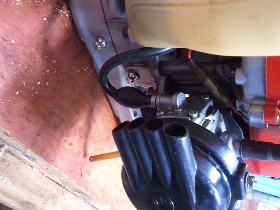

The machine has a small bulb in the fuel line just before the carby. Under the carb (where most modern machines have their primer bulb) this one has a lever with "press" stamped into it. Also on the throttle is a lock which keeps the throttle open. It also has a choke.
I can't fugure out why there is a primer bulb on the fuel line and a lever which I guess replaces the usual primer bulb. Surely these two items don't serve the same function.
When I squeeze the fuel primer bulb and it pressurizes the machine starts very cleanly and usually on the first pull. Occasionally the primer doesn't feel at though fuel passes and no amout of pulling will fire it up. Obviously there is little or no fuel in the system.
The fuel bulb pressurizes if I release the fuel cap.
The unit does not have a fuel return line via the primer. It simply drips out of an open ended line.
Edit. You can see the push tab on the primer lever in the last photo and the fuel line bulb in the third last shot under the four intake tubes on the airfilter housing.

This is a few pictures of the carb features I mentioned.
The primer bulb in the fuel line
The lever at the base of the carb the primes fuel through the amber hose in the bottom of the pic.
The fuel cap which appears to be similar to most Shindaiwa units and the one pictured in the first post which is identical to my machine.

Basically I undo the cap, prime the black bulb till pressure is there then I pump the lever under the carb. Screw the fuel cap down and it starts second pull. It runs with no issues. I trimmed my hedges today and it ran perfectly.
As for tampered with, I think it's all original. The pictures of the HT-20 in my first post are from a unit for sale on Gumtree. It looks identical to mine with both a primer on the black fuel line and a lever under the carb. This also matches the diagram I pulled off the net.

Inside the carby air filter housing is that typical looking date code stamped on plastic parts of power equipment I have played with. Mine says 8th '93 so if that is to be believed, it is an old unit in good shape. Finding a manual or even just reference to the correct starting sequence would be difficult.
