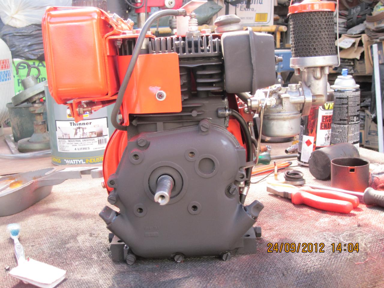

looks great mate . hope you didnt paint the air filter too ? ! congrats

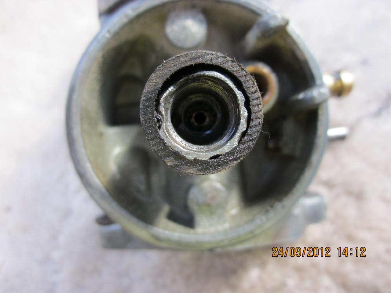

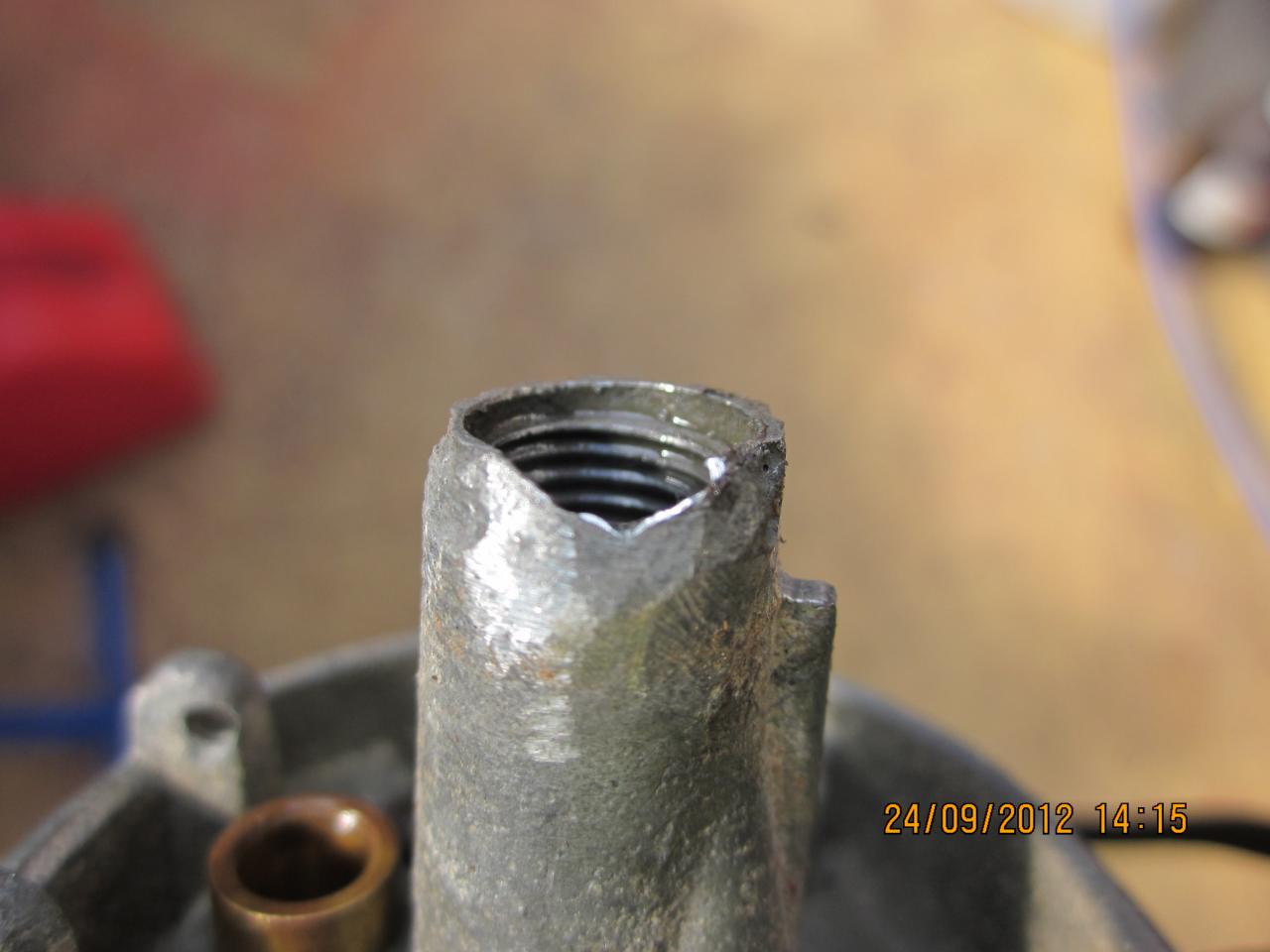

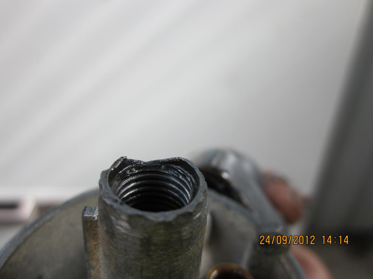

Well got em
So here you see the damage by corrosion
the sleve MADE OF THAT ORRIBALE BLOODY PLASTIC STUFF hehe
I cut a wee square notch in sleve were it would be in alloy
filed to match the length of original tube , put it back togeather n and away she went
I,ll try get a we video of it running tomorrow now I can load phots
The paint spoild with all the tinkering and leackage from fuel cap so I,ll touch all that up soon
Ive got must of the base cleaned up
I need a couple of reel end bareings a plastic end cap for the front roller new base knife or blade the reel trued up n ground clutch plastic bizzo thrust whasher thinngy
Id like to put a full kit of seals gaskets and a carby kit as well
um I have to have the handle bars recromed they are a bit untidy
Oh and the stickers just to realy do it nice yeah
she is the 14" model
just hope I can remember how to put er back togeather
anyway sorllgoodfun

At least that piece of plastic, which looks a lot like electrical conduit, is on the outside so it shouldn't contaminate the fuel inside the carburetor all that much. I had been guessing you'd put a soft plastic sleeve inside the thread, to make up for the missing part (I had visualised that most of the interior thread was missing). If I had been trying to fix the problem you actually had, I'd have filed or machined off the damaged bottom part of the carburetor body and used a short piece of aluminium tube (not copper against the aluminium carburetor - that would corrode) as a spacer to replace it, with a gasket on the upper end of the piece of tube. In theory that would be a permanent repair. You could always try that if your piece of conduit gives way after a few months - but getting a second-hand carburetor is better.
I wish we'd had those pictures to start with - we'd have had a different conversation.
