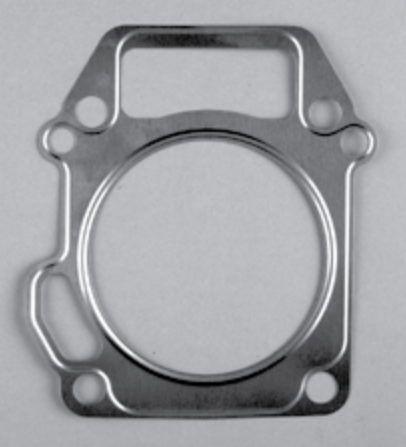

Post-edit: These pictures from spare parts listings may give you an idea why the Intek engines blow head gaskets and the Vanguard ones do not. Here is a 25 cubic inch Vanguard head gasket - I have added a red circle to show where it usually blows, from the combustion chamber to the pushrod chamber:

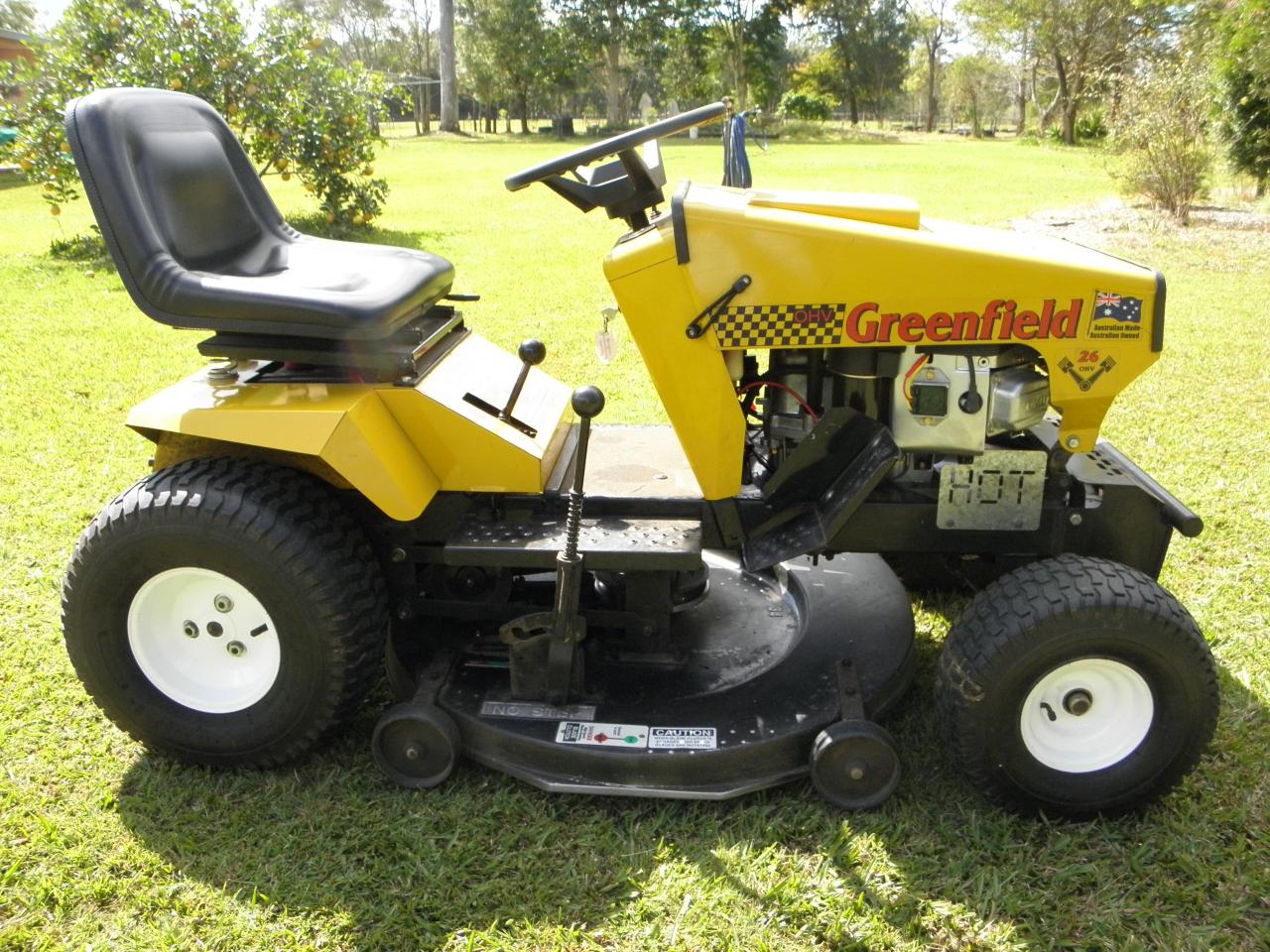

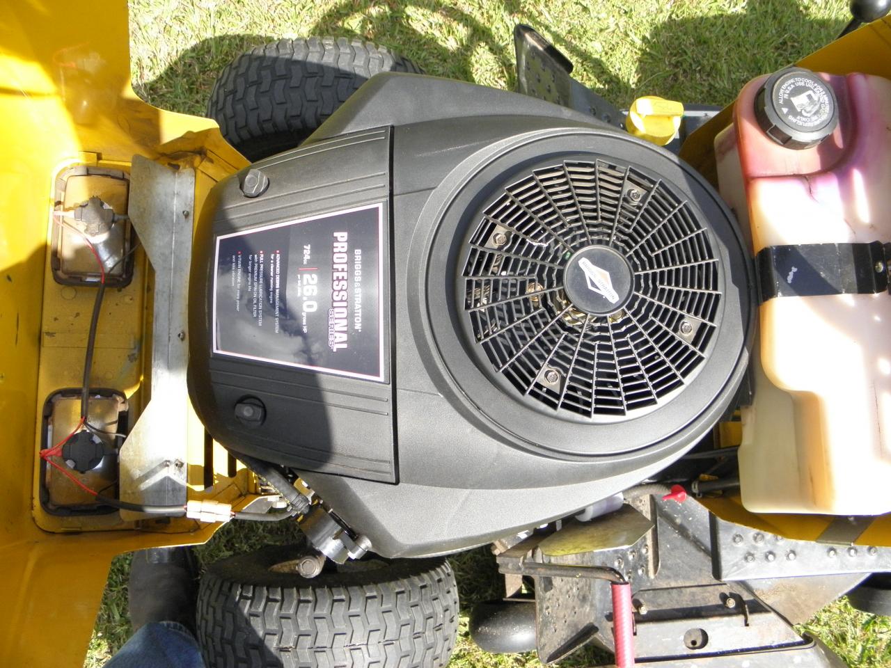

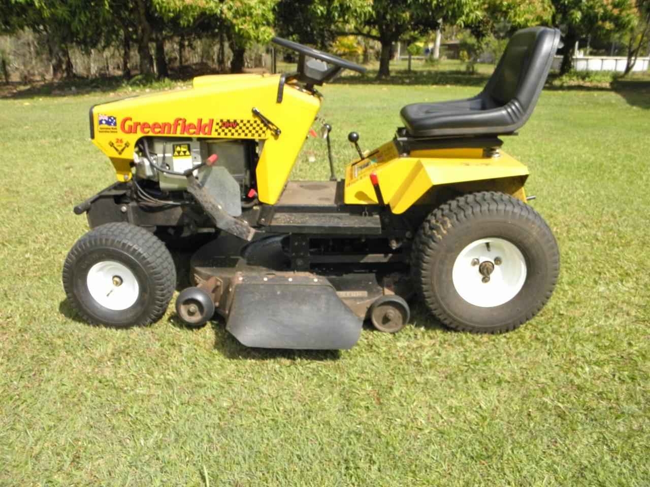

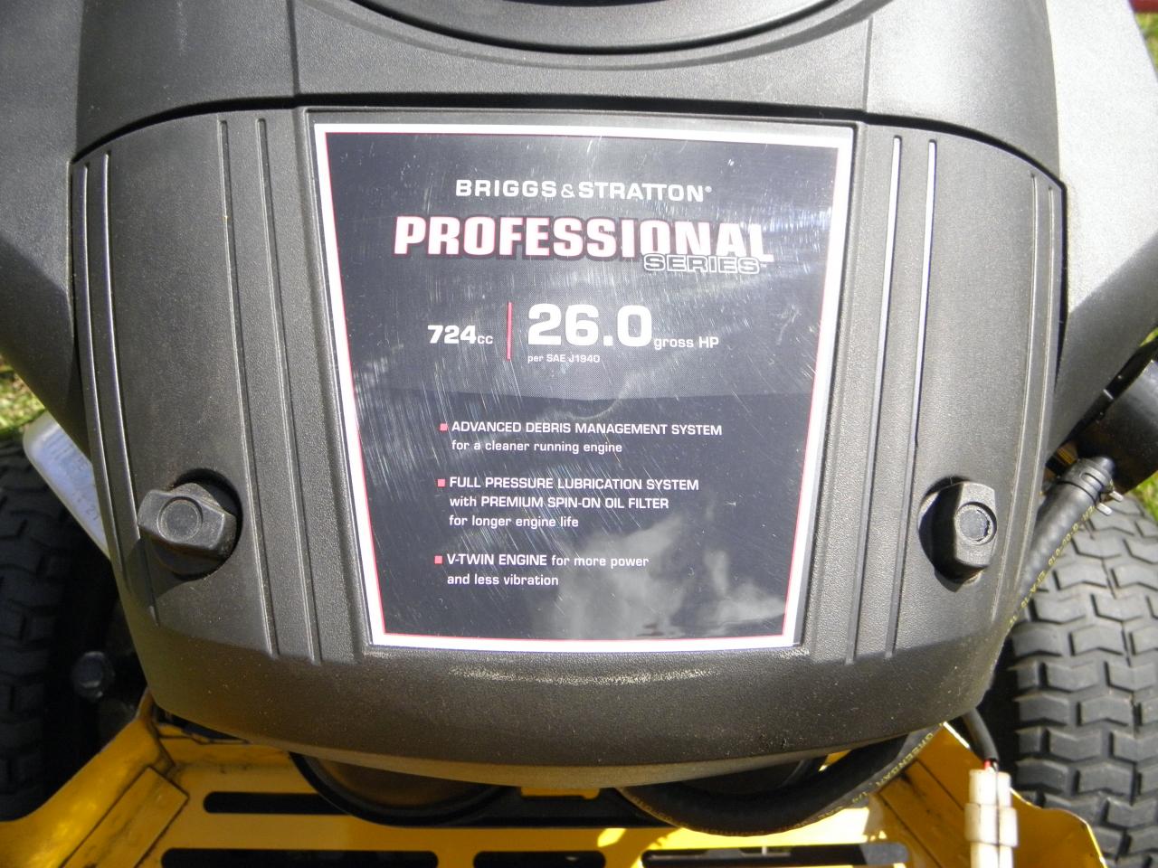

Attached are some photos of the installed engine and machine as requested, to round out and close the thread. B&S have reworked the air intake system and filtration arrangement - it seems better designed to resist bypass dust entry. They have also added an electric fuel pump. The exterior dimensions of this engine are greater than the one it replaced, requiring the dealer to rework the engine cover hinges to allow it to close.

Thanks mustang. A couple of questions though:
1. Is that air filter a foam pre-filter wrapped around a paper filter? If so, is the foam section oiled? Can it be removed to wash and re-oil it? Or do you have to replace the whole thing at frequent intervals?
2. How often does the oil filter have to be replaced? Does that coincide with every oil change?
3. Are you supposed to switch on then wait for the electric fuel pump to operate before starting the engine?

- engine is B&S Model 44P777-0177-B1 "Intek" ELS Professional, 724 cc, 26 HP, Vee-twin
- this engine series features a larger cooling fan than the standard models
- this engine series also features an electronic fuel management system, which is supposed to monitor engine temperature, engine speed and battery voltage to adjust choke during starting and warm up. There is a dashboard-mounted manual choke control lever which must be used to start the engine, and then quickly set to off when engine starts.
- electric fuel pump appears to be required as the carburettor intake level is above the bottom of the fuel tank on this mower. (There is no wait for fuel delivery, engine start is immediate using manual choke. Also B&S guarantee fuel delivery on a 15 degree mower operating slope.)
- air cleaner foam pre-filter is a dry element, which I clean frequently in dry dusty conditions. (OEM says clean each 25 hours, and replace annually.)
- air cleaner main element is the usual dry paper type, which I clean along with the pre-cleaner. (OEM says clean and replace as for pre-filter above.)
- engine oil change is done at 6 monthly or 50 hour intervals. (OEM says every 12 months or 50 hours.)
- oil filter is changed along with engine oil, every 6 months. (OEM says every 12 months or 50 hours.)
