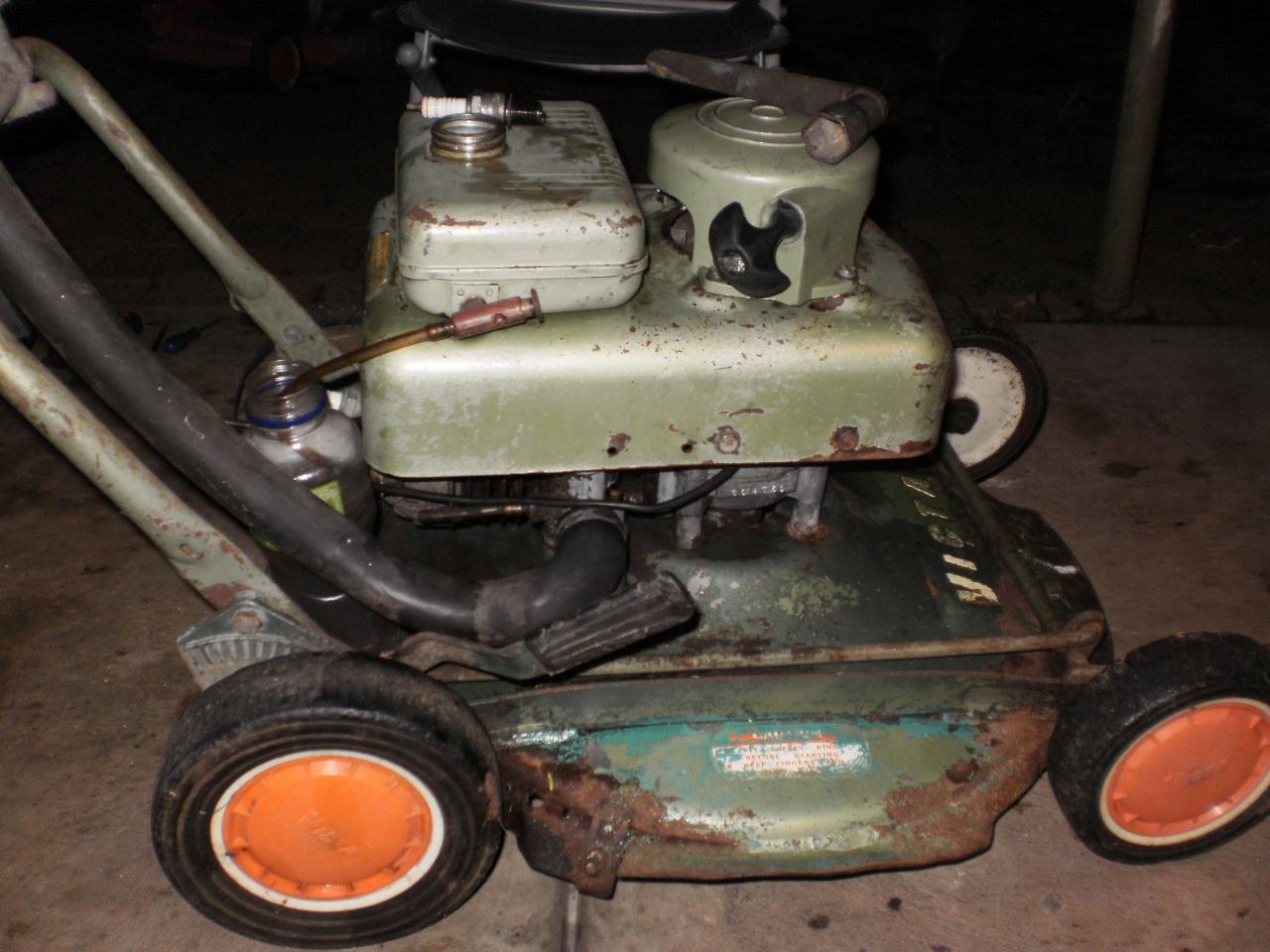

again with the questions ! i had a look around and i know i've seen some like this , but same as always . when you want something ya cant find it ! so i'll ask any one know what this is ? took some starting but sounds good . a 125 ? bolted at the bottom of barrel , long reach plug same as my corvette but different grade might both be wrong blush champion n8 'vette and n21 in this ? [Linked Image]

It is a Model 540 Utility,1967-68.I have one the same. [Linked Image]
Yours however is in much better condition than mine. I have to restore mine. Hopefully soon.

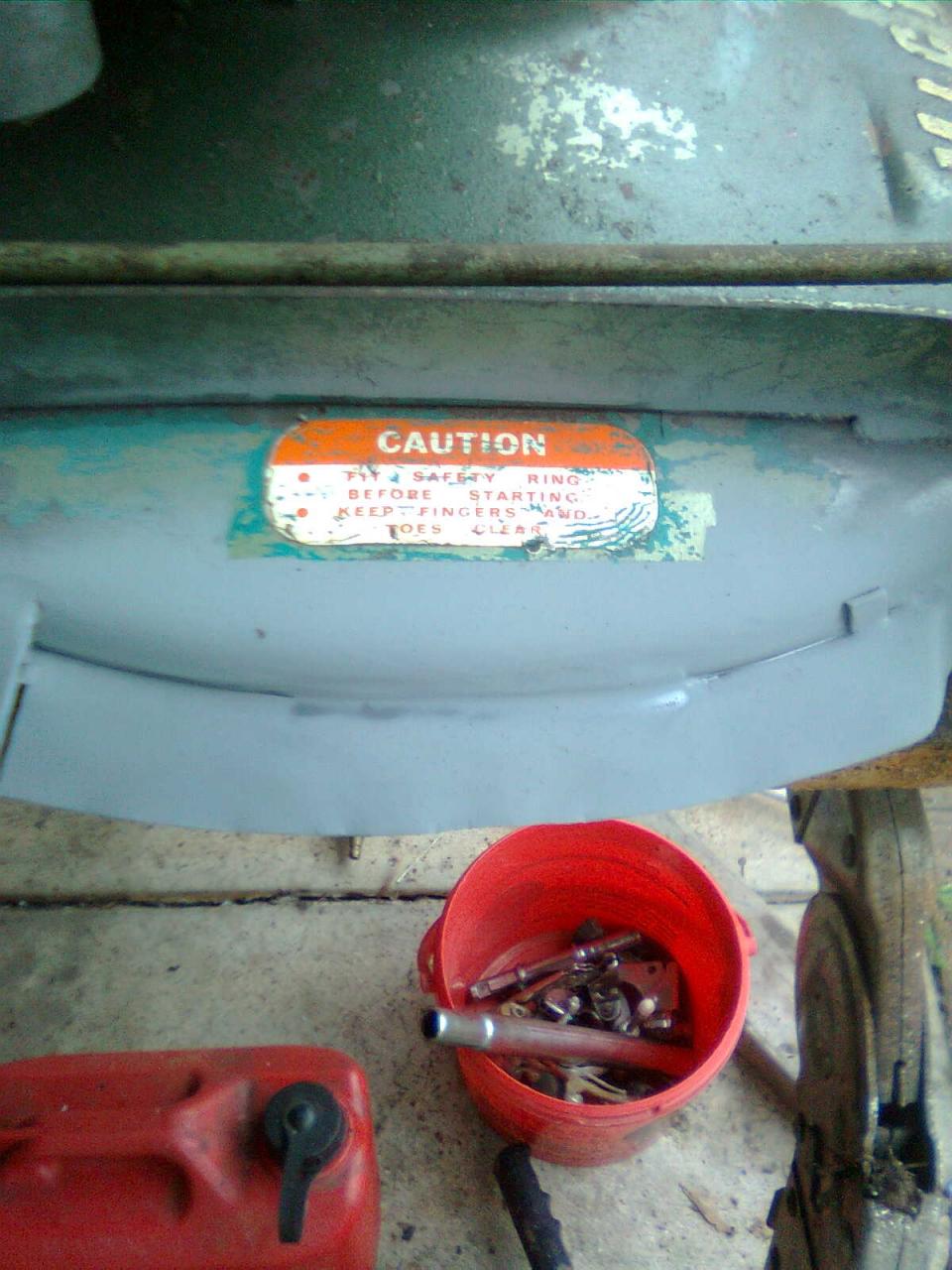

a little better ? might explain why it is welded , found engraved into the front of the base P+G under a few coats of paint , parks and gardens maybe ? [Linked Image]
might be why it looked like it was done from new too me . but looking better than it did smile
