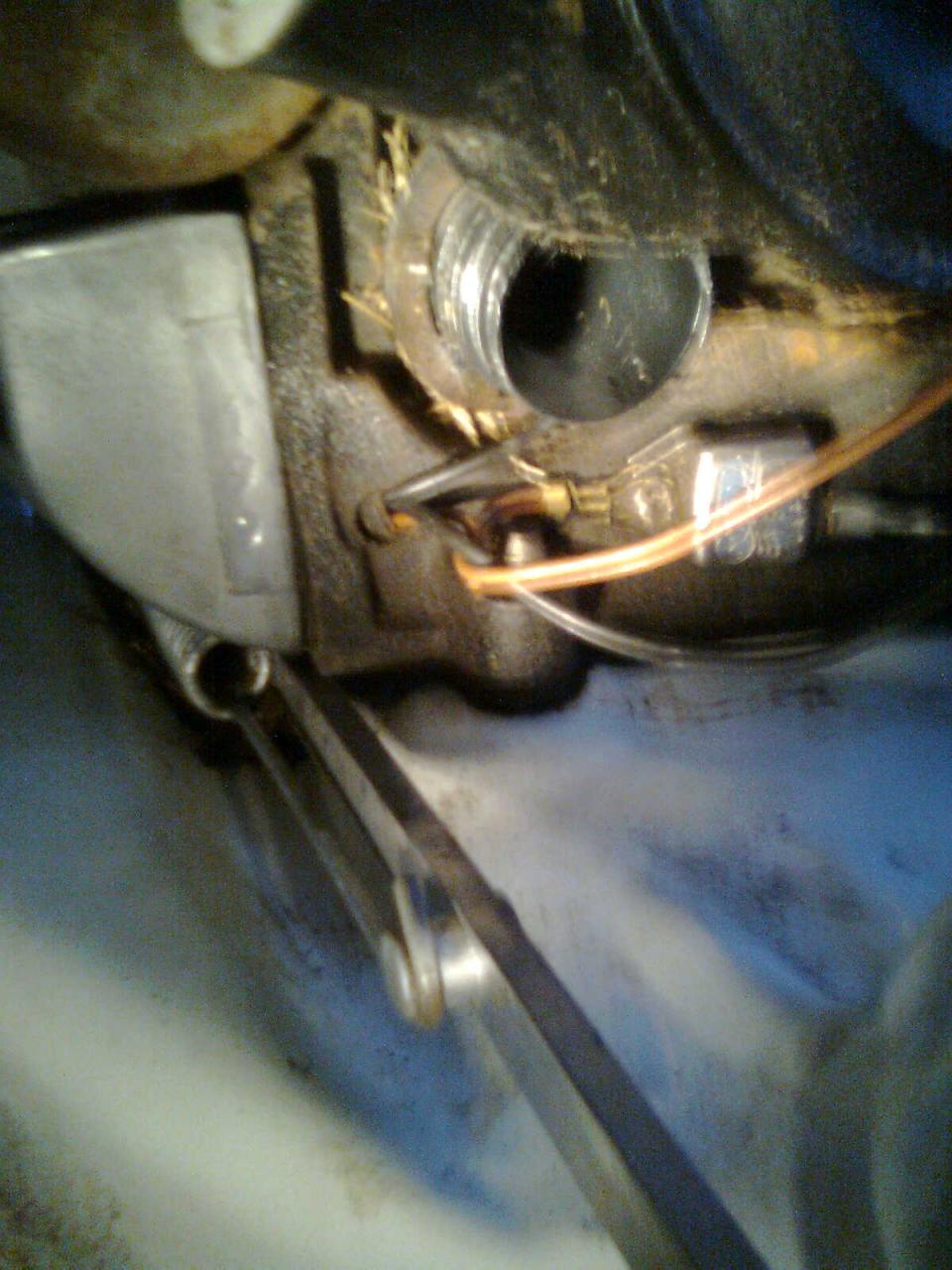

might help i hope [Linked Image]
dont think you need to cut wires . cheers

ah great work mate.In the second pic.looking at the ignition module that wire on the right hand side...wheres that go?UP the frame to the key?
cheers i appreciate your help....all responders that is. cheers2
goes to the cutout on the carb , this one is just a powertorque , no starter brown and black to carb' . a tad dark and no flash on my phone smirk so if its not a help i can take better tomorrow

always was a powertorque , i know the pic's are blurry but look at tha brown wires . both under the rivet one comes out of the 'case the other to the carb . black one is pushed onto a spade on the module , should have a spade connector , the other goes to carb too. mine have it that way and one has good spark the other runs well . cheers
