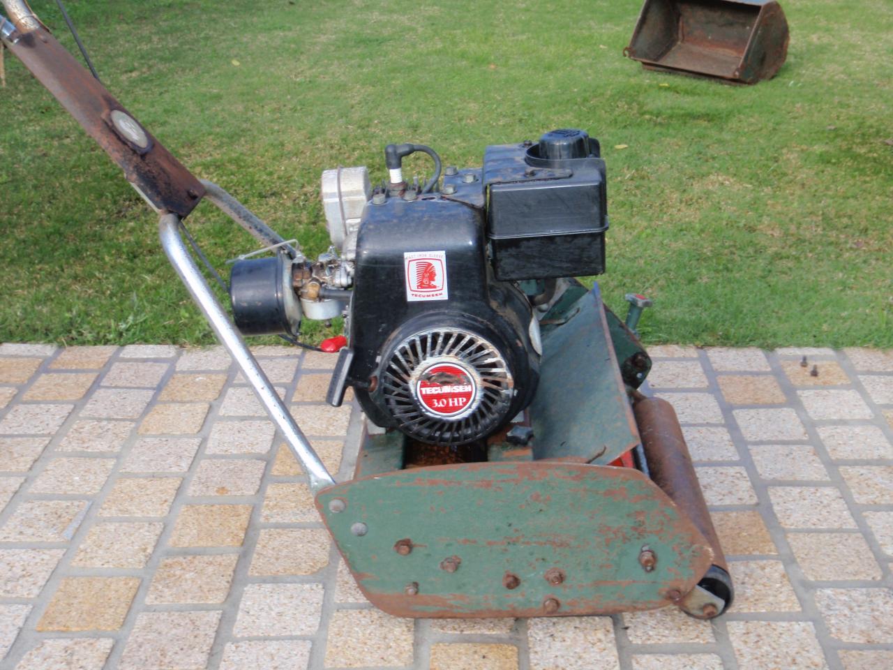

I have inherited a Scott Bonnar cylinder mower. The model number is 450423 and the mower number is 4568281. I inherited this mower from my grandmother after my grandfather passed away. My grandfather was one of a kind and was held in such a high regard by all. Someone I always looked up to.
I am looking to do a full restoration on this mower and am after a little help along the way. For example where to start. I remember the engine was replaced with a new Tecumesh 3HP engine in the early 90�s. I�m not sure if this was a good decision after reading a few threads on the forum? Any help would be greatly appreciated. Cheers

Hi Manch, and a warm welcome to the forum. It's great to have another Scott Bonnar owner on board. grin We all like to learn new things and tinker here wink
Manch, It is wonderful that you are contemplating a full restoration, and I'm sure that your grandfather will be pleased and proud!
We will need you to post some pics of your machine from different angles including:
(1) The cylinder reel
(2) The inside of chain-case (remove the cover) as we need to see the condition of chains and sprockets, including one of the cutter sprocket where it is not covered by the chain.
(3) One with the catcher installed.
We will need any numbers on the Tecumseh as well. wink
Once again Manch, :welcome: to OutdoorKing.

Thanks for the response. I have attached a few photos for everyone. After a can of degreaser i managed to find the serial number on the motor 19-0-144.
Hi again Manch, Thanks for posting the pics. grin
Well mate, from the look of it, this will make a good restoration project.....it is a 70's model; with the vertical chain-case screws (earlier were horizontal) and it has the plastic front roller end-caps and the black plastic knobs on the grass deflector adjusters. wink
The cylinder reel has plenty of meat on it and doesn't look like it has been sharpened in quite a while.
It appears all original with the exception of the 3HP Tecumseh...the original engine would have been a 3HP Briggs and Stratton painted in the same 'International Orange' colour scheme (Same as the reel)
The sprockets and chains look reasonable for its age as do the chains. wink
We need now to come up a restoration regime for you to follow, what we need to know now is...how far do you wish to go? Don't worry, we will step you through the procedure and in the end, this machine will give you hours of mowing pleasure. grin
