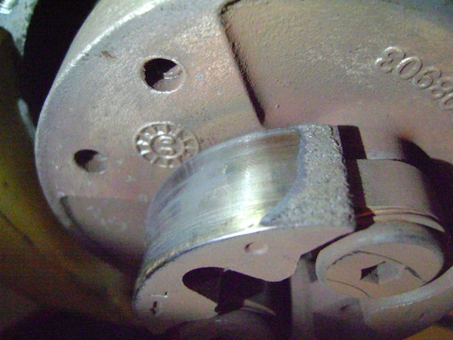

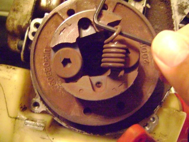

Yeah, the moment I saw this trimmer to buy it I knew that it had been neglected a bit, like they guy wasn't even using an air filter and I was also half-sure that the head was not supposed to spin when idling, but I got it really cheap.
Originally Posted by grumpy
When the clutch works properly it should be easier to start, since it won't have to turn the drive shaft when you pull the starter.
That's exactly what I thought.
And the carb is a Walbro WYL and doesn't have low and high screws.
I'll create a new thread when I install the clutch.
Thanks
Posts: 29
This is my final comment on this thread.
I have installed a new clutch in the line trimmer and after assembly the unit started right away. So the broken clutch was the cause of the hard starting and idling problems. It now takes only about 3 pulls to start and idles without stalling like it did before.
Had I known about this I wouldn't have spent money to purchase other parts so hopefully someone other than me can learn from this: A seized clutch could be the reason for hard starting and idling problems.
