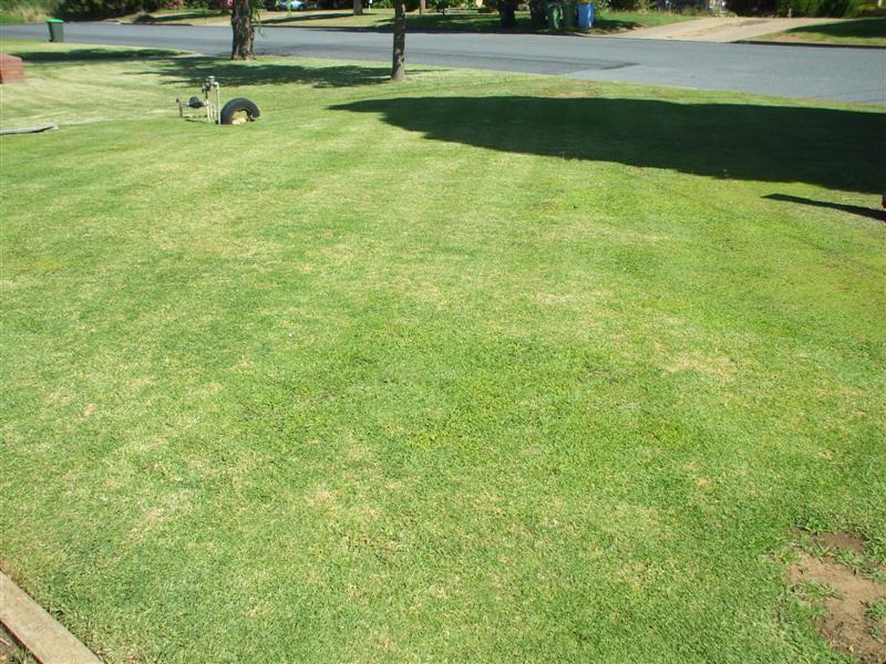

Hi Joe, just finished the lawn and edges, the 45 cuts beautifully...very smooth finish....here's a pic...
Thanks once again for all your help yesterday, and Happy Editing, I can't wait to see how it turned out either! lol
