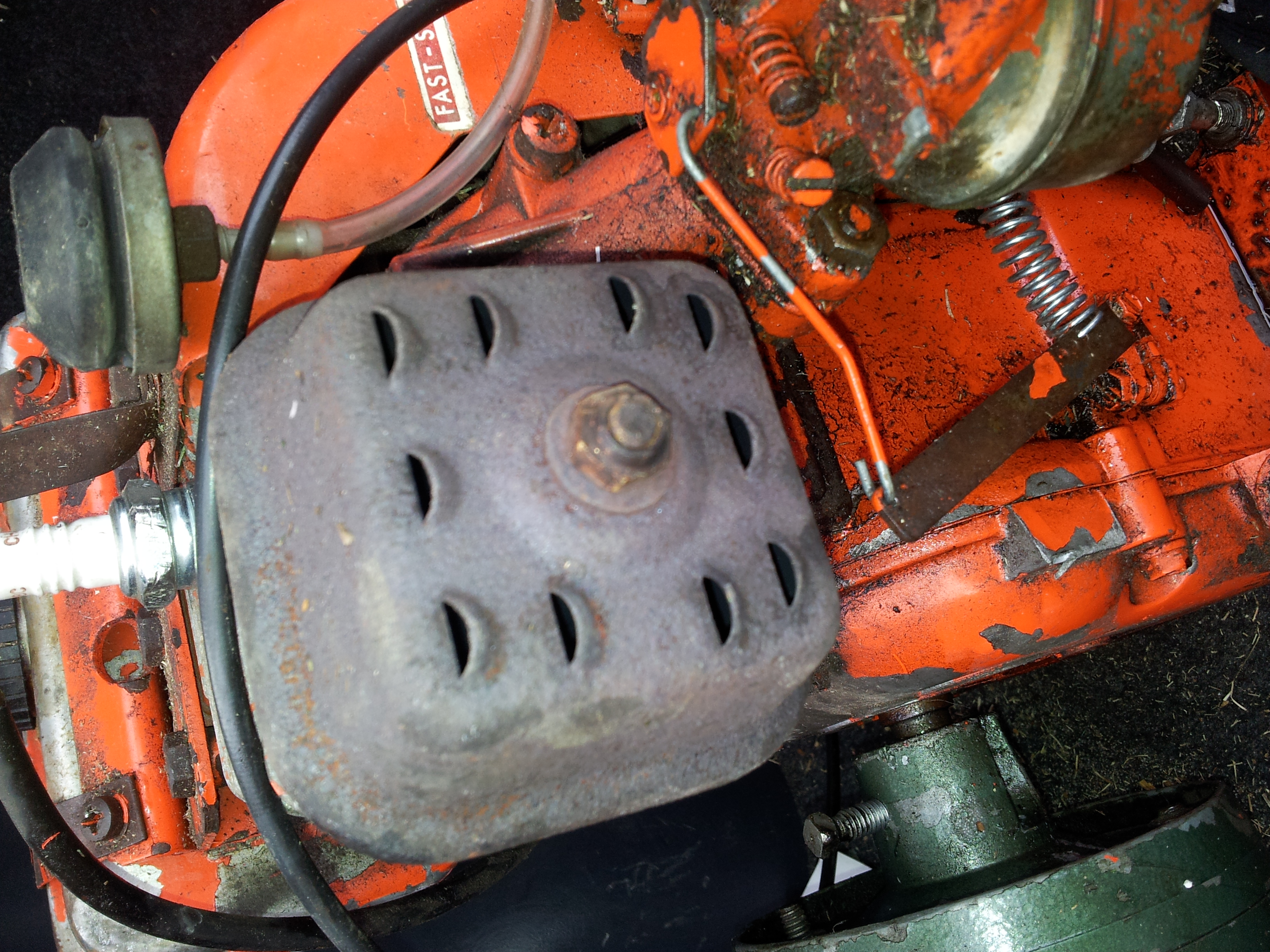

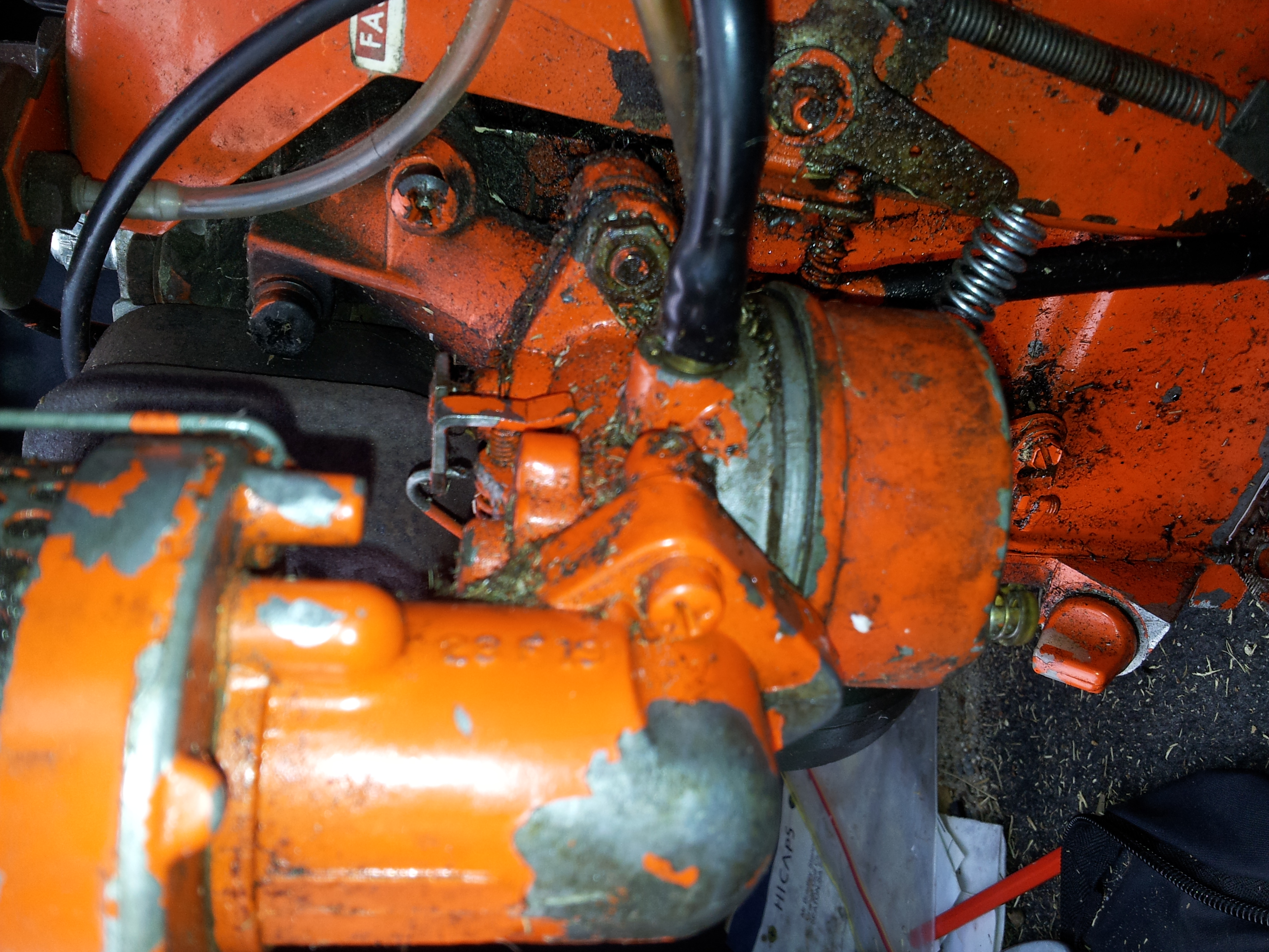

here are the pics that i took. Hopefully it will give you a better idea. I do wish to keep using the current engine- has worked so well till now.
It did have some sludge in the carby, which i have since cleaned, but the fuel tank has some residual coffee like granules from some old fuel firmly attached to the fuel tank walls. Does anyone know of replacement equivalents that might fit?
Model is H4-4a. interestingly, last night when i started it there was fuel squirting out of a needle size hole on the top left hand side of the carby. Could this be a result of too much fuel? Float and arm seemed to move freely...
I will have a closer look later but I really do not like that govenor spring (the bright silver one) The tecumseh carb is a somewhat troublesome beast but it can be rectified.
The little hole in the top flange of the carburetor is usually there to let fuel squirt out if the float bowl floods, to keep the surplus fuel from running out of the main jet into the intake pipe and harming the engine. So, it sounds as if your carburetor is now flooding due to grunge between the needle and seat, or perhaps a stuck float arm but that is less likely.
You reported major fouling of the fuel tank. Most likely some of that has now moved downstream into your carburetor's fuel intake area, upstream of the needle and seat. You need to clean out the fuel tank, the fuel hose, and the fuel intake fitting of the carburetor.
If the interior of the fuel tank is not substantially rusted, it should be easy to remove the deposits from the inside. The gum (fuel residue) can be removed with a solvent such as carburetor cleaner. Nodules firmly attached to the inside of the tank can be removed by putting hard objects into the tank and shaking it until the crud has been bludgeoned loose. Then you tip out the hard objects and most of the loose nodules, and rinse out the rest. Always get the fuel tank properly clean before you bother to clean the carburetor, because all that happens otherwise is more crud from the tank just undoes your good work.
From what you've said your old engine has the usual collection of crud extending through its fuel system. Clean the tank, then the fuel hose, then the fuel intake into the carburetor, then if necessary the rest of the carburetor (main jet and drilled passages). When you have the tank and hose clean, you will have to remove the carburetor from the engine to do the rest of the cleaning chores. I suggest you begin your preparation for cleaning it by reading this set of instructions:
http://forums2.gardenweb.com/forums/load/lmower/msg061726346162.html
Remember, your engine is actually an old Lauson engine. Lauson was bought by Tecumseh, and the early Lauson engine was then licensed to James N. Kirby in Australia, for local production. Yours is an Australian-made Lauson.
Please come back to us when you have the tank and hose clean, and you have read the overhaul instructions. We can talk about any issues you have with the procedures involved. I recommend that you do not dismantle any more of the carburetor than necessary, because you will damage parts that may be difficult to replace. Read all the detail, but do not proceed with it at this stage. All we will want to do at first, is clean out the area upstream of the float chamber's needle and seat.
