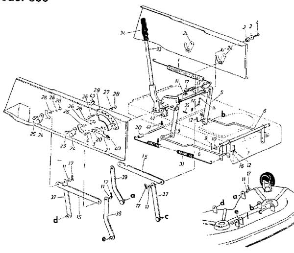

hi everyone ,i have taken my deck off replaced bearings blades etc,
but i cant see where the under carriage springs go , idler ok,just the ones that support or allow the deck to lift etc , there is a long one and two short ones ,short ones are the same ,
i checked the mtd site but their online manual didnt show them
thank you ian

Ian,
Below is a picture of the springs from the parts list which show where they go. Hope that this helps. cheers2
Joined: Nov 2011
Posts: 9
thanks bruce but this is one of the diagrams that i downloaded ,
but it isnt showing the springs that connect to the deck it only shows the linkage springs
thanks for trying regards ian
Posts: 5,407
Likes: 35
Ian,
That is the only springs and if you look at the picture you will see that the linkage fit direct to the deck which the springs are attached to. Are you talking about springs for belt tensionsioning and blade brake etc? cheers2

hi bruce the springs i am trying to locate are the ones that assist the deck when either raising or lowering ,
there is a long one and two shorter ones that actually conect to the deck and chassis , and i believe they help pull the deck forward or backwards ?? ian

re springs, would anybody who has a white/mtd rideon 600 series please check under the deck and see where these springs are located ,
i believe there is one long and two short that attach to the deck itself i maybe wrong but if you could check it wpould be appreciated regards ian

Where did you get the model number from?
That model deck does NOT have springs attached according to the MTD/White.
I have rechecked and unless you supply the correct model number you will continue to go round in circles. cheers2

thanks for rechecking bruce ,just went down to local mtd dealer he seems to think the springs in question where probably added by a previous owner he said some people even fit old trampalene spring s for whatever reason , on the weekend i will retry without said springs and see what happens , thanks again ian
Ian, the tenant's improvements seldom have a positive effect, so putting it back to the way the parts list shows is likely to be a step toward getting everything working properly.
Ahhhh!! tenants improvements....don't you just love 'em!! lol
