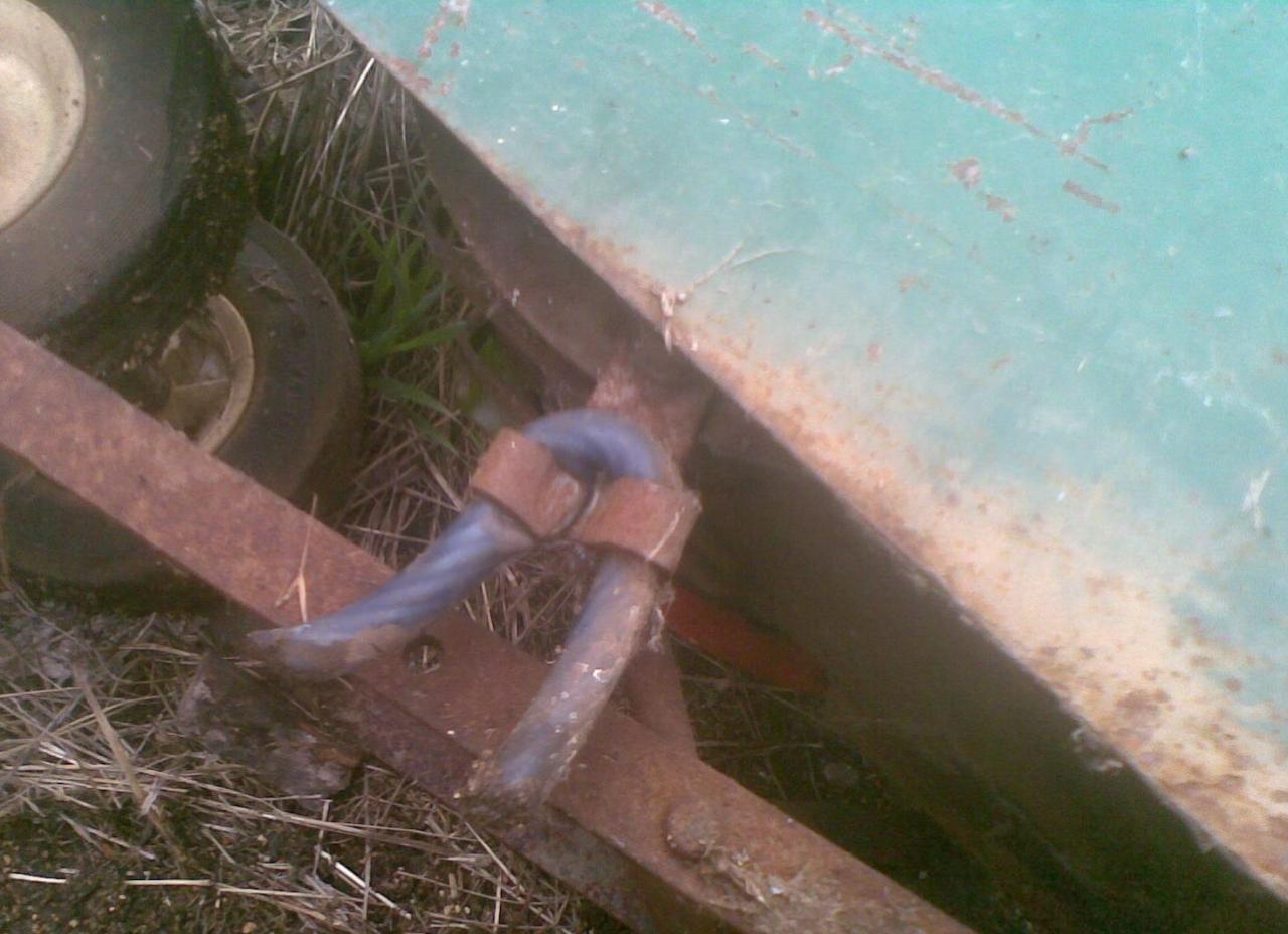

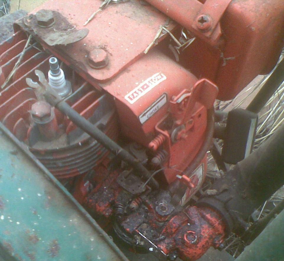

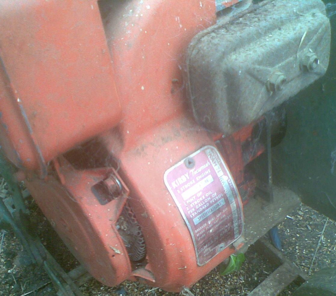

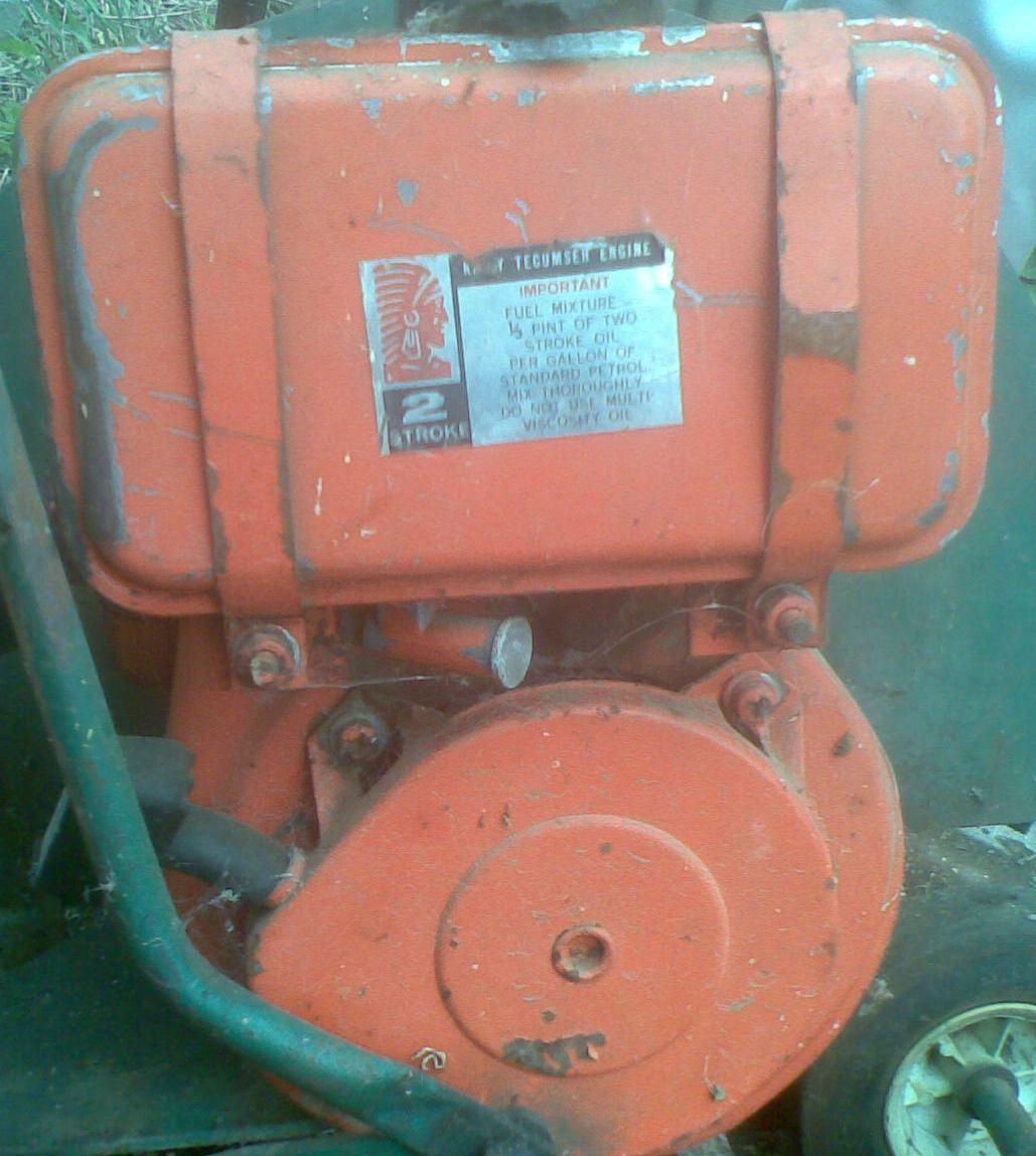

I went to visit a friend of mine the other day, and whilst there, he showed me this old edger he had in the back shed, it's quite an interesting one, does anyone know more about it?
The manufacturer plate was missing, all i can say is that it had a 2-stroke Kirby-Lawson engine, and used steel-core rubber sheath rope instead of blades, which, judging by the brackets used for the rope, is how it was supposed to work, not a tenant fix.
Here is some pictures, sorry for the quality, I only had my phone with me.
By memory, we worked out the engine to be late 60's from the serial, but I can't find the paper i noted it down on.

Hi grumpy, is it possible to date Kirby-Tecumseh engines by the serial numbers as you can with a Briggs?
I don't know how the serial numbers work, Deejay. It appears the first letter in the model number is V or H for vertical or horizontal crankshaft, the second is simply K for Kirby (i.e. made under licence by James N. Kirby) and the final two numbers are the alleged horsepower. The serial numbers seem to have been Kirby's, not Tecumseh-Lauson's, so you could only break the code on them by use of information from the Kirby company.
Fortunately I haven't yet encountered an Alroh Imp with a Lauson engine - they used Briggs, even back in 1962, when they must have been paying a lot of import duty to do so.
That's a shame, I thought we might be able to narrow down the year on this one....however SB were using Kirby-Tecumseh from 1960 with the Model 33 but they were 4 strokes....I haven't had much to do with the Kirby 2 strokes like this one. wink
I'll try and get some clearer pictures of this one, Plus it's serial number in the near futre.
