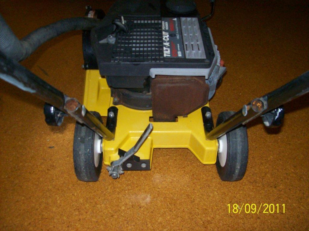

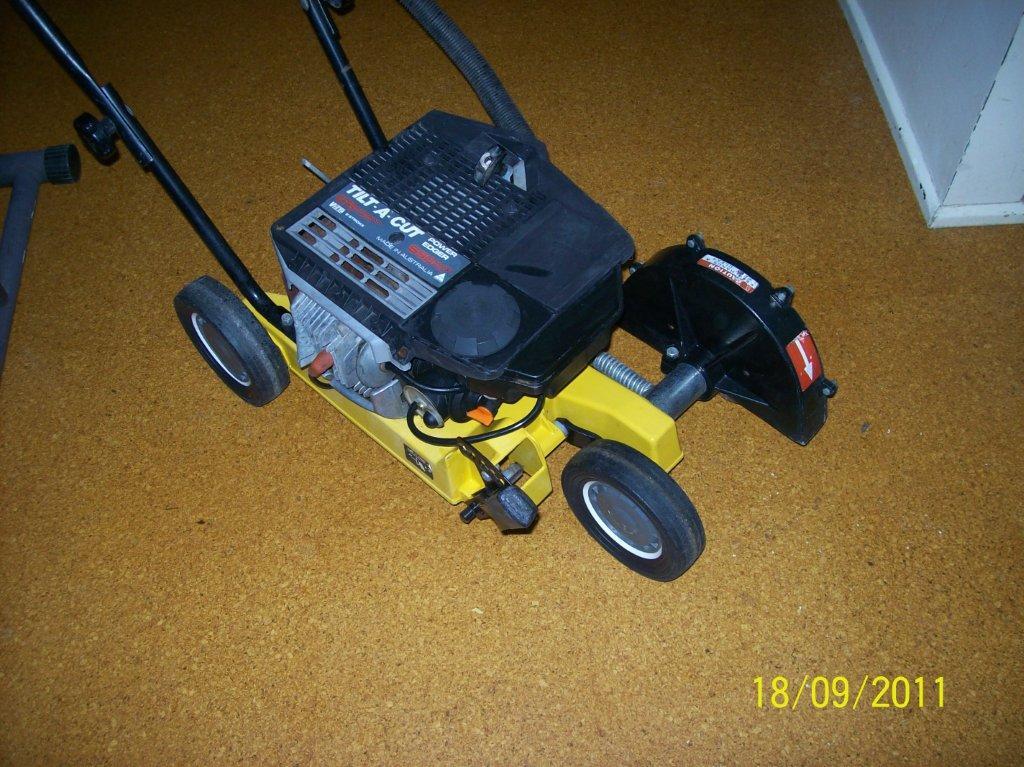

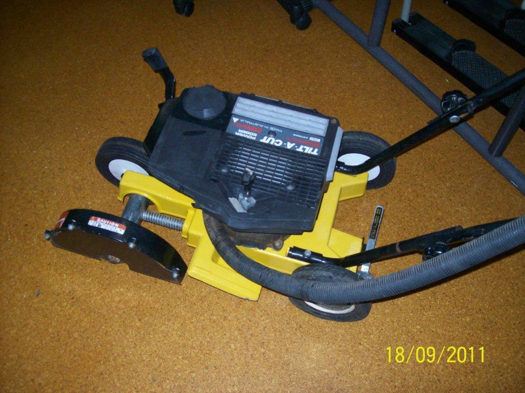

Here is a Victa edger that I got from Joe on Saturday.The poor thing had been next to a shed that had caught on fire.Joe said he had replaced a few things such as the cowl and repaired the starter.When I got it home I changed the top part of the handle as it had heat damage.Also the air cleaner and the knobs that hold the handles up.I need to find a couple of hub caps as they are also a little melted.I have given it a really good clean.Also pulled the carby apart and found that the needle was in backwards.So I'm looking forward until I finish work tomorrow to see if it will run for me.Here is what it looks like now.

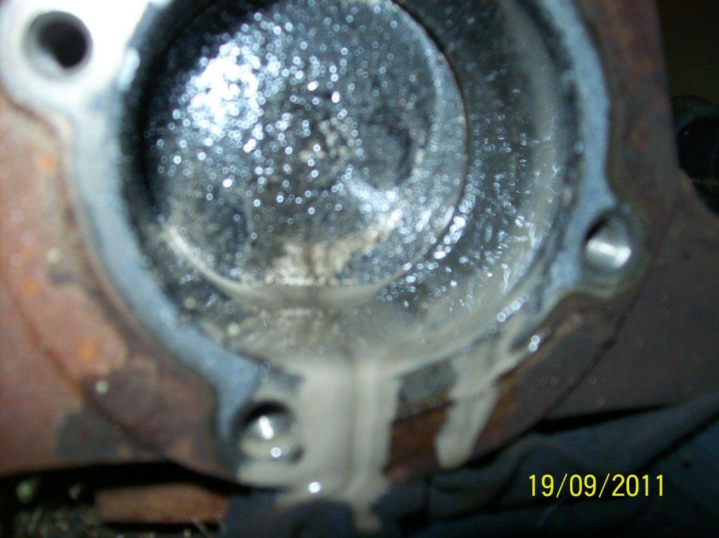

Went to start edger.SNAP!! No go.Started looking over it.Spark Plug kept getting milk all over it.Pulled head of,this is what I found.
Pulled starter of found the same in and around crank.Everything looks alright now.Just need to get a new gasket.Don't have one,I guess to save time instead of waiting.I'll just make a new one.Problem is getting to tried tonight so it will have to wait until tomorrow.

Hmmmm, some water in there. Bore still looks ok though?
Blumbly #28783 21/09/11 02:39 AM
You'll need to get the water out of the crankcase as well as the cylinder. The emulsified oil may or may not have protected the crankshaft bearings - the oil and water usually separate after a while, and then the water does bad things. It may only be emulsified in the pictures because you had been trying to start it.
Blumbly #28787 21/09/11 03:17 AM
It'll bounce right back from that, I have had them much worse have no running troubles once wiped out.

No well lucky the water and the oil had stayed together.So I have cleaned out the cylinder and the crank is fine.All looks good now.Just have to do a new head gasket and put back together.I'm happy with how it turned out.I do believe that once I have it back together it should go.Hey Joe I don't suppose you have a spare wheel for it it? The one on the left rear has a flat spot.I'd say it looks like form the heat of the fire.Unfortunately I had a 12 hour day today so I guess no putting it back together now.So hopefully tomorrow afternoon.

I get that in a lot of machiens here, especially after winter, a few decent dews, etc. I usually pull the cord on everything every few days to keep things moving, maybe thats wheat kept the oil and water mixed...

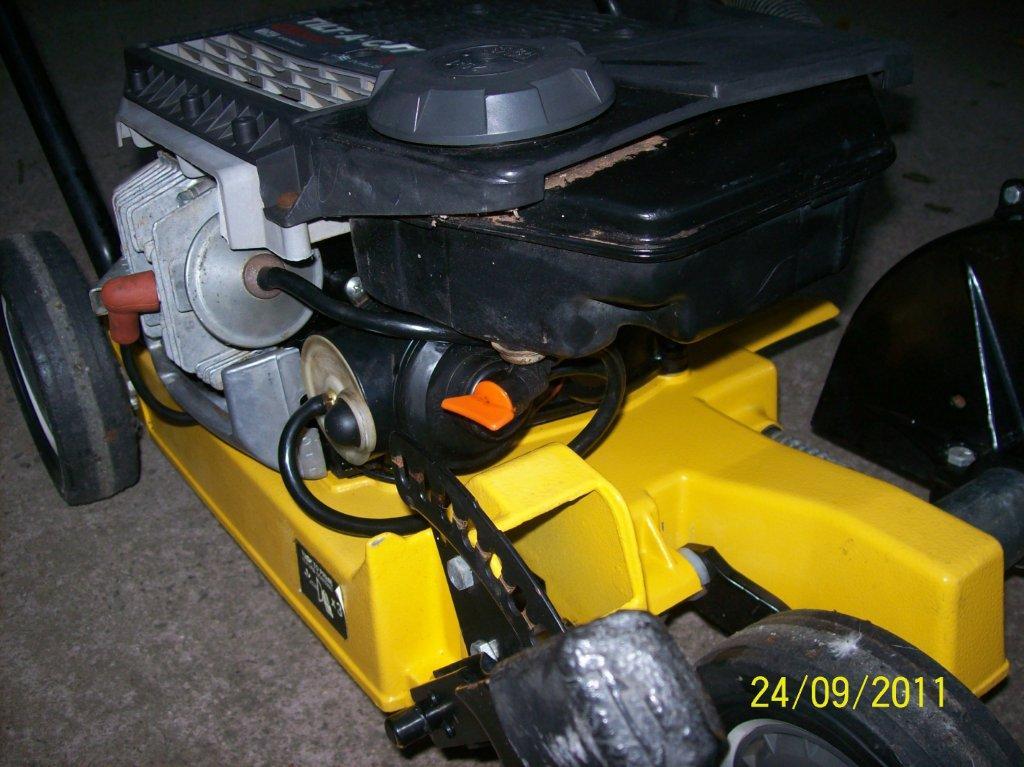

OK have had much success with this lad and very happy with the way it has progressed.Here are some pictures of how good it looks now.It's also now on you-tube here's the link.
Ok and now some pictures.
You will notice that the air hose is still dirty as it's not quite right.I've got some others here I'm going to try tomorrow and if they fit better.Then I will change it over.If not I'll do something with this one and give it a good clean.Same with the top part of the handles it's not quite right.I'm not sure if I will fix the original one or not yet.I'm sure you will agree it does look newer than what it actually is.
