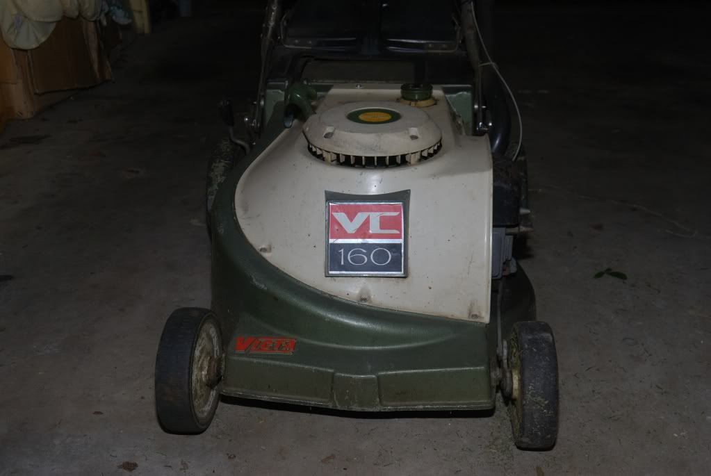

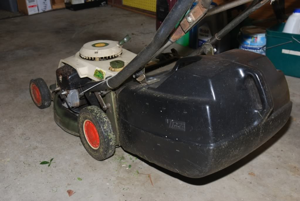

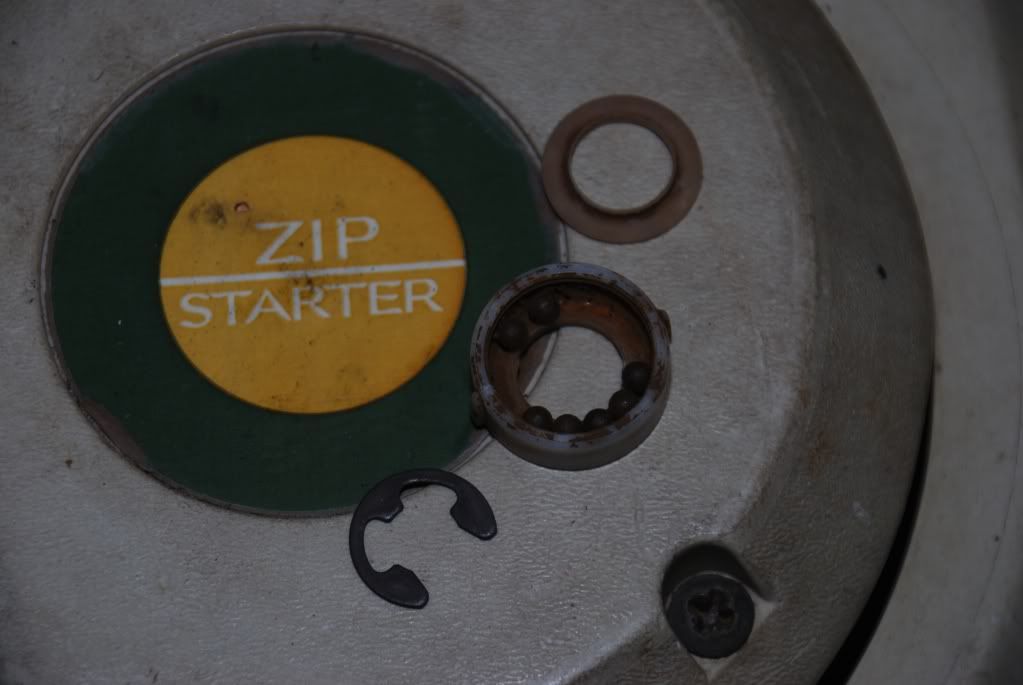

I have a Victa 160, assuming it's a series II, which lost a wheel yesterday while I was mowing. Basically what I need is to replace the cir-clip and bearings in the left-front wheel but noticed on eBay that you can buy bearing modules like those used on skateboards. Would this suffice for my unit?
I'll post pictures of it when I get home.

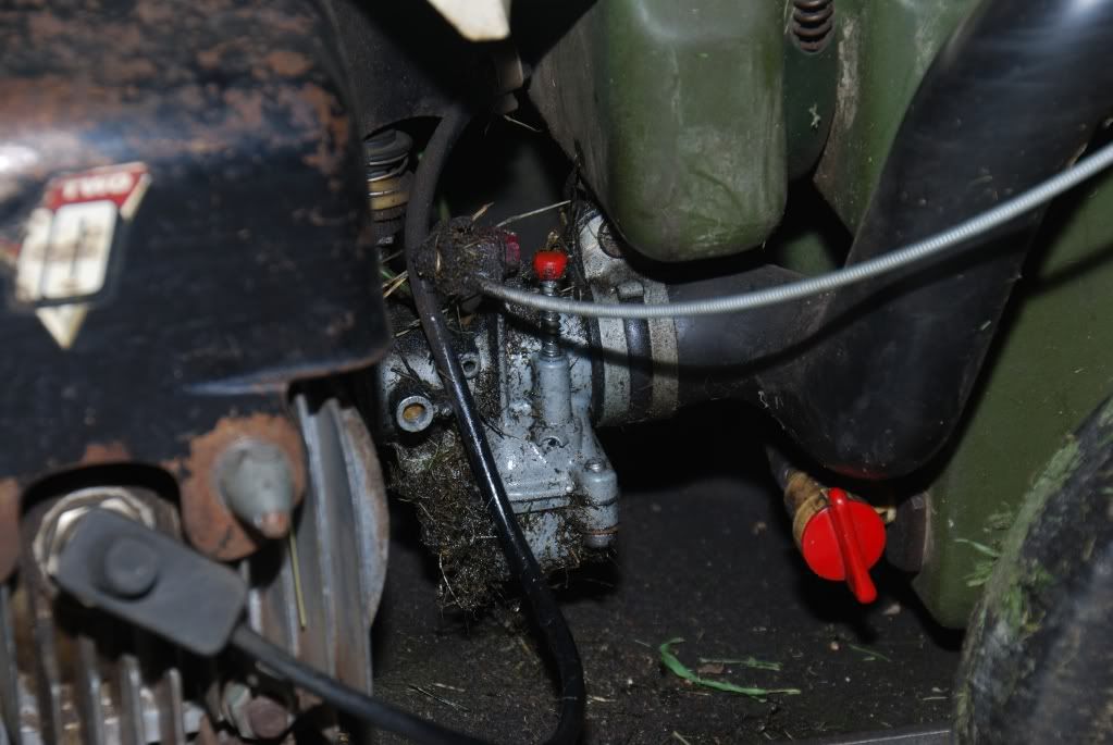

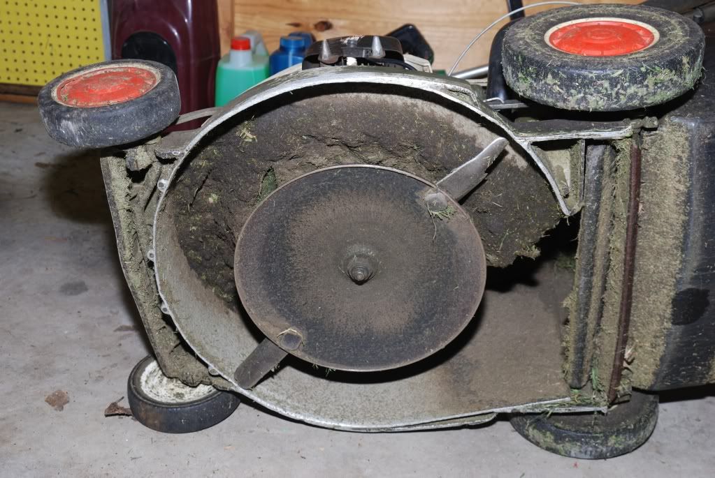

Posts: 3

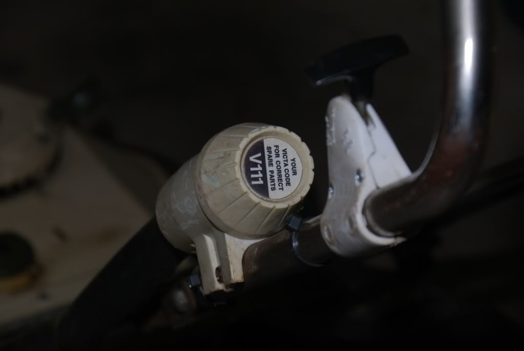

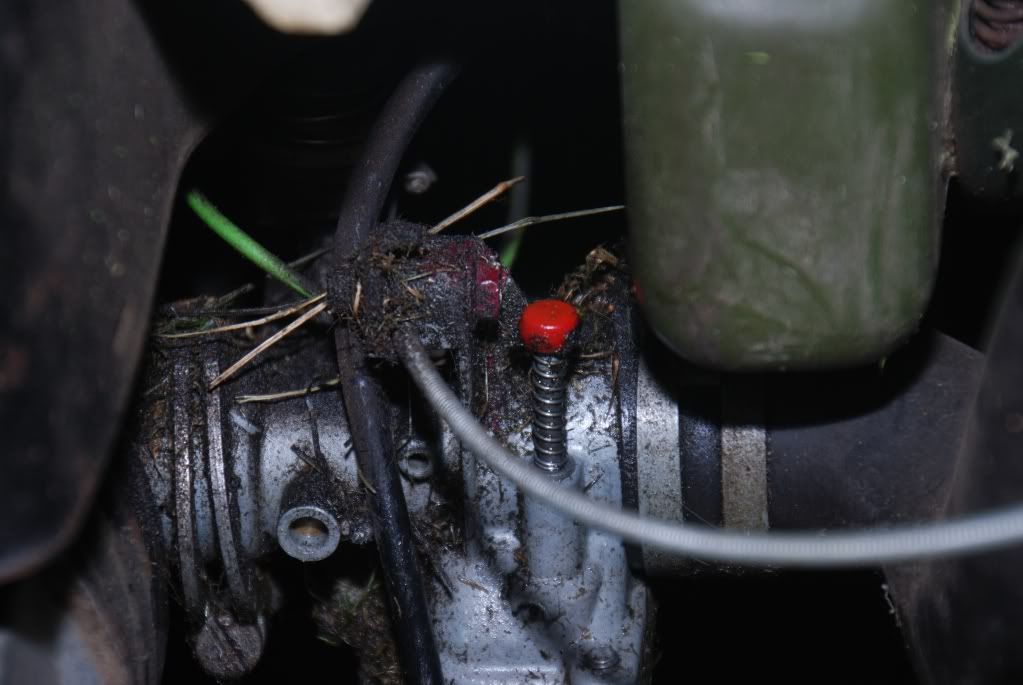

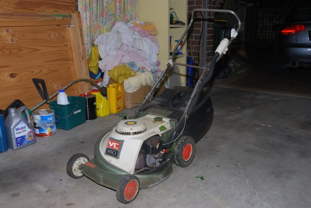

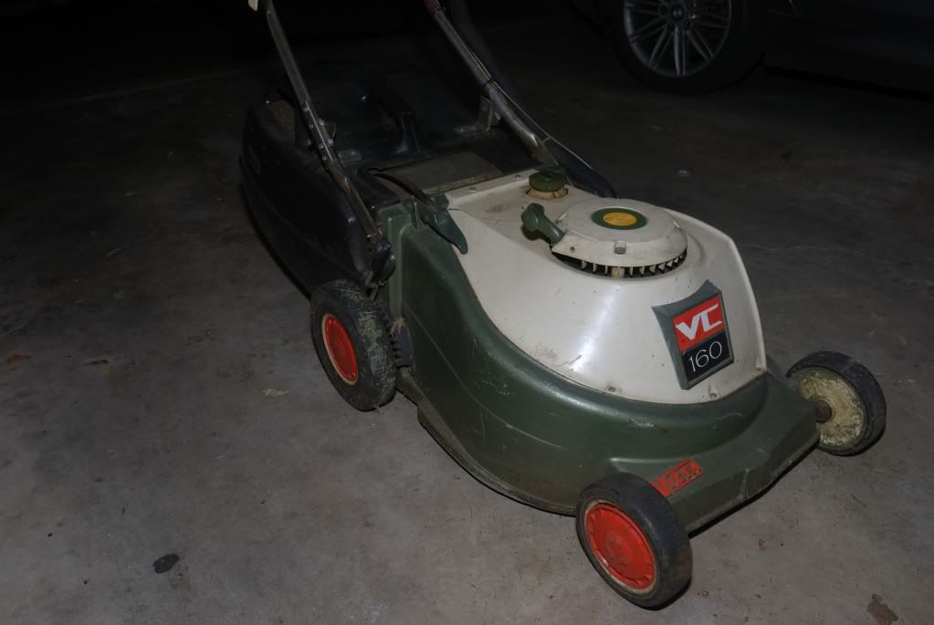

OK, I've got photos now. I think it's a series II unit:
[Linked Image from i36.photobucket.com]

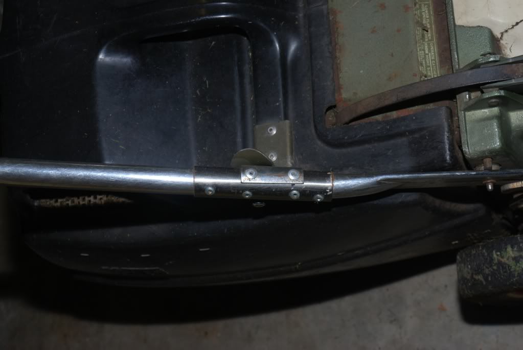

My handle broke one day and my father-in-law fixed it:
And this is the bearing parts which I am looking to replace:
So where's the best place for me to pickup a new bearing unit for the front wheel? Remember that I'm in Melbourne, Australia. Thanks.
I have steel ball race bearings in mine, I cant remember what the bearing size was but I think they would outlast the mower being a solic sealed unit.
Anyway, those plastic ball bearing units should be available from any victa outlet or on our online store here smile
I am not an expert on these but according to your air filter cap it should be a mk3 vc160....

Hi JDMils It is a Mark III.As I can see by the handle bar brackets on the base.I do believe (that's without checking my record.Don't have them with me)your Victa code is correct for a Mark III as well.As for what year,it should be 1972-1973.If you look at the engine number lower crank case half.If it is the original engine.The number should start with 5272 or 5273.You are looking at the 72 or 73.That is the year date.So if it has 72 it would be 1972 and 73 it's 1973.Do you know where you got the throttle cable from?I need some and I'm having trouble finding any.
Just to add to that, Yep, this is a third generation VC-160 (MKIII) with a Series 70 MKII Engine, G3 Carby, and all the original stickers and fittings.
The engine number may not begin with 52, althoug this appears on MKIII's, it seems more common to MKII's & MKI's, however, ther is still a good chance of it being, as Jeffery said, a 52 number, In fact odds are it will be 52720XXXX...
Tha wheel bearing, as Joe mentioned is Very common, any parts store or mower shop can help you there mate.
There is one part missing from your carby, it's not much, just a dust cover plug from the end of the throttle valve shaft. if you look in hte above pic's, there is a raised hole with something brass inside it, that hole should have a small white plastic plug in it, I'll get a photo up for you.
Here you go, it can be seen here, just about where the centreline of the govenor post would cross the centreling of the venturi.
