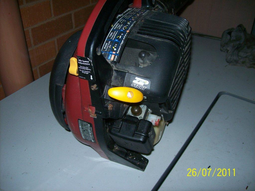

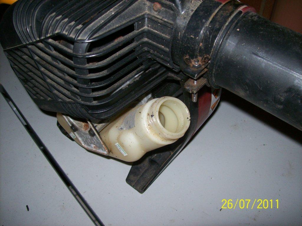

Hi all here are some pictures of my Homelite blower.As you can see it is missing a fuel tank cap.What I would like to know does anybody have one? Does any body know where I can get one from?

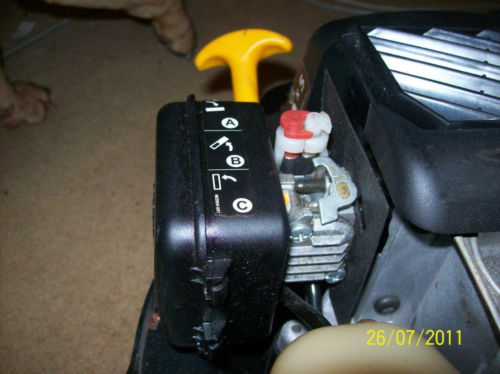

I've taken pictures of the carby here.Only as I have a question.The white and red pieces there,is this part of the choke?So where is the choke lever I can't find it.Does anybody know where it should be? As I really don't think the white & red pieces are the choke.I hope I'm wrong.
Please Help.If the choke is broken how and where do I get the piece and fix it?
Thanks for any help or comments.

You should find something suitable out at Tiny's for the cap.
The White and red adjusters are for adjusting the fuel mix for the high and low rev positions.

id say most whipper snipper caps will fit that one even try an old victa cap for now

[Censored] I was hoping you wouldn't say that about the choke.So now I don't know if the choke is on or off.Does anybody know if it is repairable or not.Are these parts available? Can it run or start without the choke?Victa mower caps don't fit.Does anybody have any pictures of similar chokes? That way I would under stand a bit better as to what it would look like.

i dont have a pic but i think it looks similar to the ryobi little black lever type of choke.
or try turning that yellow part with a screwdriver the part should be replaceable though maybe have to order from the USA im pretty sure they are an american brand although probably made in china

quick fix for cap only to test if it will run could be plastic sheet with tiny hole taped over where the cap should be at least then it will hold fuel and you know if it will start

Thanks drjbeam I didn't think of that with the choke.Cool now I know it is off.Thanks for the link to the manual.I now have that.Not sure if I will ever find the lever,but I should be able to work it without that now.Will have to find a fuel cap from somewhere but I'm sure I will work that out as well.

You might try putting a spoonful of fuel in through the spark plug hole and trying to start it. Those small two strokes are sufficiently difficult to start without a dysfunctional choke and a questionable fuel tank cap. If fuel in the plughole results in it running briefly then stopping, you can focus on the fuel system and carburetor.
Some of those fuel tanks use a vented cap with a one-way vent, and some use a hose-type tank vent. What kind of cap you need depends on which system it has.
