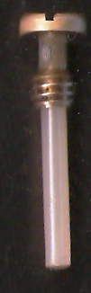

So when the main jet comes out.With the G4 the tube comes out with it? Is that right?Where as the LM won't? Am I getting the right idea? I hope I am.Cause if I am I will bring it in from the shed in a minute and have a look.
That's right
For the G4, the tube fits firmly in the end of the jet screw, and should come out with the screw.
For the LM, the tube fits over the tip of the jet screw, but is fixed inside the carburetor, and will not come out with the screw (it cannot be removed from inside the carburetor, it is still white however, and you can see it in there.
If you are unsure whats going on once you get it apart, photograph what you see (plus this glue business) and i can tell you more.

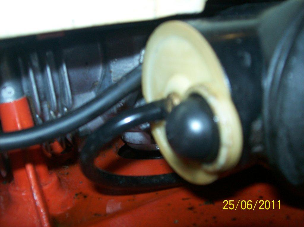

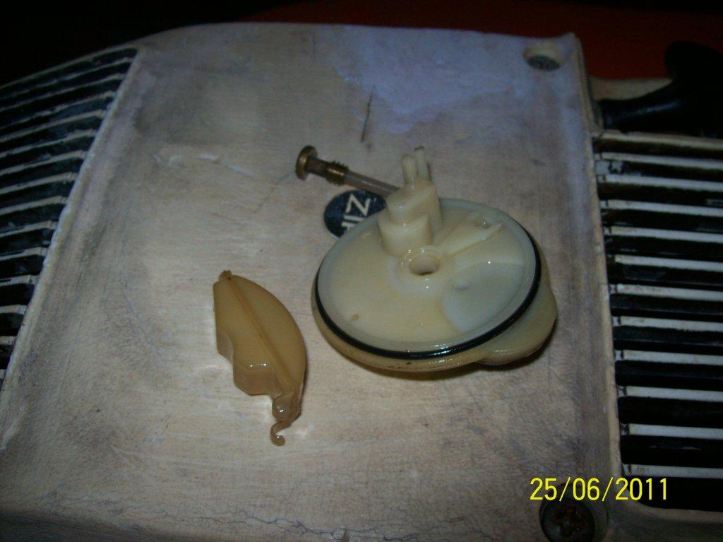

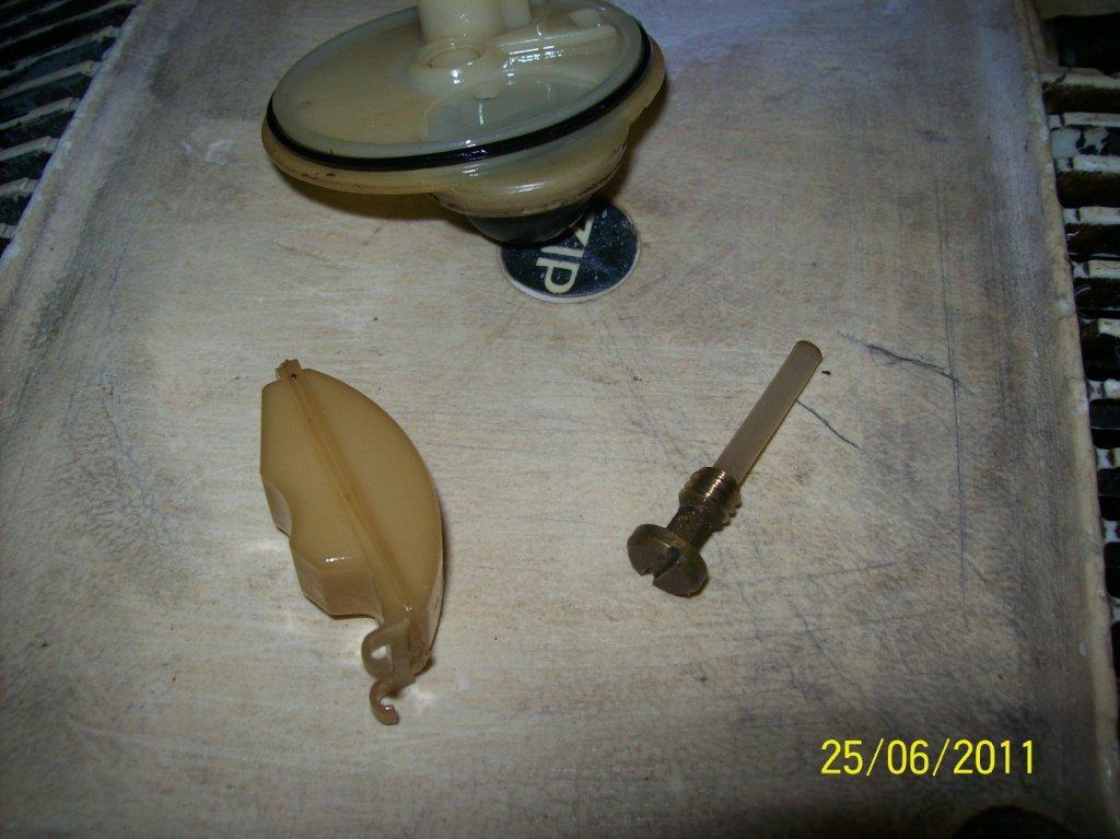

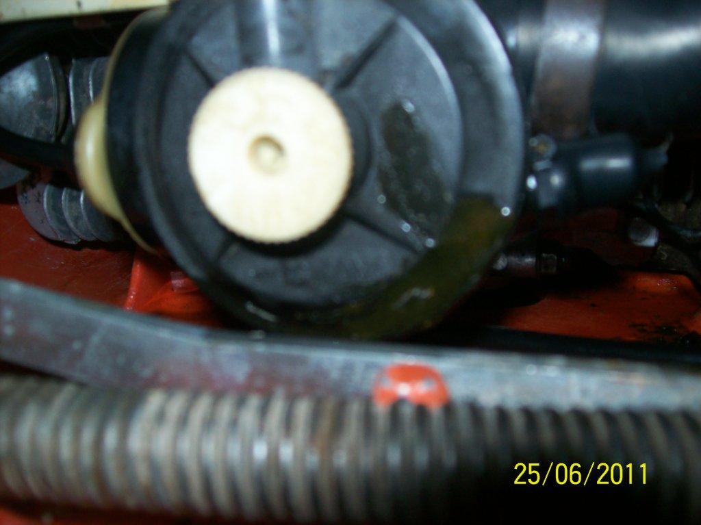

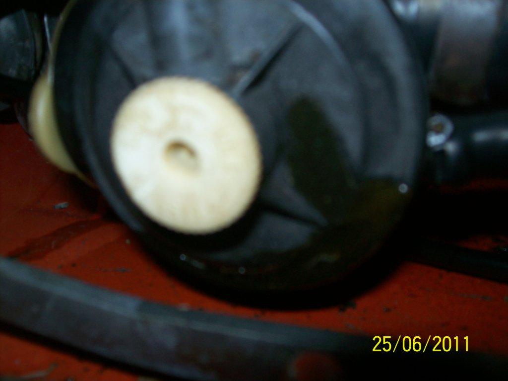

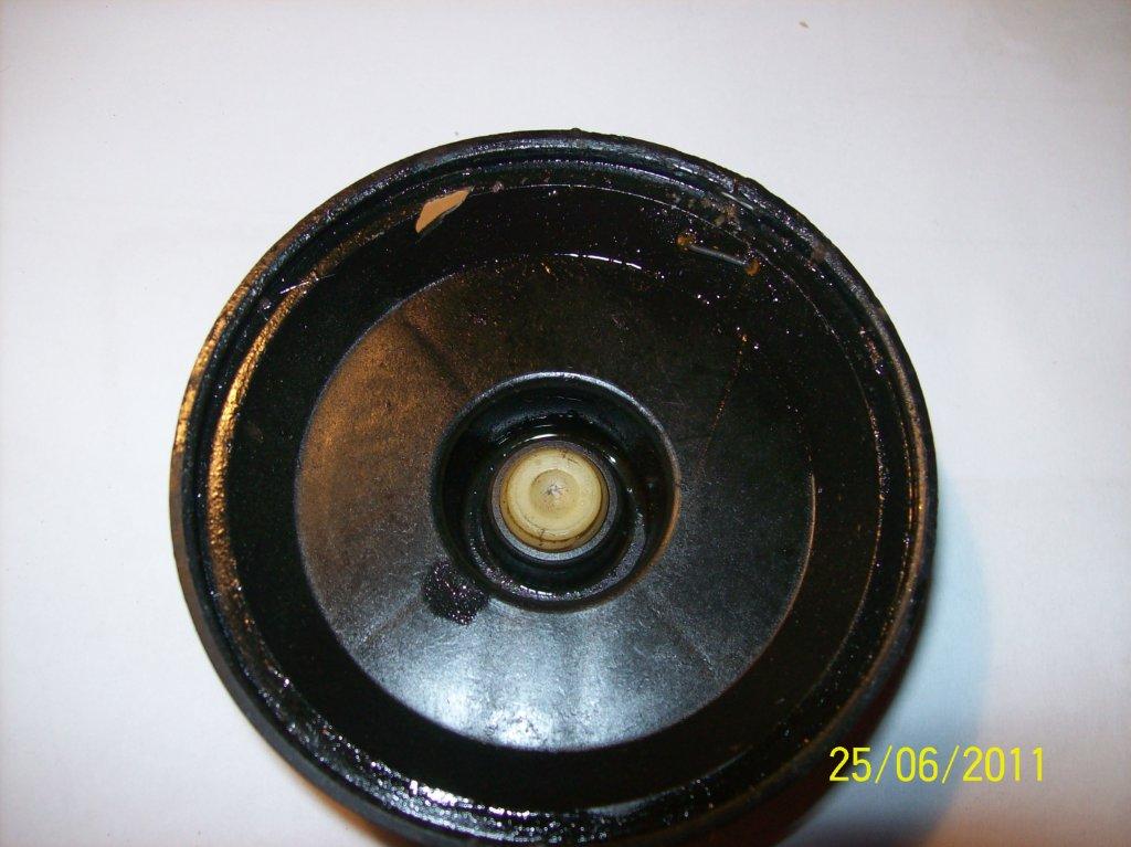

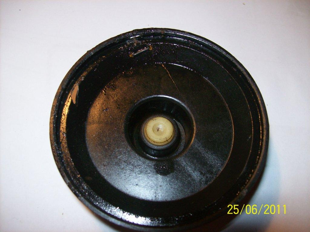

Ok have done that it is a G4 carby.Has the tube on the back that comes out. [Linked Image]
The first picture of the carby is a bit fuzzy,but the bit that looks like oil is the glue.You can see it better in other pictures.I just added the last 2 to show the screw.
OK, looks like the cap has cracked and been glued up.
Can the cap still be levered off with a flat head screw driver (watch out, there's a spring under the cap that may try to run away!)
[Censored] not good.Yes it did come off.After it came off I could see that there is a hole in the cap as well as a crack from the centre going to the outside. [Linked Image]
You can see the crack in the last photo.
Yep, that ones stuffed, however, chances are, if you clean out any dust and dirt from inside the carby, and pop another can in place, it will be good to go. (Keep the big white plastic screw)
I don't think the diaphragm is any good on it either.It's sitting with one part flopping down.I bet it has a hole in it to.It looks bad.
might just be out of place, as you clean it out you should be able to work it out, its not common for them to get holes. the caps however are often cracked
