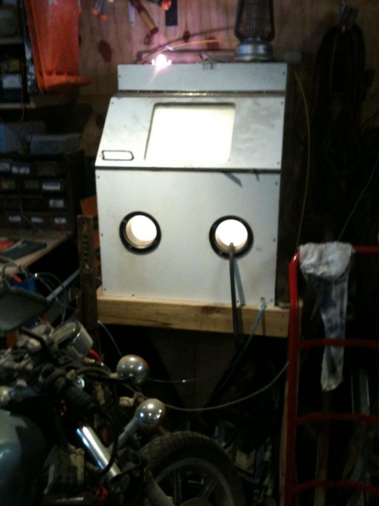

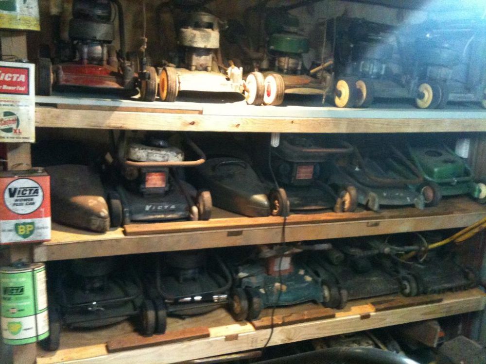

hi , just a quick post of the mowers in the garage.

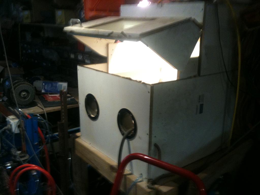

the second picture is my home made sand blaster which is big enough to fit a mower base into that all my resto's get cleaned up with before priming and paint as per pic 3 (waiting on warmer weather to paint)

Nice collection Steve,
I like your home made blast cabnet, I am making one up out of an old heater oil tank at the moment. What blasting tip / blaster & grit are you using?

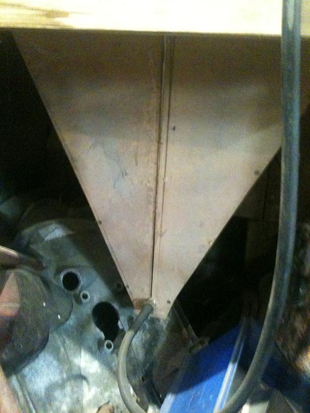

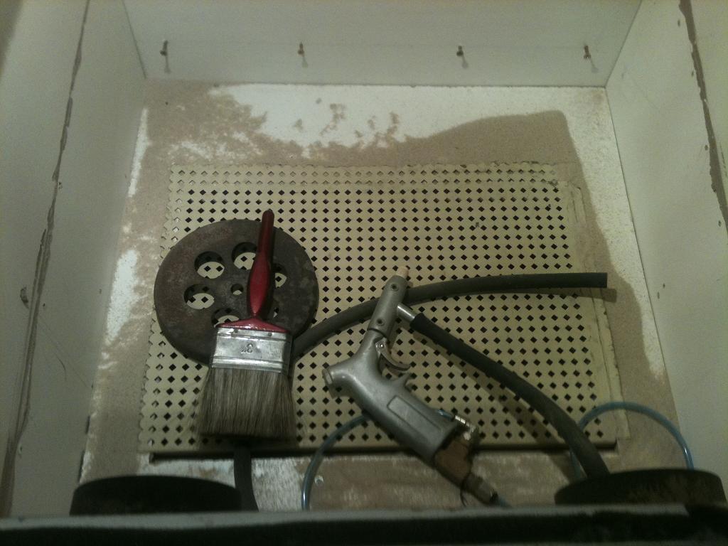

i bought a sand blasting gun from alltools for $22,i used ordinary washed garden sand (filtered through fly wire)to clean up most of the old dirty paint and grime,then i change it to glass for a smooth finish.when i built the cabinet,i made so it has a bung to drain and clean out the sand (it takes around 2 minutes),inside i have 3 layers of course to fine mesh to catch all the chunks.i use a cheap kingchrome vacuum to extract all the dust.it is heavy on air use so i have 2 x 85 litre air tanks as a reserve when i use it

Nice collection of mowers Steve would like to see some closer picture of each mower.Anyway what sort of things would I need to make up that sand blaster box.That is exactly what I need,but I would have no idea how to or what I would need to make one.Did you have some sort of plan of how you made it?I would love to make one for myself.Would make it a lot easier to take the paint of my restores.

no plans,measured a victa 18 base,made the main box to be able to rotate it inside,piano hinge for the top and side door,got an old window from the wreckers,a couple of old down lights,the wire mesh for the filters was from the scrap metal yard,melamine from old kitchen cupboards.
all up for the cabinet including the gun ($22 from all tools with hose and spare tips)cost was around $50
garden sand $5 a bag from nursery,the dearest part was the proper bag of blasting glass about $40
i did make a lot of mistakes,this is what i found to work.
there are cheap sand blasting cabinet available at the tool shops starting for around $250,if i spent that the wife would kill me so i had to make one over time to hide i was spending more money on mowers

I like your method of keeping the costs descreet steve, lets all hope your wife never decides to read this! (I imagine if my missus tried, she would be bored after a couple of posts, engines are not really were her intrest lie!)

Can you take some more pictures of it? I think I'm going to give it a go.Would certainly be a better way.So where do you get the sand? I have tried getting sand but nobody that I have talked to can get me any.

the v shape collector has an angle piece in the back to send all the sand to the pick up,
the cabinet is 600 x 600 square,the height is 600 also,the gun hose goes through the side normally,i had to blast some trailer rims(rims with tires don't fit)so it was not put back properly yet,i use industrial cleaning gloves through the holes in the front held on with big hose clamps.
the only change i would still make is to angle the base so i don't get a build up in the cabinet
