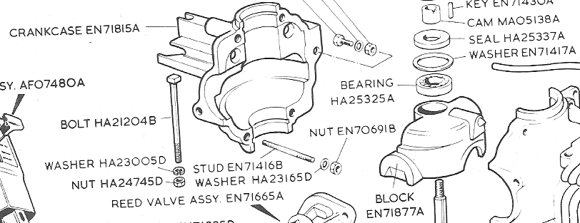

Hi Bob,
No, the twin engine is actually bolted to the base by the Cylinders, with the Crank Case supported between. This is because the Muffler is entirely underneath the base, and the Exhaust ports need to be firmly mounted to the base to seal the passage through for burnt gases.
The Lightweight has a similar set up, but in its case the front end of the case that replaces the second cylinder has protrusions for mounting at this end.
Heres a few pics: [Linked Image]
Heres the crankcase end for the lightweight:
Thanks Ty
Reason i was asking as i was thinking of having a go at taking the electric motor off the base and fitting it on an 18" base.
I wont ever find a catcher for it so put it on something with a catcher.
I see Reed valve there in the last pic. At 85cc with a reed valve it should have gone OK on a 16" base. The twin would have a bit of poke too.
Bob.
Yep, the twin and lightweight had the carby direct to the crank case with the reed valve, the only victa 2-stroke engines i know of that did not have it through the cylinder.
What mounts does the electric engine have?
Heres the rest of that picture: [Linked Image]
I think the electric bases are slightly different mounting to the compact victa engine, I cannot be certain but I do remember hat the base was no good to me but the catcher and everything else attached to the base was....
Thanks Joe. I will check it out.
That picture makes me wonder if a bloke got one of those reed valve assemblies if it could be made to fit on a series 80.

Rodeobob,
considering that there is a G4/LM carby over that reed valve
i would bet it has the same size mounting base as the cylinder mounted intake manifold
so it would fit for sure
Cheers, Emmo
is it beer-o-clock yet
Nah the reed valve is part of the inlet manifold I used to have a apare one but it would be way too big to fit over the port of the series 80...
Im sure if i put the cylinder in a mill and machined it flat i could get it to work.
Thats if i could be bothered and i probably couldnt.
