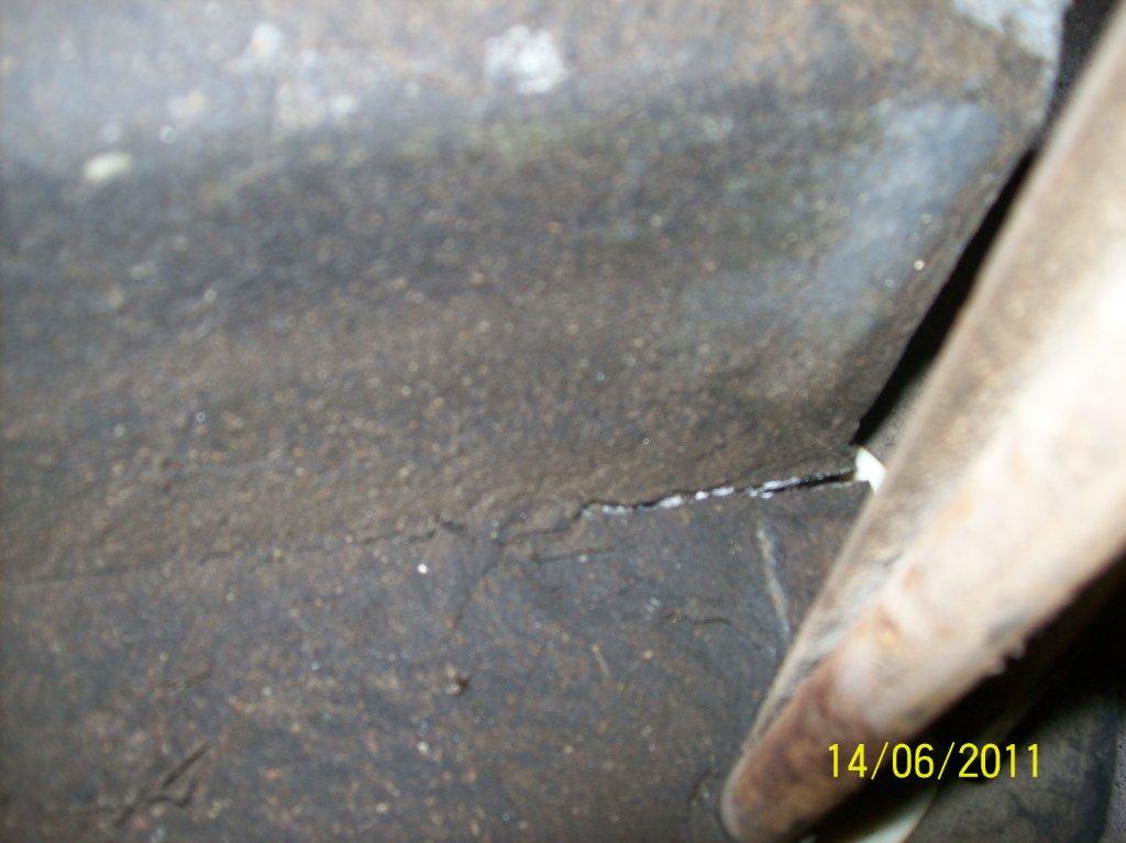

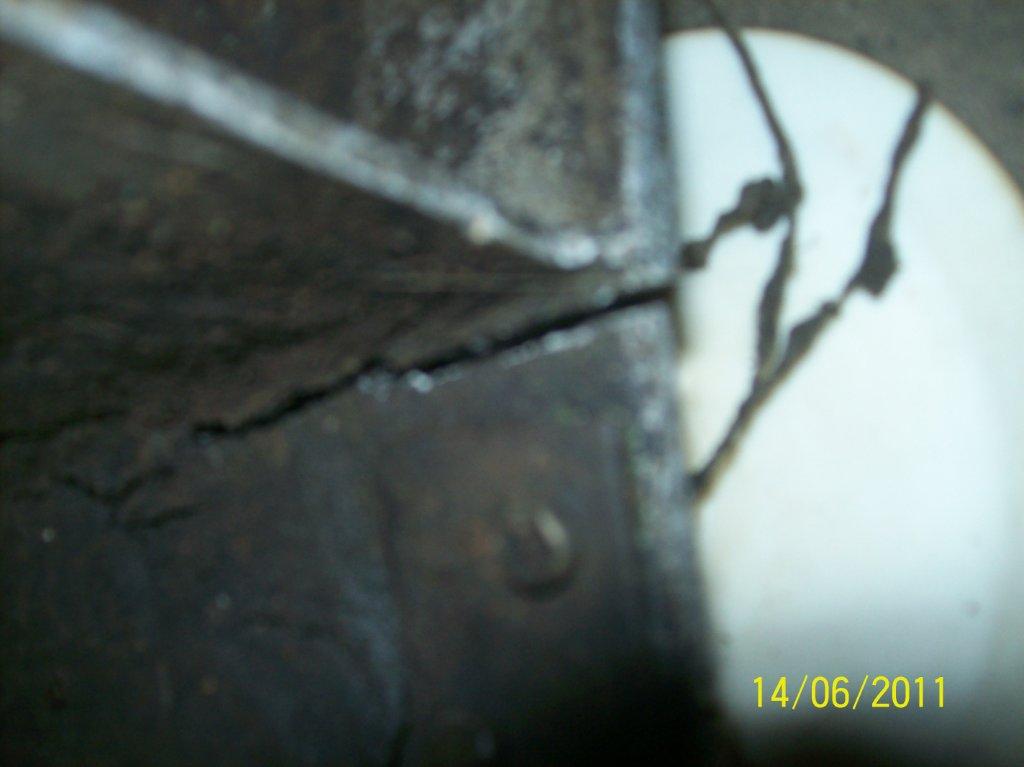

As for the base, yeah, not looking too good, i stripped down 4 of these over the weekend, i think a few of the bases are good (i know one is buggered) if i have a good on, how does $10 sound for that, with axles & wheels.
If i do have a starter odds are it will need a little oil and a good service, but if theres one to suit here, you can have it, so don't worry about bidding on this one.
Thanks man sounds good I'll keep my fingers crossed about the base.I just don't think this one is worth it.Maybe if it just had a crack I would get it welded,but it's not only cracked but you can see that it is bent out of shape.Don't worry I won't be buying the starter I just feel that it is just to expensive.
Ok, so i have indeed a good base, it may need the catch flap swaped over, but the axles are sound, and the base is good.

Hi Ty sorry for taking a while to get back to you.Besides the the base,axles and the other bits that we already discussed the only other things that I can find that I need.Is the two front wheels are not in good condition,one of the plastic clips that holds the cowl on is missing.As well as the other VC is missing one.You were right there is no depression value.So it must be a mark 1.Good that's what I wanted.So I guess I'll see what other goodies you have and then we will work it out from there.

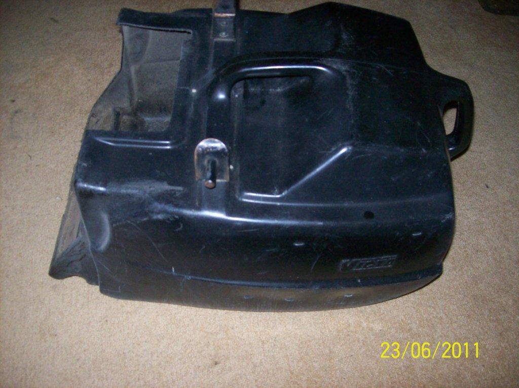

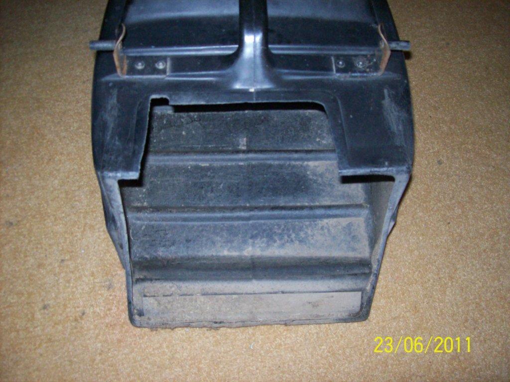

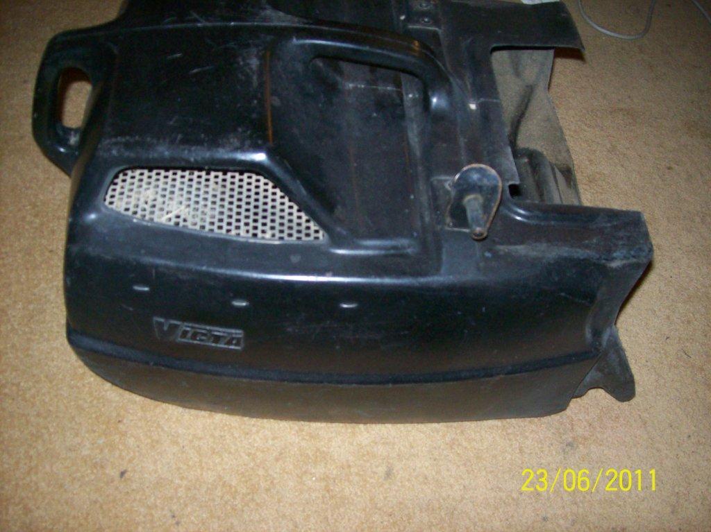

Picked up another really good catcher today.Don't know what it is off.It does fit the VC,but it doesn't have the fill indicator and you will see on the top where the back flap goes it has a cut out.What I want to know is what is is Of?Is it for a VC? I'm thinking very seriously about cutting the fill indicator piece out.If I do.Do you (Ty that is) have the flap piece? I have the bottom piece that fastens to the catcher but won't have a spare flappy bit. [Linked Image]
DON'T CUT THAT HOLE!!!!
I'm fairly sure this is an original VC-125 catcher, it lacked a number of VC-160 features (Multi Height handle, Large rear wheels, etc.) Including the fill indicator.
Due to damage, alterations, and the fact that is's an uncommon mower, the catcher, in good nick, without the eye, is quite hard to come by!!!
Oh I see.Thanks as I wasn't really looking forward to cutting the hole.Do you really think it's a VC-125 catcher?
I cant say for sure, but it is only able to fit a VC-125 or VC-160, its black (Earlier) and the only ones without indicators were the early VC-125's (1971) and the replacement catcher.
So it is either a 1971 VC-125 catcher, or the replacement catcher sold in the late 70's early 80's as a spare part for the VC-160, after production of the mower had ceased.
It could be either (More likely the latter) but they are the same, so this is what you would need to do an original 1971 VC-125.
