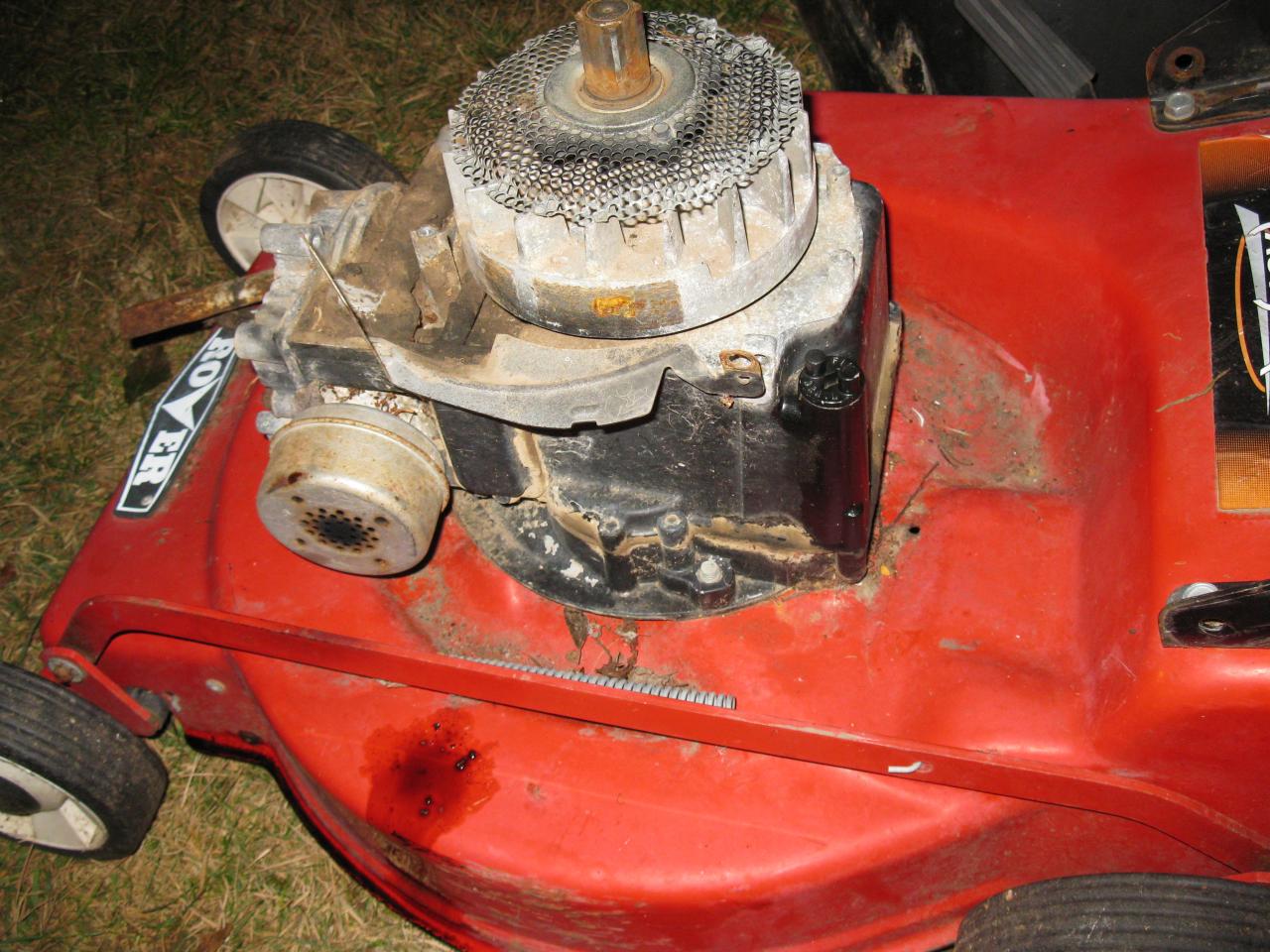

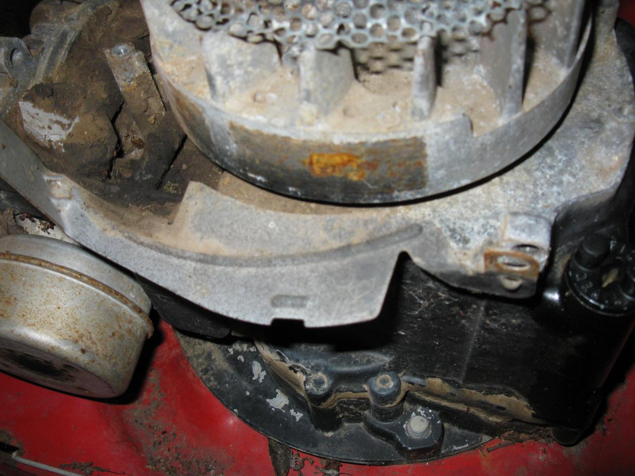

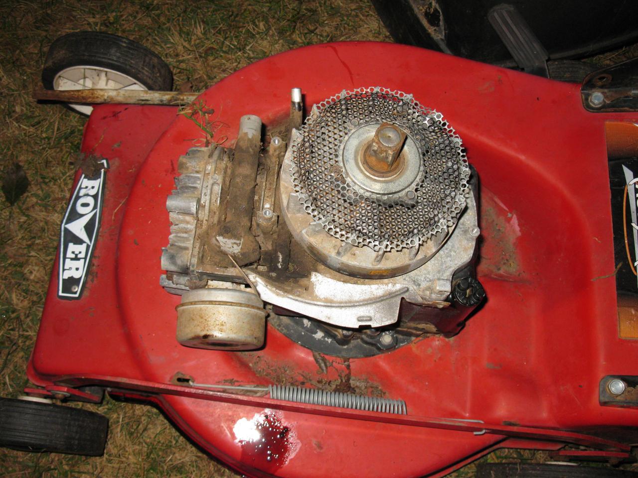

Ok, so i picked up this on (for nothing) still assessing wether what i have is worth keeping, but what am i looking at here?
All i know it its brigs, mostly stripped, on a base that i peg as mid to late 90's (though thats just a guess) can anyone work out anything about this engine, or tell me what markings might help ID it?
Plastic inlet or metal into alloy.
Looks like a classic 3.5
Post type sprag starter and provision for the bail bar brake at the back.
Old type 3.5 carb, an electronic coil and a starter off an old 3 or 3.5Hp and that will go. Well it will, id be ripping the head off and checking the bore out before making the call on throwing it.
Compare the head gasket to see if its not a 92 or 95. 10 series is a different bolt pattern.
Bob.
I'll check out the bore and have a look at the inlet and see what i find out...

You have a whole lot of points in that last post I didn't know, Bob, and I think they will be useful for a lot of members in the future. If you have more information like that, especially with pictures, the archive value of this thread will be further increased.
I was going to put my money on it being a quattro40 engine, I have the same mower base here, from memory it is very late 90's Ill check it out this arvo.
What joe said. Thats highly likely, the more i look the more it looks like a plastic inlet. The head gasket will tell the story.
Bottom of the head on the side we can see might be the give away but ive got nothing to compare it too.

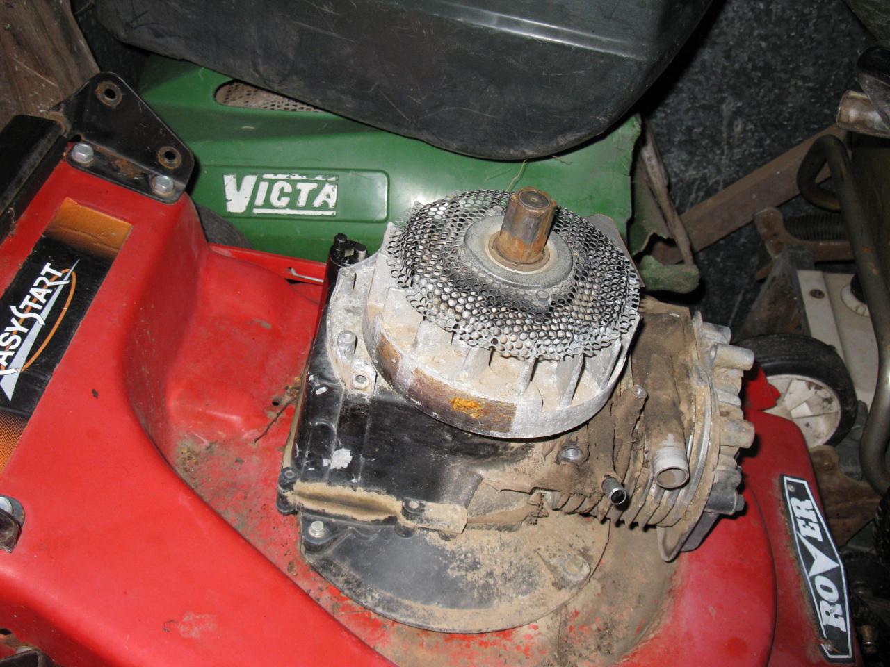

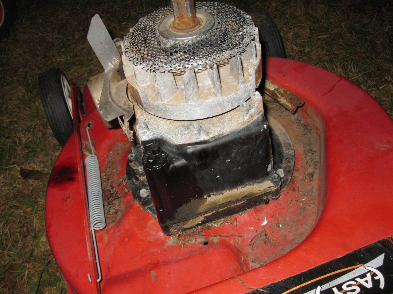

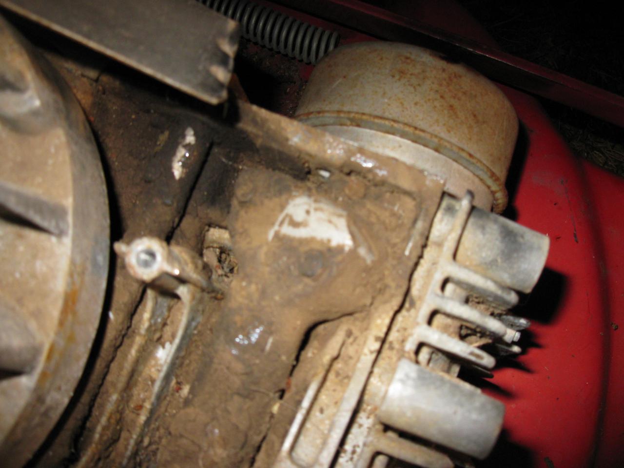

I'll check out the gasket and inlet, and get a couple more pictures too.
Plastic Inlet, Havent got to the gasket yet, heres a few more pics;
Im thinking its a 3.5 classic.
Didnt pay enough attention to the quattros ive fixed to notice if they were post and sprag clutch starters. I thought they had the cup type.
If you get it to the point of putting missing bits back on and running it, you need the curved vane on it with that baffle plate

come to think f it now I would be leaninf the classic 3.5 or very early sprint 375 as well. While the quattro motors did have both types of starters they mostly had the rectangular mufflers...
