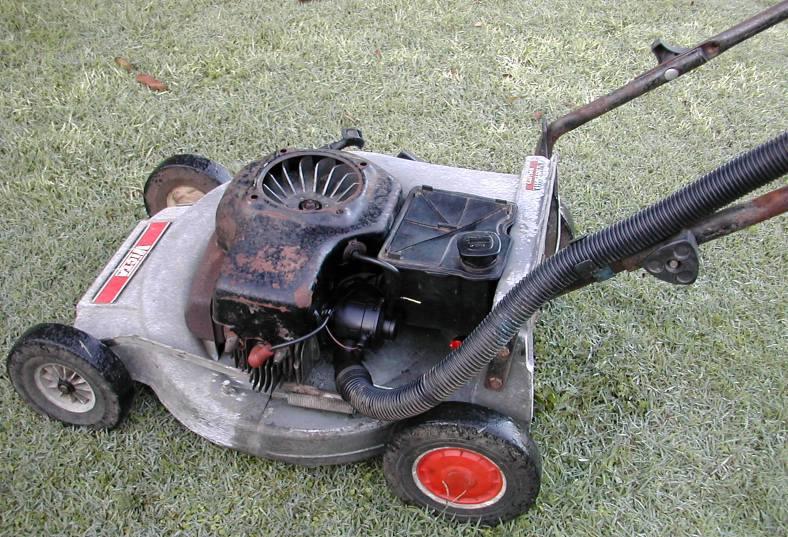

Hello
I am about to change rings on a 125cc 2 stroke engine off a victa utility.
The reason I am doing this is because it was blowing alot of smoke.
I havnt done this before and am treading carefully.
I have read through some of the threads and have half a clue.
At this stage I want to be sure I get the order of the rings right and the gaps in the right location.
Any help would be much appreciated.
Thanks
Mark

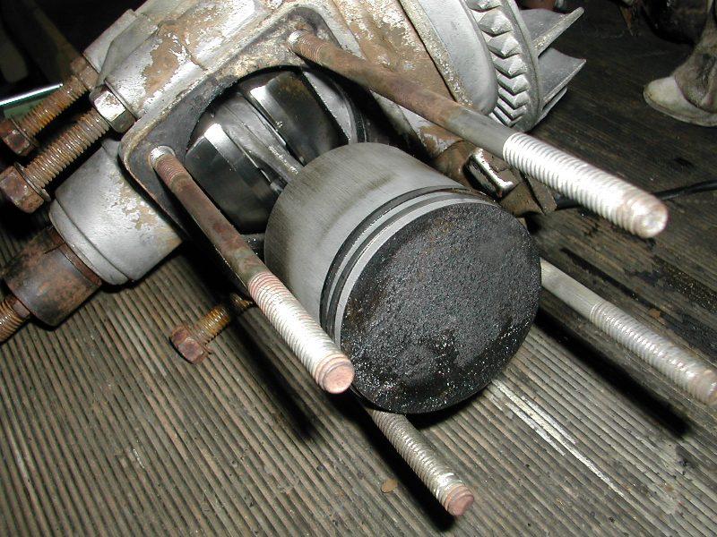

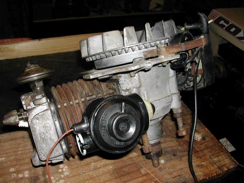

Thanks for the reply Grumpy. I tried to upload a photo.
Smoke from exhaust was excessive.
1.fuel mix 25:1 and fresh
2.yes, muffler was choked up at outlet----clean now
Will put engine oil in cylinder and test and check for scoring.
Let me get to it and I will let you know how I get on.
Thanks much
Mark[Linked Image]

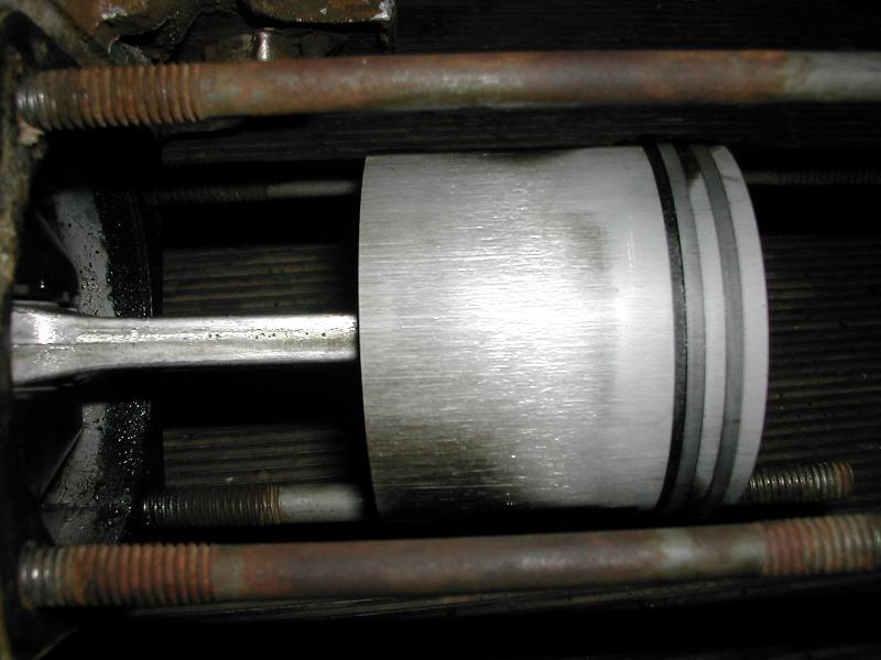

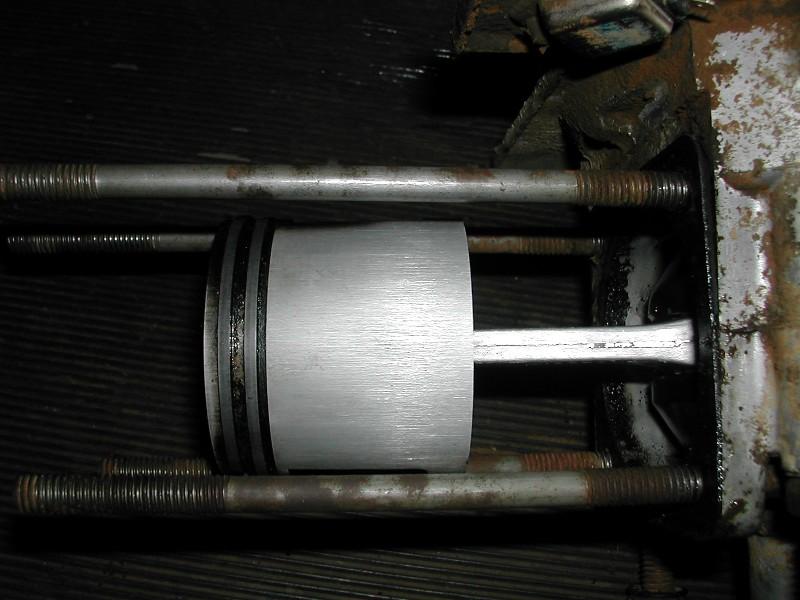

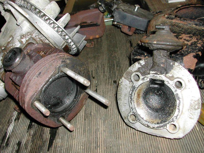

Hello again
How does this piston look?
It looks pretty good - those scratches seem to be superficial. How was the compression?
Joined: Feb 2011
Posts: 510
I didnt put it back together to test the compression Grumpy.
Yes, I couldnt feel any scratches with my fingernail.

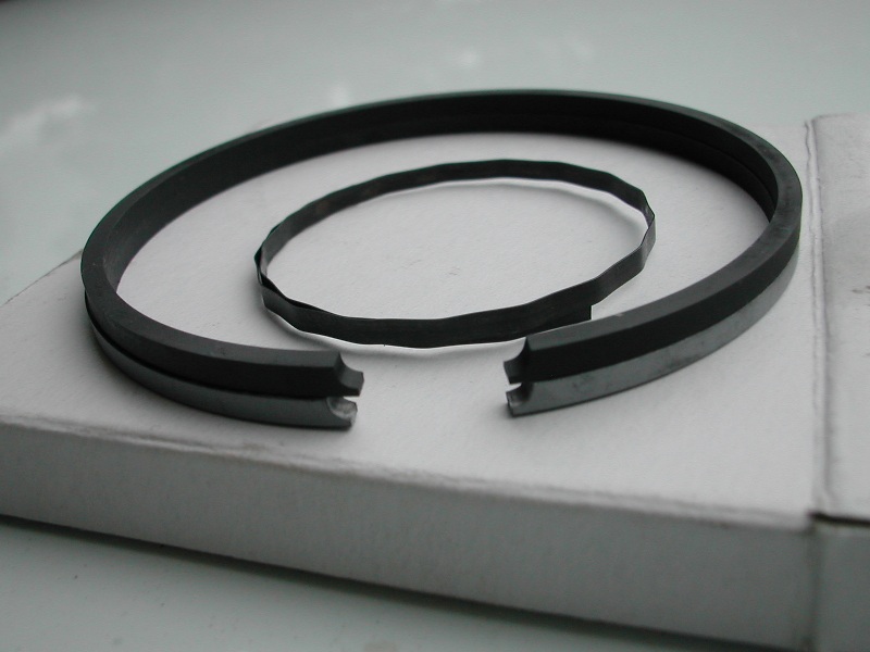

I have purchased 2 sets of rings (125cc & 160cc)
each kit has a grey,black & wavey coiled up ring. Im not sure why they are different colours and what the wavey one is for.
To date, I have struggled to tell the difference between the 2 sized motors.
The 160 cc Powertorque is 61.5 mm bore, 54 mm stroke. If your stroke is 54 mm it's 160 cc - same bore and stroke means same capacity, regardless of construction.
It might help if you post pictures of the rings.

Now I have noticed a wave type ring under the bottom ring(closest to piston skirt)
Just have to find out which ring goes in the top groove (crown end) grey or black.
They are the same size.
The wavy thing is a ring expander: it increases the contact pressure between the lower ring and the cylinder bore, to scrape oil off the bore. This makes the lower ring function partly as an oil ring. With an expander under it I doubt you can compress the ring with your fingers - you are likely to need to make a sheet metal ring compressor.
Check whether the rings are exactly the same width. Then see if they are exactly the same depth (one needs to have room under it for the expander). If they are the same dimensions, you'll need to find out which is which from instructions or from someone who knows.

Sounds like it's time to put it back together then, mark. Please keep us posted - especially on whether the compression feels different after installing the new rings.

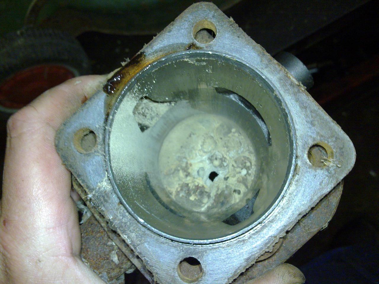

Mark, perhaps you should have pluged up the decompressor hole with an old spark plug and tried that.
Never mind, you know what youve got now and its not bank breaking.
I hear what you are saying. I like buying the old full cranks. They are a good thing. I fix up the good ones, some get 4 stroke or Power torque motors on them, then the motors get sorted and put on utilitys or alloy bases with dead motors. Ive fixed up a couple and put them on Super 24's.
I sold a full crank the other day to a couple of american lassies. An orange one. Carb clean out and away it went, new filter and plug and a fresh pair of blades for good measure.
Ive another in the back shed thats got a fair bit of surface rust, its the $100 special to entice an up sell, if only they knew i had it out the front testing it, i set it on eat dirt and i couldnt push it fast enough to get it to stall out.
I have a sabre thats nothing special, all the shine is gone, but its complete, nothing broken, im going to have a hard time parting with it.

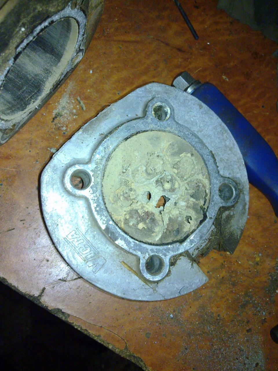

Could have been a real curly one this one, had i got the carb back on and put fresh fuel in it. I spotted it by pure accident when i was checking spark while doing the pins on the carb.
Well, the cylinder head looks broken. How were the piston and connecting rod?
All good.
Pulled the rings off the piston, washed it. Put the rings back on.
The head and cyl cleaned up and put it back together.
Started first pull and runs sweet.
Lesson being, dont leave a mower lying about with out a spark plug in it if you live in an area infested with european wasps.
Bob.
