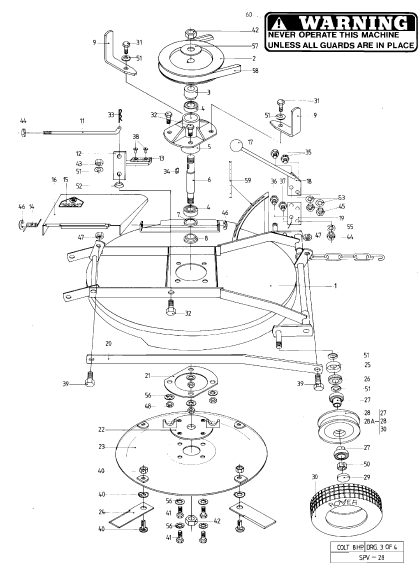

Hi folks, newbie here,I am in the process of restoring an old colt 5, the cutter spindle was dismantled, I have the new bearings but how are they loaded up. there are several spacers and shims.

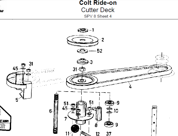

Hi Ray, welcome to Outdoorking. I haven't found a Colt 73113. I have found a Colt 7313 though. Here is how its cutter spindle goes together:
It looks to me as if the sleeve 8 goes over the shaft 6, a shim goes on each end of the sleeve, then the bearings go on from both ends to bear against the shims. See if the diagram matches the parts you have, and let us know.

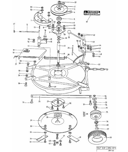

We do not seem to have a parts list for a mower with that model number. This is from the only other Colt 5 parts list we have:
This is the version from the Colt 5-8 Owner Manual:
Those are all we have. I'm told Colts are particularly difficult to document due to multiple versions existing.
