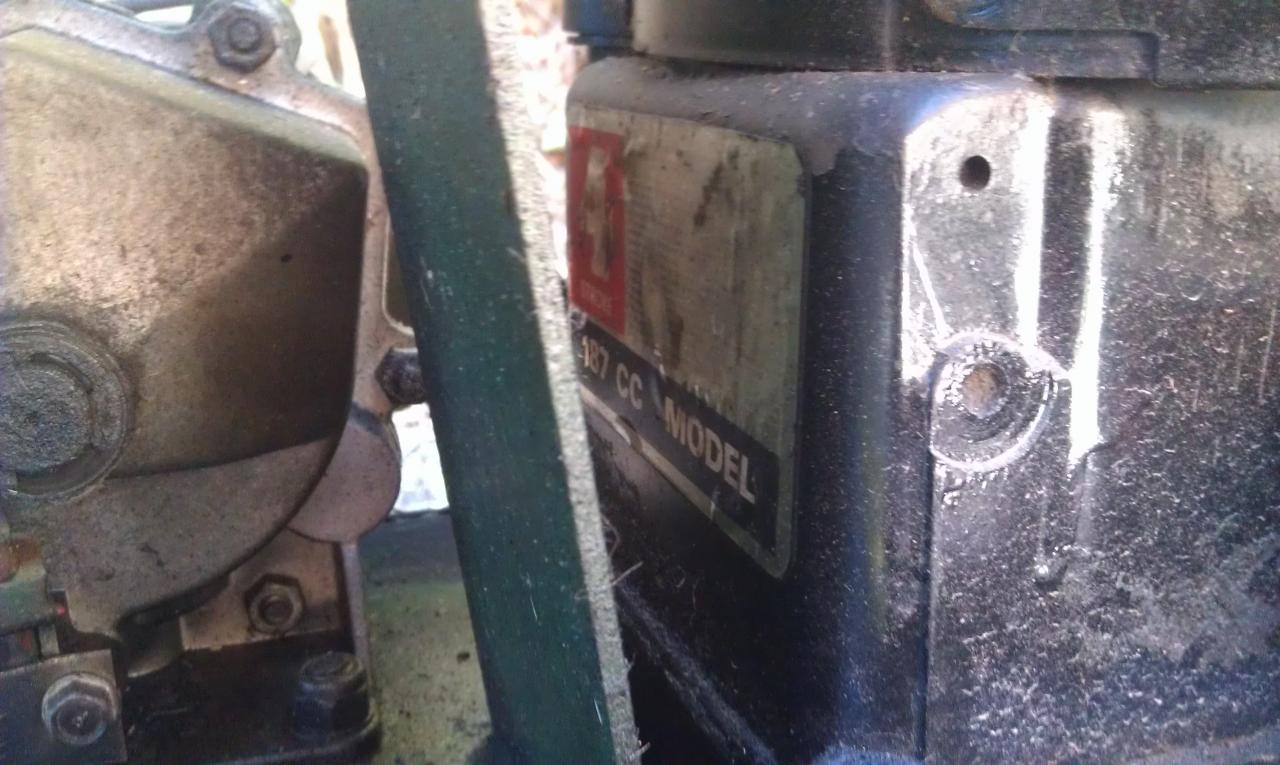

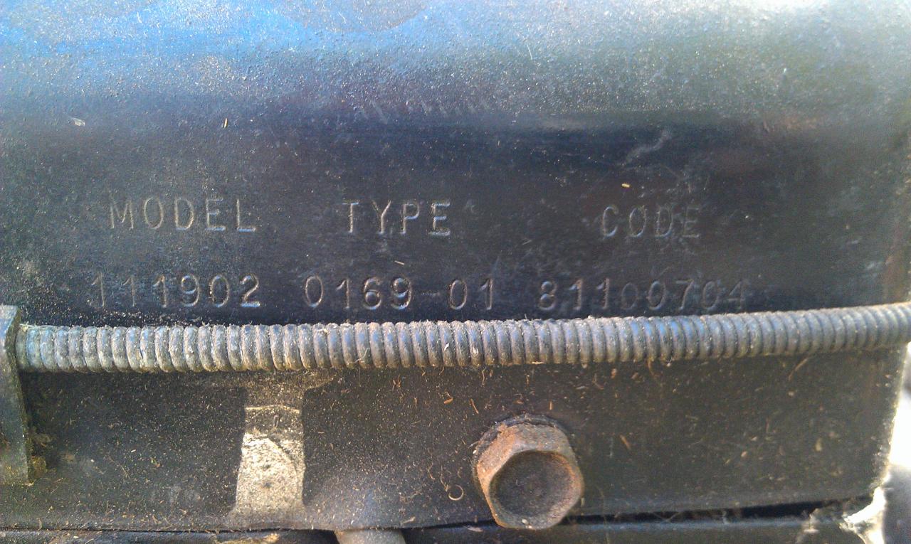

some images of the mower ,still confused scott bonner stickers all over it and rover id badge,seams to be push pedal to engage drive/ release brake which is missing return spring ive looked at the manuals for the colt 5,8,7-3 ,i can see a spring but not exactly where it connecets to a photo of this part would be awesome if anyone has one
The mower appears to be a Colt 5, Model 72721, with an 11 cubic inch, second design generation, vertical crankshaft Briggs and Stratton engine with a Pulsa-Jet carburetor, plain main bearings and a rewind starter. The engine was manufactured on 7 October, 1981. (The mower was probably made a few months later than that.) I have no idea why it had Scott Bonnar badging as well as Rover, but SB was a subsidiary of Rover by then.
Hi brisy, well the ID Plate confirms it, it is a Rover and that combined with the manufacture date of the Briggs and Stratton, which is 7th October 1981 means that Scott Bonnar had been merged into Rover Australia LTD by that date. They were then known for a time as Rover-Scott Bonnar.
As I stated earlier, my belief is that Scott Bonnar did not have ride-ons as part of their line-up at any stage, prior to the take-over by Rover.
In my opinion, your machine is a Rover Colt 5, Model 72721, manufactured by Rover-Scott Bonnar in late 1981 early '82. wink

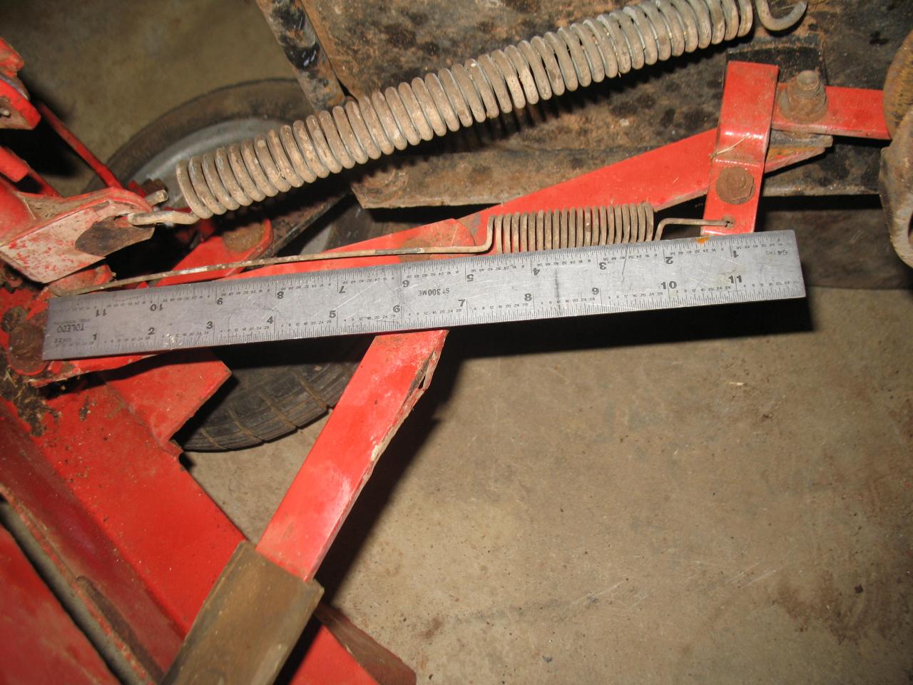

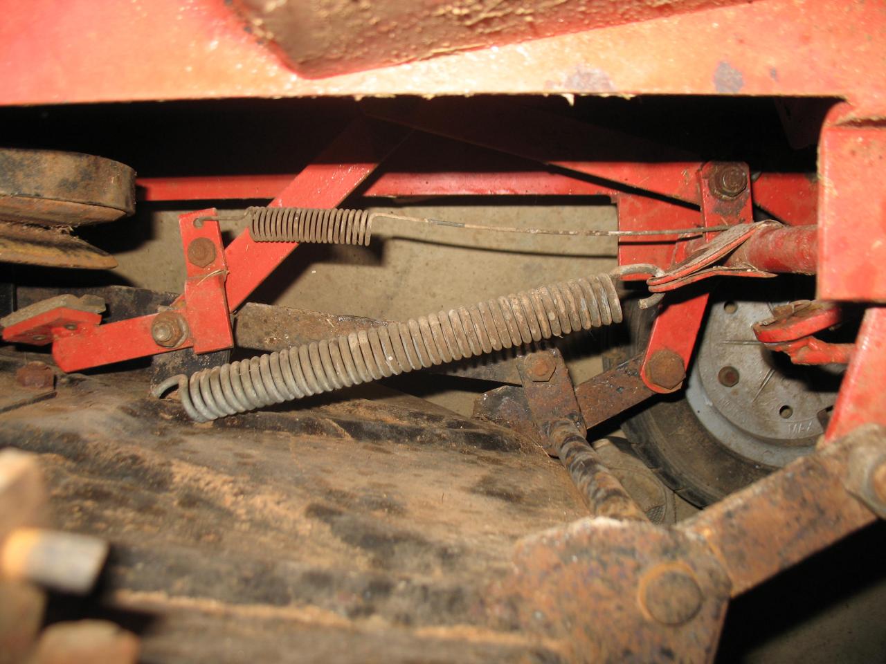

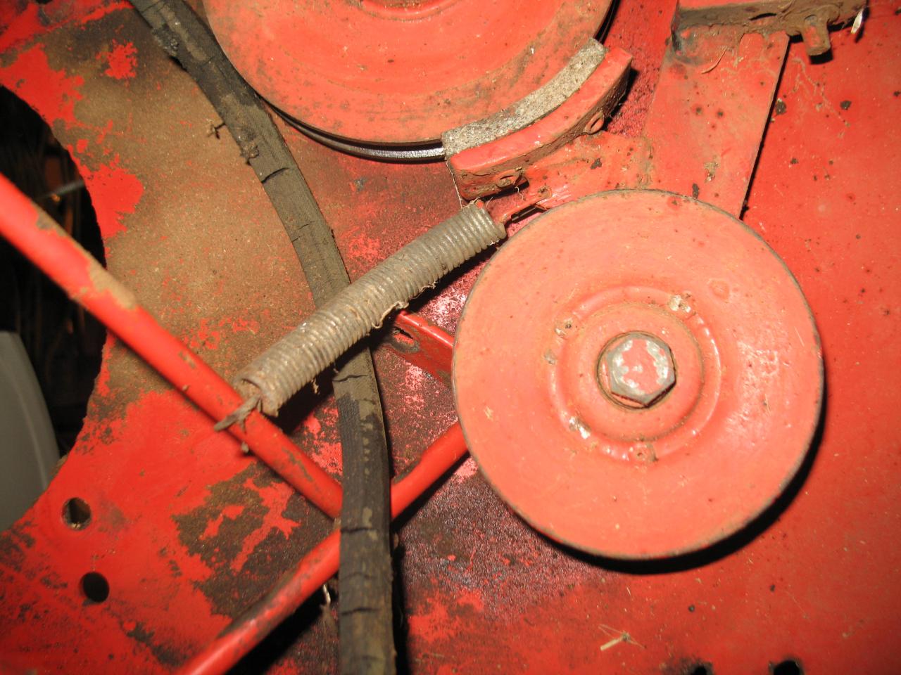

Other than the motor and colour I dont see much mechanical / design difference to the colt Major model 7319 I found on the week end. Its still on the trailer I'll flip it over in the next few days and post a pic. every thing should be there so you can compare with yours.
Joined: Jul 2010
Posts: 210
Likes: 5
See photo's shocked
Originally Posted by brisy
thanks for the reply's, yes deejay restore is on the cards ,as well as the missing brake spring also missing the deck brake spring if anyone has photos of these so i can see where they attach to i can then source a generic spring/s,
also have a b&s 12hp I/C elec start that might get transplanted just need a wiring diagram for alternator /battery and start switch wiring
I put a 12" steel rule along the deck and engagement spring to help with purchasing a new one, although now I think about it you will need the wire diameter too....(I'll get back on that)....looks about 5/64" on a magnified photo.. wink
