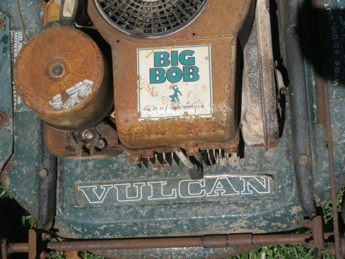

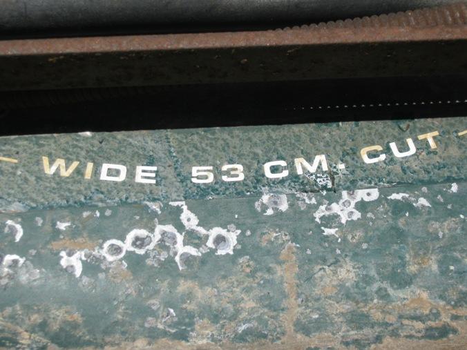

Who made/sold these mowers, it has a 53cm cutting width I would say would be hard to push through long grass
Ian
NAME
CUTTING WIDTH
NUMBERS
IanOZ #54560 23/03/14 04:07 AM
There you go Ian...kill two birds with one stone....Supa swift and Vulcan/Big Bob. Hopefully this might answer some questions. Id say Supa swift used the Vulcan name on some of its mowers as it was already an iconic australian brand..seemingly too the big bobs relability as the ad states? What do you think......Supaswift made this? Seems highly likely.

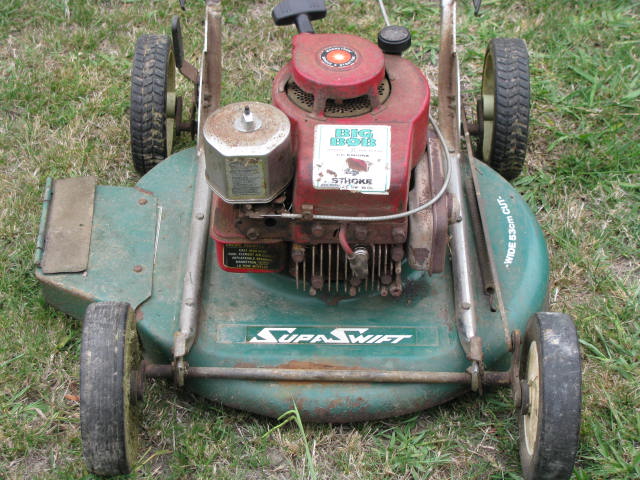

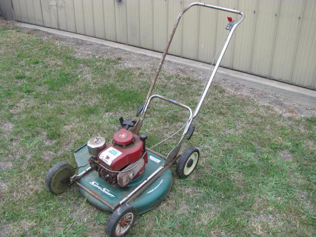

OK, here's a slightly later Big Bob [1985ish, by the engine code]. As you can imply from monaro's post above, SupaSwift made mowers under both the SupaSwift and Vulcan brands, while they were owned by Vulcan, before the Allpower takeover.
This one has been in my family since new. It's quite original, with the exception of throttle control/cable, rear wheels, flywheel screen; and it's missing its muffler heatshield [that fell off and got run over one day].
The last pic is to highlight the feature that makes this one a second generation Big Bob. Note the gusset at the upper side of the handle bracket brace - this was an attempt to spread the stress, but wasn't all that successful. If you look closely, you can see a fracture on the near side!
The opposite side failed 10 or so years ago, and I repaired it by inserting an internal sleeve, and brazing it all up. This time, I don't have oxy welding available [bloody gas bottle rental charges], so the bracket will be replaced with one from a donor mower [see next post].
These mowers certainly haven't changed much over the years - the handle redesign and discharge chute is about it, apart from a variety of engine offerings.

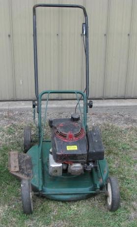

And here's a later BB, bought as a donor machine. Honda GXV120 engine, but has been 'destickered' in the course of a refurb.
Second pic is to display the 'third generation' handle bracket bracing.
These chassis very strongly resemble that used for the late model Honda Utility UT215 and UT21R models, and it wouldn't surprise me at all if SupaSwift supplied Honda MPE with chassis, and a different handle. Honda used their own blade disc and wheels, though.

Thanks, good to see there is some others out there and now I know who made it SupaSwift
Ian
IanOZ #54604 27/03/14 05:48 AM
Yep, so you can easily get SupaSwift blades etc. to fit your machine.
If you need to replace wheels, the Honda 200mm ball bearing wheels [or copies] work just fine. The big wheels make the machine quite easy to push, as it's not heavy.
The Big Bob series has certainly been through a few different companies, in its long production run.
Vulcan, Jetfast Industries/SupaSwift, and Allpower Industries, that I know of.

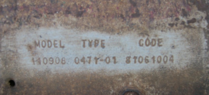

Hello, I'm new to this forum and this is my first post. I was curious about my old Vulcan mower. There's practically no information on line about my particular model so I thought I'd tack a post onto this thread to see if anyone could shed some light on its origins.
I didn't get it from a mower shop. I actually found it on a rubbish tip in Tasmania. All I could see wrong with it was a broken throttle cable. It had compression and spark so I figured I'd take it home and see if I could get it going. I fixed the throttle cable, put some fuel in it and it started easily and ran well. That was about 20 years ago and it's been keeping my grass tidy since then. My previous mower was even older.
It didn't have a catcher when I found it, but I scrounged one from another mower (also found on the tip) that looked roughly compatible, modified it a little to make it fit and it does the job OK.
The poor old thing is getting a bit tired now, and needs a squirt of Aerostart to get it going when it's cold. I don't suppose I can complain considering it cost me nothing and I've been mowing my grass with it for 20 years. And I've not exactly given it an easy life. I don't remember the last time I changed the oil. I just top it up as required. It's only ever received attention when something has gone wrong, like a clogged air filter or busted starter.
Given that it's getting s bit crotchety like myself, I've been thinking of giving it an overhaul. It kinda feels like one of the oldest members of my family because it's outlasted a wife, a couple of dogs, several cats and has now seen me into retirement. It wouldn't feel right to dump it back on the tip where I found it. But the guys in my local mower shop laughed at me when I asked whether they carry parts for it. I think they wanted to sell me a new mower.
Anyway, If anyone can give me a clue as to its specs and a source of parts in Australia, I'd be grateful.
The numbers stamped on the fan housing are:
Model 110908
Type 0471-01
Code 79041204

IanOZ #113199 06/11/21 05:50 PM
Joined: Sep 2015
Posts: 2,727
Likes: 220
SENIOR TECHNICIAN & HISTORIAN
G'day Weedgrower and welcome to the ODK forum.
This mower is a 1979 Vulcan Gold 4 mower with a Briggs and Stratton 4 Hp motor ,just a rebranded
SupaSwift mower. https://www.outdoorking-forum.com.au/forum/ubbthreads.php/topics/54245/5.html
You could dismantle the engine and try and buy new piston rings from a mower shop or online ,rings are around
$30 new or just buy another mower with a briggs and stratton motor then swap the motor over ,it's not
difficult to find a mower under $50. The motor from a Rover or Masport mower should have the
correct crankshaft length.
I haven't put rings in one of these Briggs for over 20 years as I can buy a good mower at a tip shop for $15.
Anything can be rebuilt though ,it's just a matter of cost.
