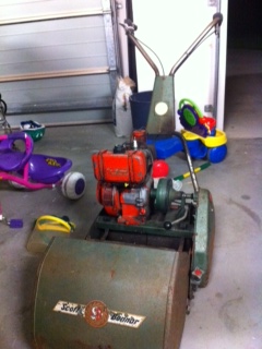

Just picked this Scott Bonnar reel mower.
Anybody know what model ( year )
Joined: Jul 2018
Posts: 2,101
Likes: 81
Looks like a bitsa.
Its got a clutch off a victa imperial or morrison or perhaps a rover thoroughbred.
Pretty sure SB didn't use villiers past the 50's so the motor wouldn't be original
My bet is a seriously changed model 33 scott bonnar, but wait for any proper experts on these to answer
