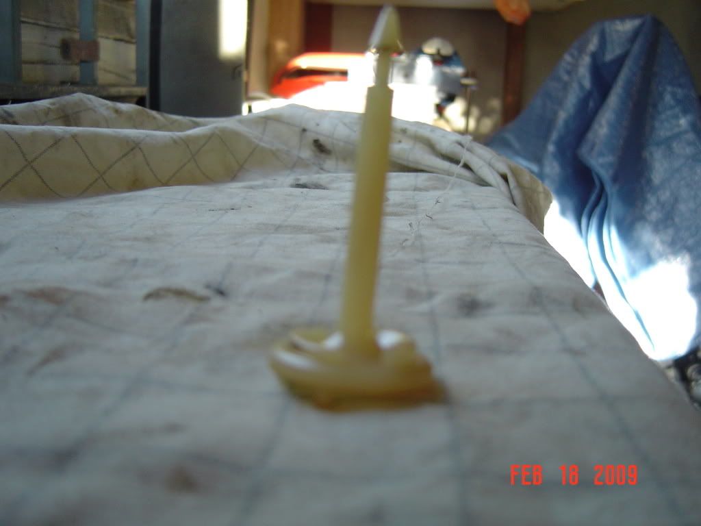

I did notice the 1983 model (carby butterfly?) did not open as far as the power torque carbys did. I was manually operating it by hand. Carby butterfly, I mean the white plastic piece with the pointy end (goes through the centre of the diaphagm) that runs through the centre of the carby.
Pic of the pointy end.

Thanks again Bruce for the info I have pieced it together and I now understand, I think. The 'primer cap spring' is actually the big diaphragm spring? I can see that if Victa had different spring rates for the diaphragm this would affect the rpm's.
The 'gov lug' is the hole in the carby diaphragm end cap that has the hose going to the engine block. I have found both my power torques was clear and open and easy to blow through, but the full crank mower did have a restrictor and only a tiny hole in it, it was also clear and working.

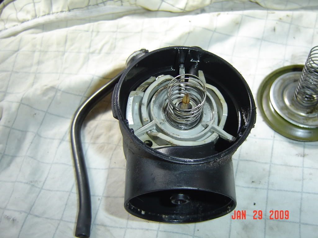

I rechecked the carby valve face and found it is not symmetrical! I needed to look closer before but did not. Here is a blury pic.
[Linked Image from i256.photobucket.com]
I have reset all my mowers to 'A' on the carby valve and found a slight lower ideling on the power torque mowers so this is good! They now are better and more user friendly. I know all my mowers had been set to 'C' on the carby valve before I had got them. I think this must be the normal setting for Power torques and maybe full crank models.
I am more happy now with these set to the 'A' postion.
