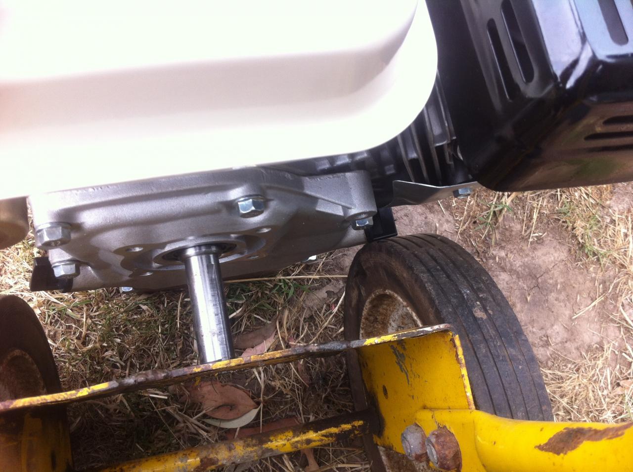

Hi Freebird,
The engine doesn't fit without the mounting plate being extended out 6" as the dipstick and the cylinder fouls the wheel.
If I made up a new mounting plate that extends out 6" from the original position, I presume this will upset the balance of the machine and will then require more weight over the tines to prevent it falling over backwards.
See the attached pictures:

Posts: 8,215
Caleb, might be easier to move the wheels forward but that may still bring up a balance issue, might have to put a counterweight over the tiller. Only other way would be to spread the wheels further apart to clear the motor but this may also bring up an issue with checking the oil

hi lrt
I think norms idea of extending the axel and moving the wheels out a bit might be worth a try.
I would move both wheels out the same amount on each side so as to not up set the balance of the machine.
a wider track would help handling with the larger engine
to change the oil you may have to pull a wheel off
i would remove both wheels and bolt the motor up then you can measure how much the wheels need to be spaced out.
i would then remove the axel and fit a longer one to suit new wheel spacing's
you will need a angle grinder and welder to remove and refit axel
the smaller ovh chonda 3hp engines are a tight fit and just clear the wheel.
its a shame you already had the 6.5 chonda and not the smaller engine but I guess you are trying to fit what your got on hand
no way would you want to pack the motor out 6 inchs a small amount if you had to for extra clearance say 10-15mm at the most
i will go through my pictures and i think i have picture of one that i converted .
i will try to post the picture for you as it will show the handle bar brace brkt that has to be made
i think you are close to getting it fitted cheers2

Thanks Norm & Freebird for your advice. Widening the axle seems like the way to go at this stage.
However, the 6.5 hp Chonda motor I have on hand will no doubt wreck the old gearbox even if I can get the machine to balance right. I'll see if the owner is happy to have the original engine restored or replace it with a new 3.5 hp Briggs & Stratton OHV.
Removing the wheel to change the oil is a great idea - sometimes the obvious isn't always apparent! Thanks for the tip.
