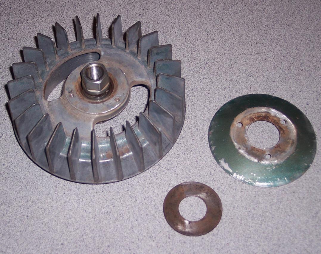

Well I didn't have three long enough correct threaded bolts to attempt pressing off the washer so I have used DJ's method using a pin punch and aligned the holes in the ally cover with the holes in the flywheel and then started tapping gently around each hole until it came off. So finally that part is over and done with and now I'll assemble it all back together and time it correctly without the cover plate and see what spark I end up with. The only thing that could now be an issue is either the condenser or the coil itself if I have no luck with it correctly set up.
I'll keep posting on this topic as I think that a few of you are quite interested in seeing this Villiers fire back up again, but once this part of the project finishes I will revert back to the "Question on 18" Supercut" thread under the "Question on Scott Bonnar Cylinder Mowers" Sub heading.
Again thanks to all for your input as this forum is simply the best for all us true enthusiasts.

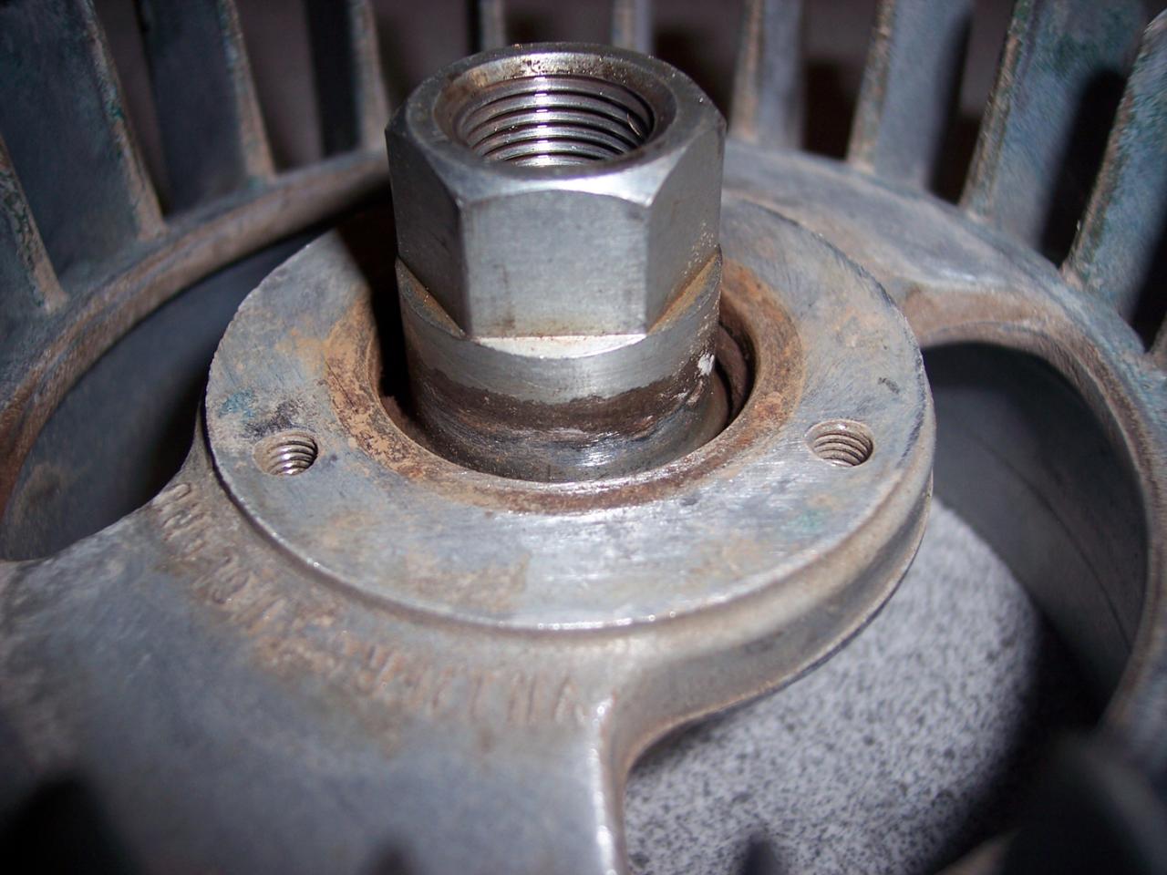

Yay! Press fit over the cam nut and the circlip underneath!...Good on ya mate! Im betting Your spark will be fine since the electrics were so corroded. Id say since you cleaned the points and flywheel/coil faces it will be nice and strong,just think positive,and cross that bridge if they are no good:). And Yeah for sure I want to here how she runs. And definately this forum is invaluable,as four contributing heads are better than ONE! smile
I'm going to pull out the internal circlip and release the imprisoned nut, but only to completely clean all the corrosion away and coat it in lubricate as if ones going to do it you might as well do it properly.
