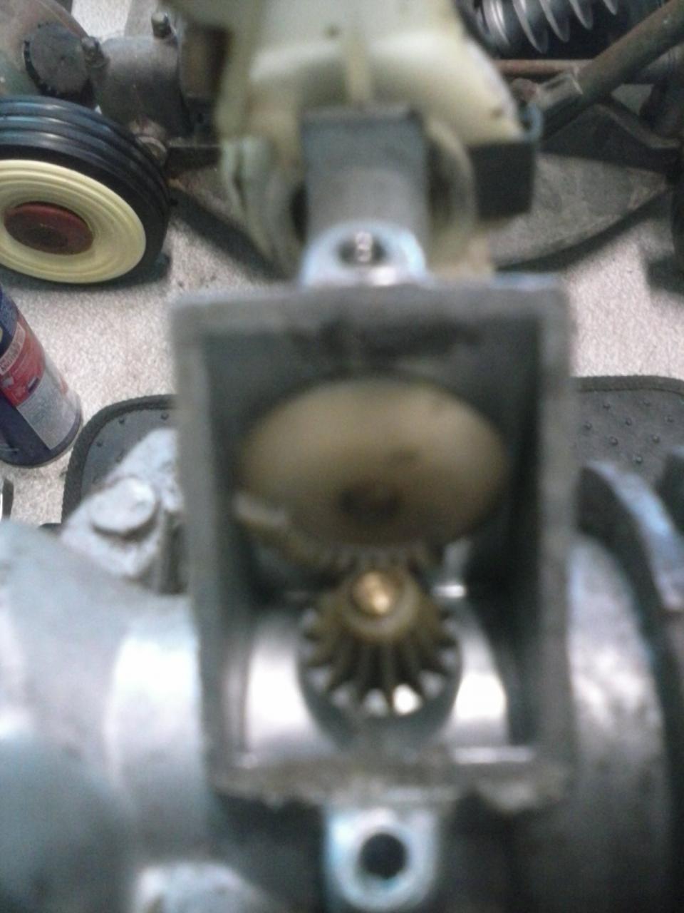

to set up the G3 carb governor remove the little cover to expose the bevel and pinion gears , hold the throttle arm and governor arm in line with the gear cover screw holes , if the gears are set correctly there should be one tooth of the beval gear visible to the right of the pinion gear.remove beval gear and adjust as needed, make sure that the butterfly is shut when adjusting the gears
