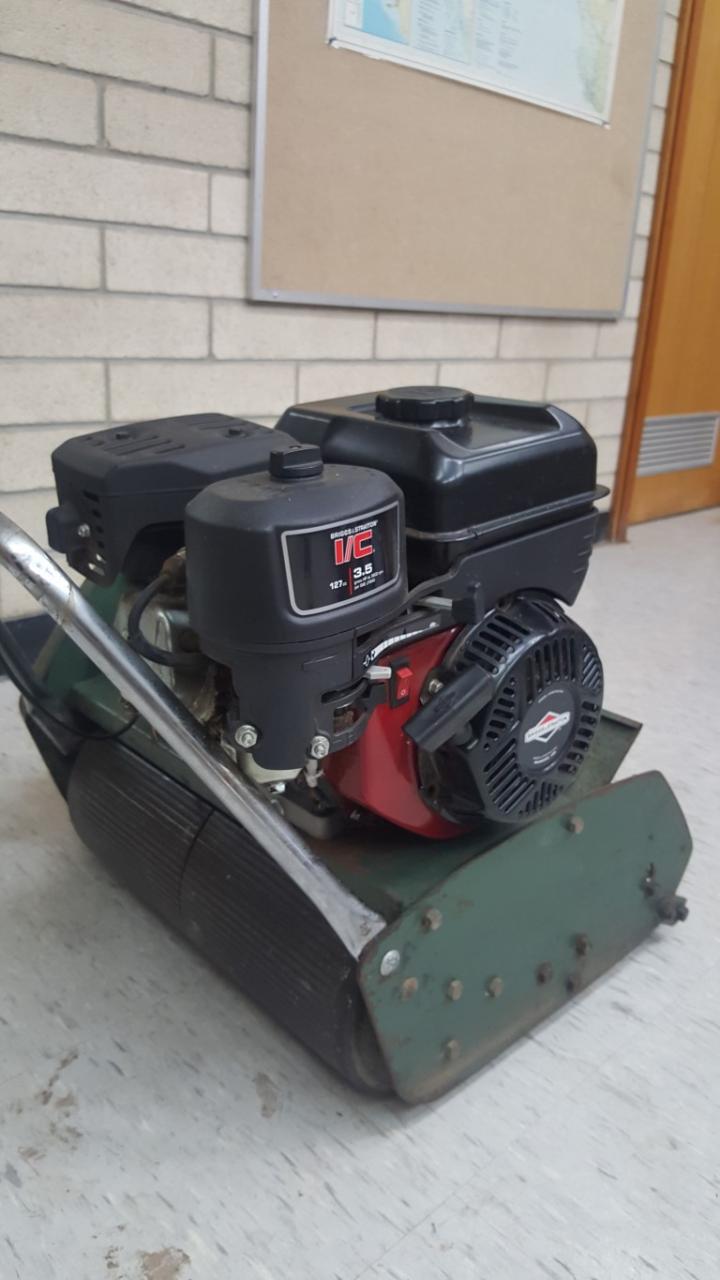

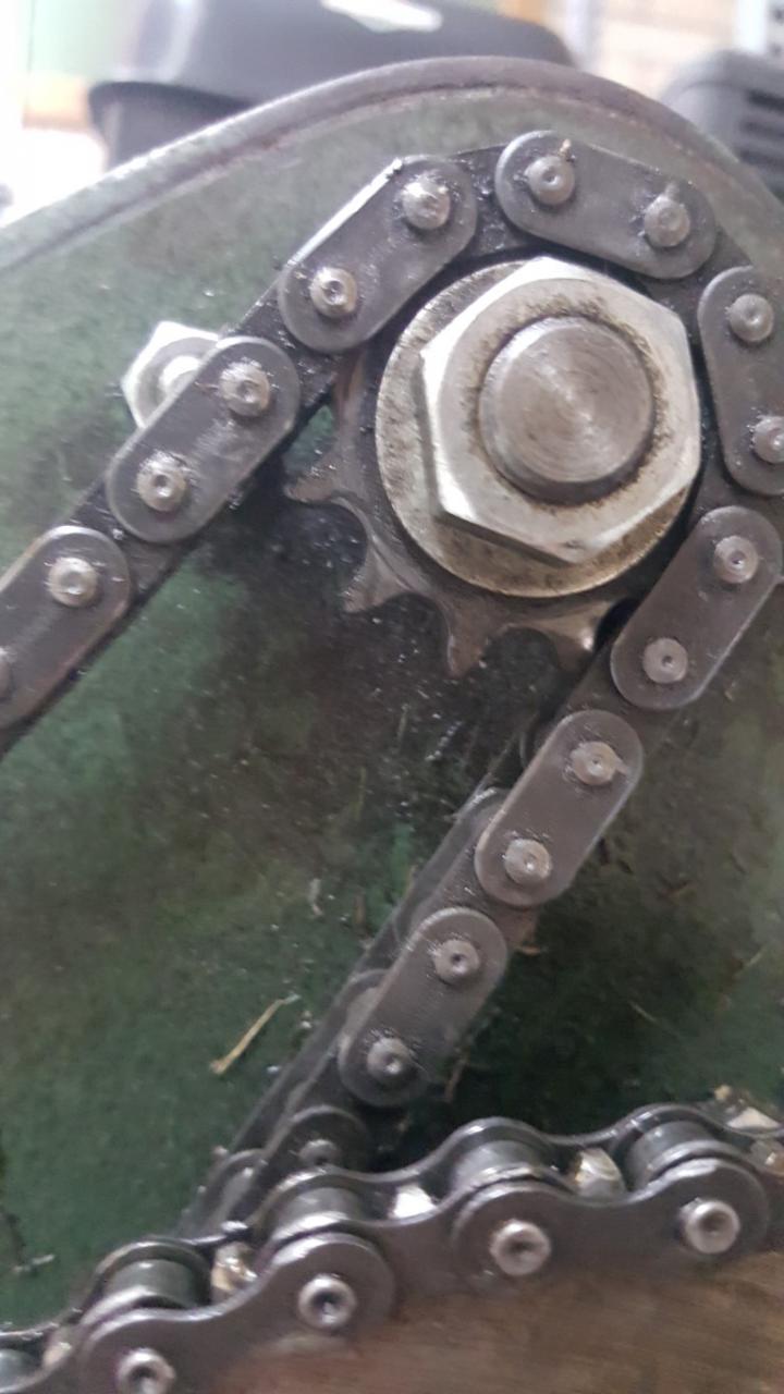

I bought this mower while I was in Adelaide over the xmas break and have been trying to learn as much as possible. I had to lift the thing into the back of my ute and fold the handles down for the trip home. It appears as though the clutch handle was depressed as the mower shifted around slightly. the cable separated at the top end and I've had to buy another which is in the post.

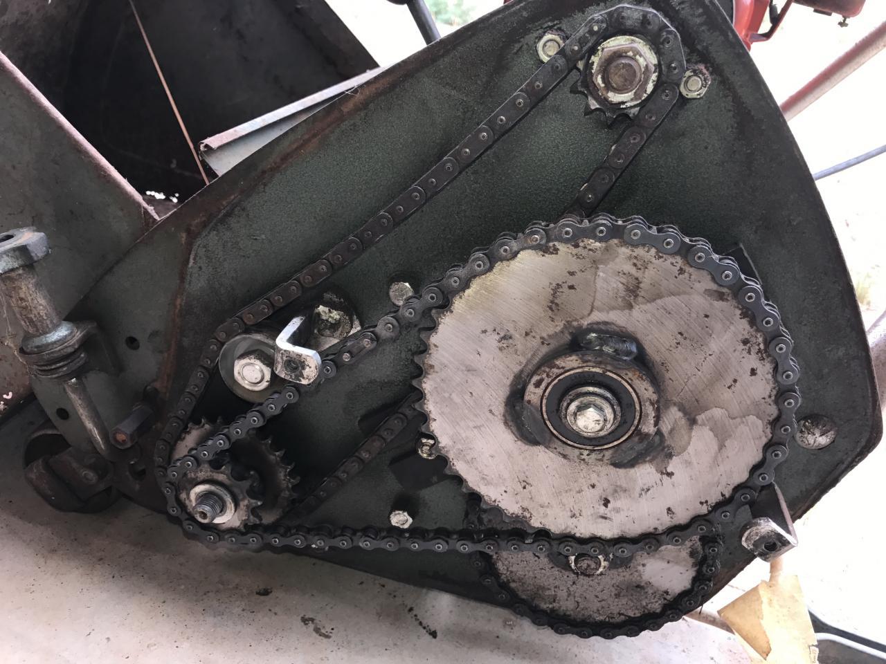

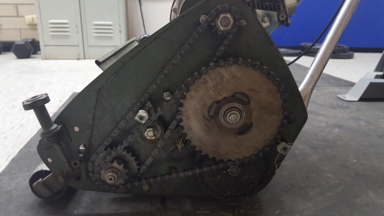

While waiting for that I decided to give it a once over before I start to use it. Chain case came off and I noticed a difference straight away from some other photos on here. It appears as though one of my chains doesn't have a guide which I have seen fitted in other photos on here. The chain is very close to touching the mount for the forward most chain case bolt.
Is this an issue to fix prior to using it? There is some wear on the roller bolt (sorry for the terminology) where it looks as though the roller/guide was once fitted in a different position.
A photo I found on the forum. Different chain set up to mine?

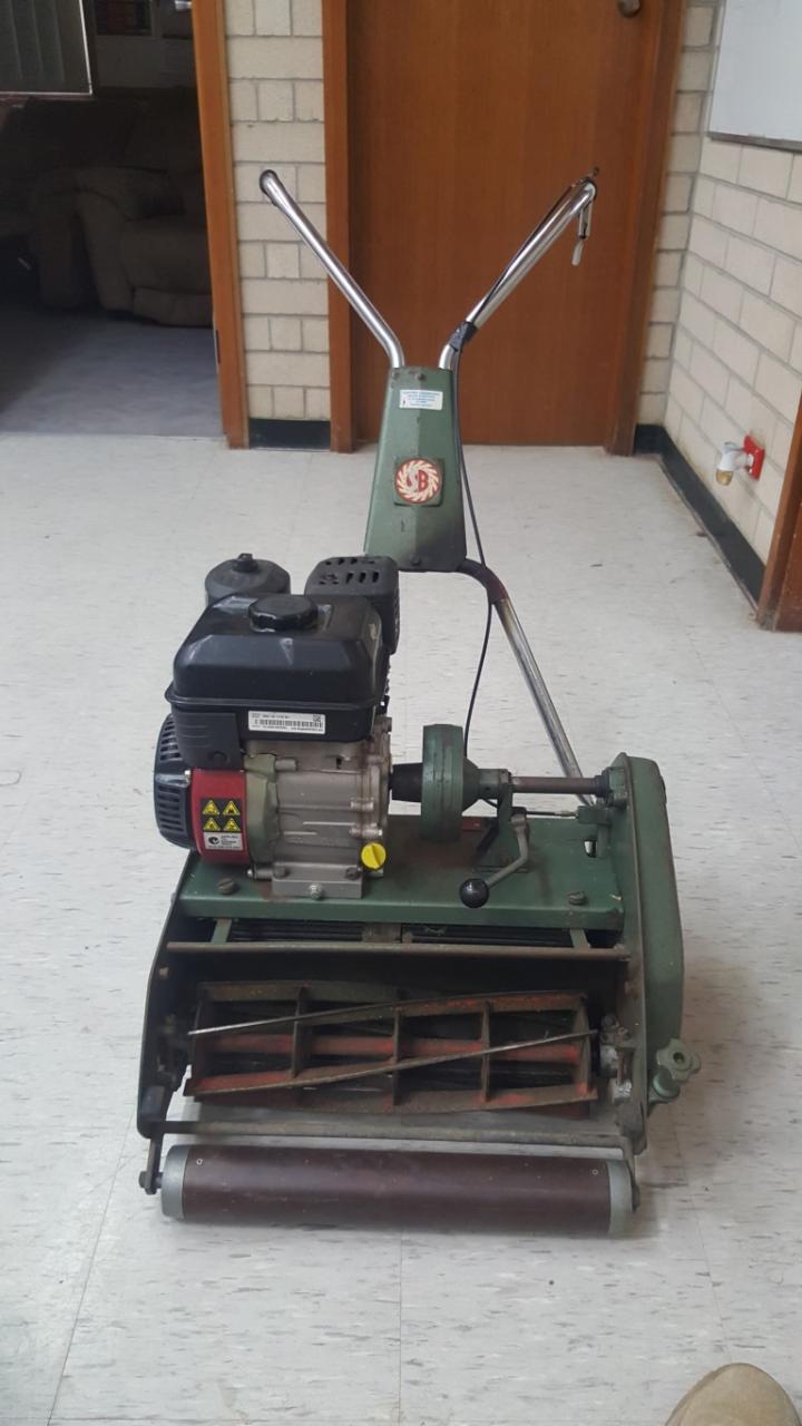

My mower
I plan to develop some skills around maintaining it and getting to know more about them before I rebuilt it with fresh paint and new parts where required.

Posted By: Bonnar_Bloke Re: Scott Bonnar 45 - Series 1 advice - 30/01/17 02:03 PM
Hi Nicko,
Great to have another SB owner aboard. :welcome:
As far as that chain is concerned it's got the wrong length one on it and also the tensioner section that is part of the front chain case mount is missing. Effectively you have no cutter chain adjustment which is bad and will prematurely wear out your cutter sprocket.
Now as far as your location is concerned you are going to find it rather hard to find any parts for any Scotty out there so someone here in Adelaide will have to source these bits on your behalf. Again also finding these sort of parts which will be found only as second hand parts on an existing machine is going to be tough as no one wants to part out these machines as it will render them useless when they can be rebuilt.
Your machine is an early solid deck series 1 and only series 1 parts will fit around that area as the series 2 machines use totally different mounting points due to them being vertical and not horizontal as yours are.
I shall hunt around and see what I might be able to find but can't promise anything.

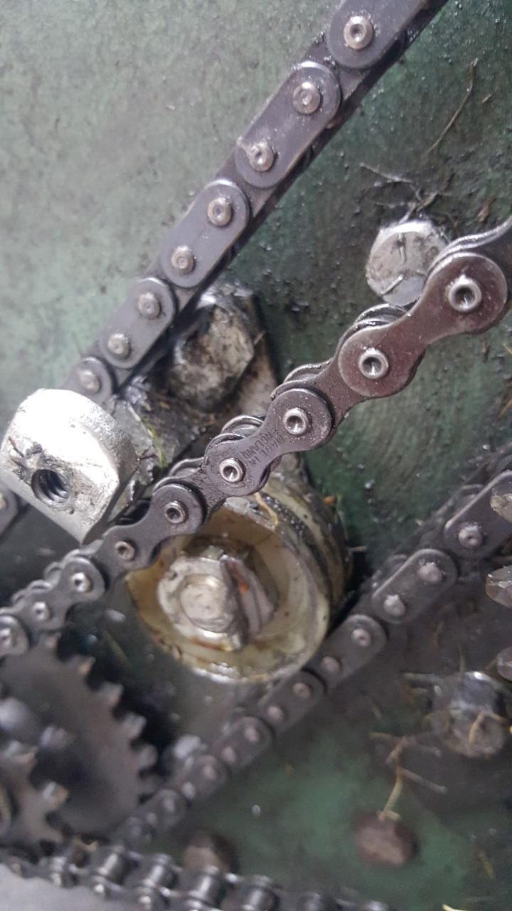

Is this the cutter chain adjuster? Looks like it has been fitted upside down compared to the other members photo I pinched. **Note the wear on the bolt**
Top sprocket starting to look a little sharp?
Posted By: Bonnar_Bloke Re: Scott Bonnar 45 - Series 1 advice - 30/01/17 03:36 PM
Hi Nicko,
Wow how silly of me to miss that. I need to up my medication.
What's actually happened is that someone has changed the chain and it wasn't long enough so they undid the nut on the engine side of the side plate and removed the assembly and then as it's got a square hole they've rotated the adjuster 90 degrees left so that it points down instead of forward.
I strongly suggest you get the correct chain and that way you will be able to use the tensioner again and have the correct adjustment on the cutter chain as that sprocket is moved further away from the top PTO sprocket as you grind the reel and bed knife as the reel then has to be adjusted downwards due to lack of metal on the reel blades thus the tensioner has to be slightly rotated down wards to accommodate the extra chain length required.

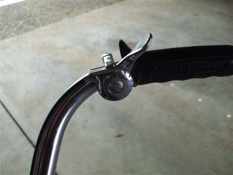

Do you know where I could source an all metal throttle handle? All seem to be plastic but I did see someone on here with a nice original looking metal one on a rover. Will look for the picture now....
**Edit: Found it. Belongs to admin Deejay
Posted By: Nicko75 Re: Scott Bonnar 45 - Series 1 advice - 31/01/17 04:22 PM
I may have answered my own question here. The chrome throttle lever appears to be from a Scott Bonnar Model 33??
Posted By: Bonnar_Bloke Re: Scott Bonnar 45 - Series 1 advice - 31/01/17 06:06 PM
Hi Nicko,
These were actually a Villiers unit but were universally available thus many mower manufacturers used them.
These were used on Scott Bonnar Reel Mower models such as the "Supercut", Model 33, Model 40, Model 45 up until around 1976ish.
